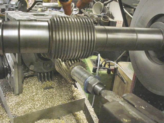

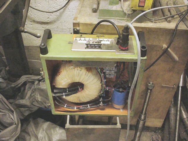

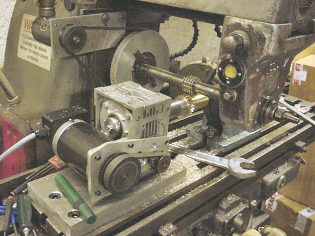

Dividing head
Box of tricks
Head angled for helical gears
Edited By JasonB on 23/11/2022 18:43:45
