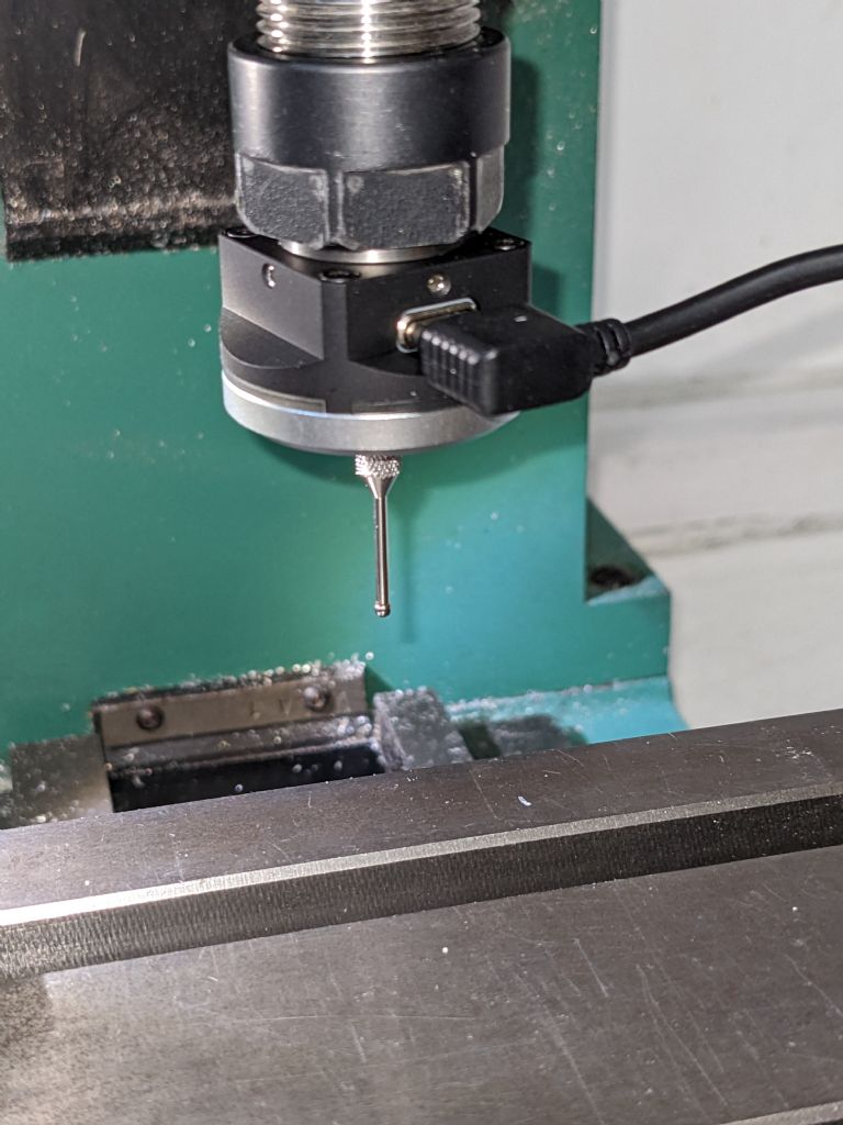

This little gadget arrived in he post this morning - a 3D probe from China. Neat little design that takes up minimal daylight, has 6mm shank. Works on the original Renishaw principle, available from several sellers on eBay and AliBaba. Prices range from ~£50 upwards, this one cost me ~£59. A few people have used them over on the mycncuk forum and found them very good.
Though I have home-made conductive edge and height finders which I use with probing routines of course they don't work on non conductive materials and the height one is really limited to tool setting.
I'll report back!

Haven't tried it yet but I'm assured that it is Mach3 compatible. Just has a NO NPN compatible output.

Ok, just lashed up for a quick trial, and it works beautifully with Mach3. Mine was set up for NO npn, i.e. expects the probe to assert a low level as if the probe was grounded. Exactly what the new probe does, so no change required. I just needed to provide a 5v supply for which I use an old phone charger.

Just needs a 5v supply. It has some cool built in green LEDs that light when powered and turn red when triggered.

But how does Mach3 or whatever you are using know when to touch the surface if the wires only go to a power supply?
Or is it more of an electronic edge finder that simply flashes red on contact with the edge
John Haine22/11/2022 21:38:21
5563 forum posts
322 photos
I was replying to Pete. There is a signal wire too for the probe input to Mach.
