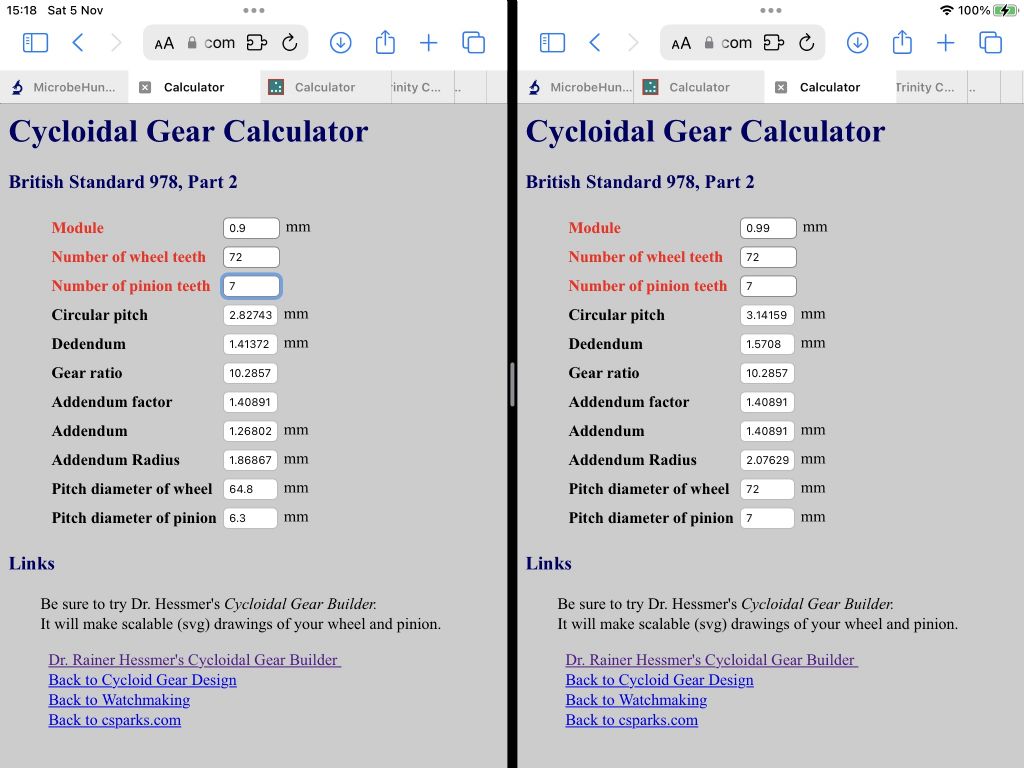

Andrew
You might find it useful to have a look here: **LINK**
https://www.csparks.com/watchmaking/CycloidalGears/CycloidCalculator.html
Obviously, you will need to run the calculator twice … once for each module
… on each occasion, ignore the irrelevant answers.
The final ‘physical’ optimisation of the mesh is [with cycloidal gearing] done by depthing.
Note [and this might prompt some debate] that I believe Involute gearing should not be so-adjusted, because it is designed to run on specific centres.

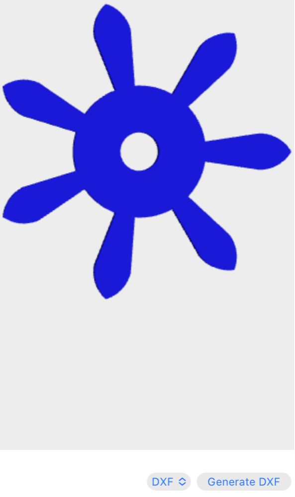

Michael Gilligan05/11/2022 06:52:32
avatar
23121 forum posts
1360 photos
I tried Dr Hessmer’s page …
it’s not really optimised for viewing on the iPad, but I did manage to grab this:
Hopefully, that looks reasonably familiar.

Michael Gilligan05/11/2022 15:30:25
avatar
23121 forum posts
1360 photos
For reasons best known to itself, the calculator that I linked falls-over with Module=1
I have therefore used Module=0.99 for the bigger cutter.
A quick check through those numbers should inform your choice of cutter, Andrew
