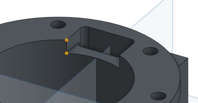

Iain, I just had a look back through your album for this engine and may have spotted something that could be hampering performance. Although shown on your drawings I could not see the clearance cuts on the cylinder cover spigot or the "bottom plates" spigot. Not having these cut into the spigots could be blocking the notch where the steam passage enters the cylinder bore and restricting the free flow of air.
Iain Downs02/11/2022 16:37:34
976 forum posts
805 photos
Thanks for taking the time to have a look, Jason
If you mean what I think you mean, there are no cuts on the covers or bottom plates. Instead the cut is in the cylinder wall.
As per the image above. I've just measured them and they are a bit uneven. They should be 5mm high (enough clearance for the piston rings on the piston) but are a bit less. One a about 4.2 and the other 3.8mm or so.
Ah!
Sorry. the penny just dropped. The inset in the cylinder cover will block the steam from the port above.
That's something I can fix and will. Many thanks
