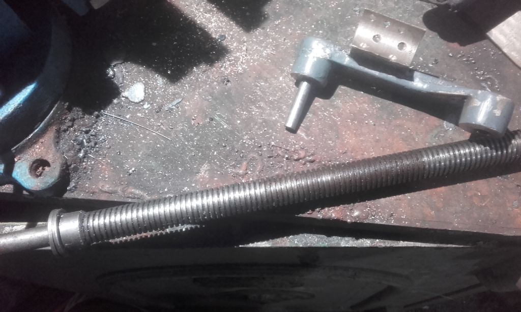

Been wanting to do this for a while because the biggest Dummond weakness is its silly leadscrew nut system. It's sort of clever, but too clever for an average bodger to sort out
So you take out your LS nut arm, it can be removed at the LS handle end with some jiggling and fiddling
This is one where I carved the remaining nut threads out for an aluminum insert, I have drilled extra 4mm holes on each side to act as lugs for the babbit pour

Then we use our secret ingredient for the mould
PINKGRIP
It didn't even smoke when I poured the babbit and it can still be peeled off 24 hours later, I left mine overnight to harden before the pour
After a few days it turns into rock hard plastic so don't leave it too long

Next up, the most important bit
Wait for the missus to go out because you need the kitchen gas cooker
This is the foundry, a dessert spoon, a stirring rod of steel, thick gloves and a pair of glasses
Put the LSarm into one of those cheap modeller vices, a tenner from Lidl, and balance the leadscrew into the pour zone
Use the steel stick to remove/push away impurities so you have a nice molten silver spoonful to pour
Then go for it!

Let it cool then gently tap the LS arm free
That is a jar of pinkgrip squirted out of the tube and kept in a jamjar

Got to tidy it up later and try fitting it back in
It's my first ever pour and things could be better but the basics seem to be sound so far

VERY GOOD ! Better detail may have been possible with the lead screw warmed up a bit . making a closed mold and then feeding with a runner would also help to get better detail due to the head pressure. Never the less your method is quick and simple ! Noel.

Improvements might be to not machine through the metal base - divots would retain it adequately. Tinning the surface would also provide far more adhesion to the casting. They wear so slowly that it may well last years, but raising the thread from the casting would allow a thicker bearing depth and subsequent longer life - if the individual threads become separated and are not too well affixed (to the base metal) they could peel.
Not criticising - just making suggestions for improvements next time.

Fitted it this PM and it's great, so that's a headache problem solved forever
