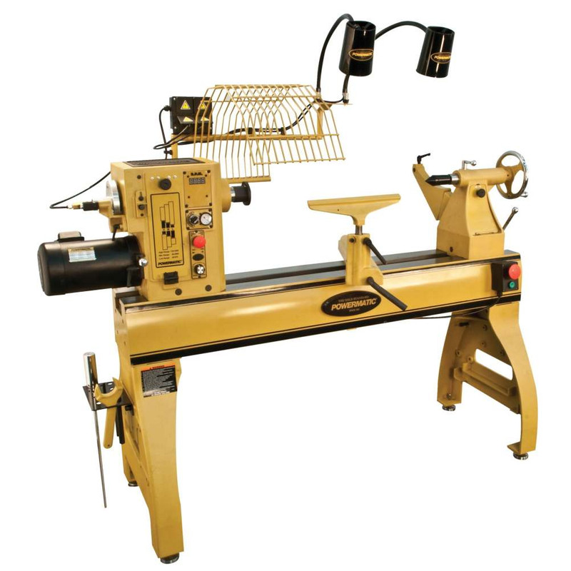

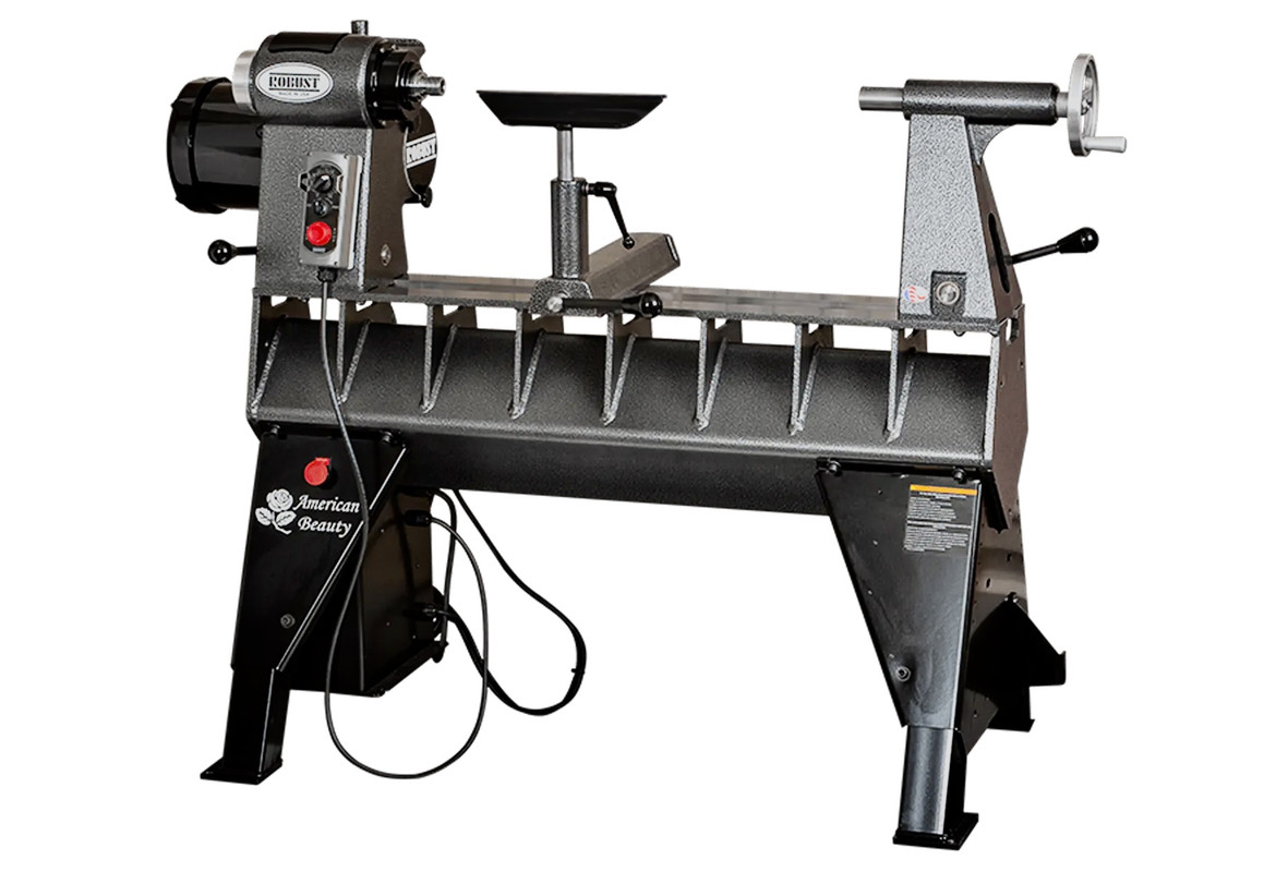

I turn some of the soft brown stuff from time to time so I invariably see adverts and pictures etc of associated machinery. Whilst the majority of wood turning lathes still have cast iron beds, and often legs, there are a couple of manufacturers that use welded steel. I’ve read before about how good cast iron is at vibration damping so I guess maybe the choice of welded steel is down to cost? The only problem with that theory is I’m not sure they’re any cheaper. What do folks think?
Cast Iron.
Welded Steel.

I have an old noname wood lathe made from folded sheet metal with internal braces. I use it very rarely but dont seem to get much vibration. Go for CI if you can though as it is supposedly better at damping than MS. As for cost it is entirely down to the size of your pockets.
