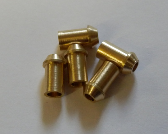

could any one help me out , i have just bought a 0-80 psi 1 inch dia pressure gauge with 2.36mm dia nipple end with 1.62 mm dia bore , how do you attach 1/8 inch dia copper pipe to this

You need a gauge adapter….got a foto of the gauge connection?

Sounds like you may have one to suit 3/32" (2.34mm) pipe, you would be best changing it or else make a custom nipple and nut to suit or reduce the pipe from 1/8 to 3/32 before the gauge.

Does the thread really come into it, OP has said it has a nipple which is simply the wrong size. Picture of some nipples for those that have had a sheltered life. These are sized to suit the OD of the tube
