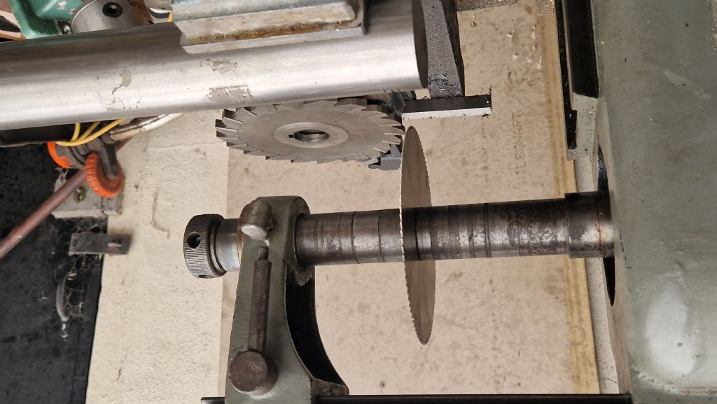

Hello,
I am very much an amateur who seems out of their depth!
I have recently renovated an old Mill, and when I tried to use it on steel, I can't seem to get anywhere.
I tried with a inch block of brass, and it cut through fine. I tried a 3 inch piece of chemiwood and again it worked fine. But, when I tried EN3....I get an awful noise, and the cutter jams.
I have tried all the speeds, I have tried the cutter going clockwise and anti-clockwise, I have tried a 6inch slitting saw, a more substantial 4 inch cutter...
At one point I was getting sparks out!!
The machine itself seems in good order, I measured the bed to the arbour, and it seems to be parallel.
Its an Ajax AJ8, so I assumed could go up to an 8 inch slitting saw, but if it struggles with a 6 inch saw and a 4 inch cutter. What sizes should I be thinking about?
Any suggestions welcome. The cutters are second hand, but seem sharp, so I don't want to be a bad workman blaming his tools. But my head is getting raw with the scratching going on.

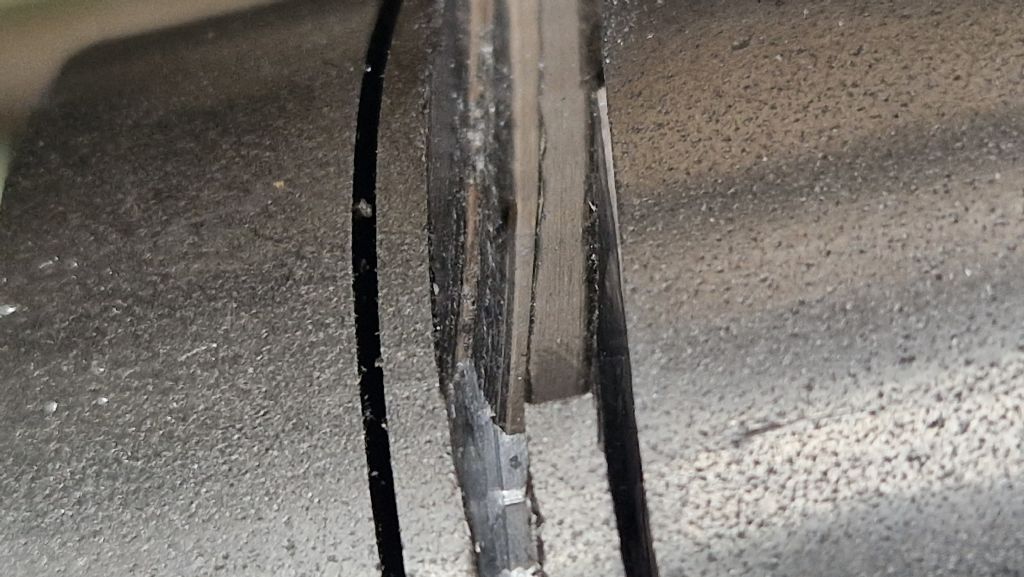

Photos attached are of the set up and a close up of the 'results' of the 4 inch cutter, note the 'stepped' appearance where the cutter jammed.
Nothing works.
PS sorry for the upside down photo...It appears normal in my gallery..but is inverted by the Forum..Even if I load it rotated 180deg...But its a fairly self explanatory.
Many thanks,
Nicholas

Hi, there are a number of reasons that you can’t get a good cut. First some steel is almost impossible to machine due to its hardness. I purchased some mild steel rod off eBay and no way could I machine that material no matter what lathe tool, speed depth of cut. Nothing would work in my arsenal of tools. Try cutting your material with an hacksaw and see how it cuts. If it cuts ok then you need to look at the machines set up. You say that you have tried all the speeds and feeds. Rotation should be counter clockwise, check that your cutter is correct for this. Start by using shallow cuts, try using cutting fluid. From what I can make out from the lower picture it looks like your cutter is digging in, so rotation is wrong. Feed the work left to right. Hope it helps a bit

What speed did you initially try cutting the steel at and what diameter was the cutter. Of secondary imprtance whet depth of cut, feedrate and number of teeth are on the cutter
A 4" HSS cutter should be running at approx 100rpm, if you have exceeded that by any significant amount then you may well have blunted the cutter
If you ran the cutter backwards (anticlockwise) as opposed to climb cutting then that will also blunt it quickly

It is likely to struggle with steel - especially if using 4” diameter cutters.
I note the lowest speed might be 150rpm (some are 120rpm) unless using carbide cutters.  Both these speeds are quite high for a low powered machine. What power motor is fitted?
If multiple teeth, the feed rate is likely too much for the power, with a reasonable cut per tooth. Or the cut may be so shallow that the cutter will rub and go blunt.
The same applies for slitting saws as they do not like high speeds with hard, tough materials.
On top of all this, if you are hand-feeding, the problems are likely exacerbated unless you have a very steady hand.
Good luck with your mill. If it is a single phase motor, i might suggest either changing the motor pulley to reduce the cutter speed or if three phase wire it to delta and use a VFD. If changing the motor to three phase, then some increase in motor power could be envisaged.

Having now turned the first photo up the right way it looks from the saw cuts in the bar that you were climb cutting not something that you should be doing with a slitting saw
If viewed from the front of the machine it looks like you have the blade set for anticlockwise rotation. if this is so then you should start with the workpiece on the right and move it left into the blade so it contacts the rising teeth
The saw is also far too fine to use for cutting off that large diameter bar as the gullets between the teeth will clog, cause overheating and jamming of the blade as well as make it wander.
Clicking this image should show the climb milling set up a bit larger

With the cutter arranged as in the photo, the spindle should be rotating ant-clockwise, and the table should be fed from right to left, i.e. against the cutter rotation. This is conventional milling.
If the table is fed from left to right, you are climb milling. This will tend to draw the work into the cutter, with the cutter trying to climb over it, hence the name. To climb mill you need a very rigid machine with minimal backlash in feedscrew and nut. It has advantages, but best avoided until you have more experience.
Have you tried using the side and face cutter in the background? These are far less fragile and demanding than slitting saws. Try taking a light cut with it, say about 0.25mm, at the slowest spindle speed available, and see how you get on. If you get nasty graunching noises check that the table slides are correctly adjusted, and the unused ones are locked. If all goes well, try deeper cuts.

With the fine tooth slitting saw you show the gullets will almost imidiately fill and then clog up causing heating and jamming of the saw in the cut (even if you have everything else right, direction of rotation, feed rate, etc.) use a coarse tooth slitting saw, slow rotation, plenty of cutting oil and moderate depth of cut. and don't cllimb mill.

I prefer to use slitting saws on my horizontal mill. On the vertical mill (with stub arbor) they tend to go walkies on deep cuts. On the vertical mill I limit cuts to shallow slotting, usually one pass. On the horizontal I am happy to take deep cuts, more than 25mm, normally in 5mm steps.
As mentioned above for deep cuts, as opposed to things like screwhead slots, coarse teeth cutters are needed. In this picture all the slitting saws are coarse, except for bottom right:
