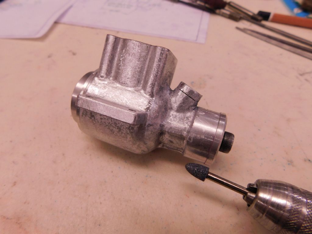

Ramon Wilson13/08/2022 22:49:18
avatar
1655 forum posts
617 photos

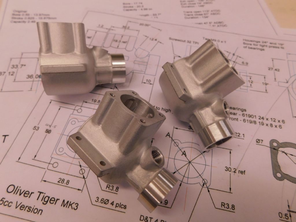

I used a mounted stone point at slow speed to achieve the effect on this aluminium crankcase
It could be painted over I guess but I chose to bead blast it to achieve the kind of impression of the original I was hoping for. This was not a casting but machined from solid but the effect would be similar.

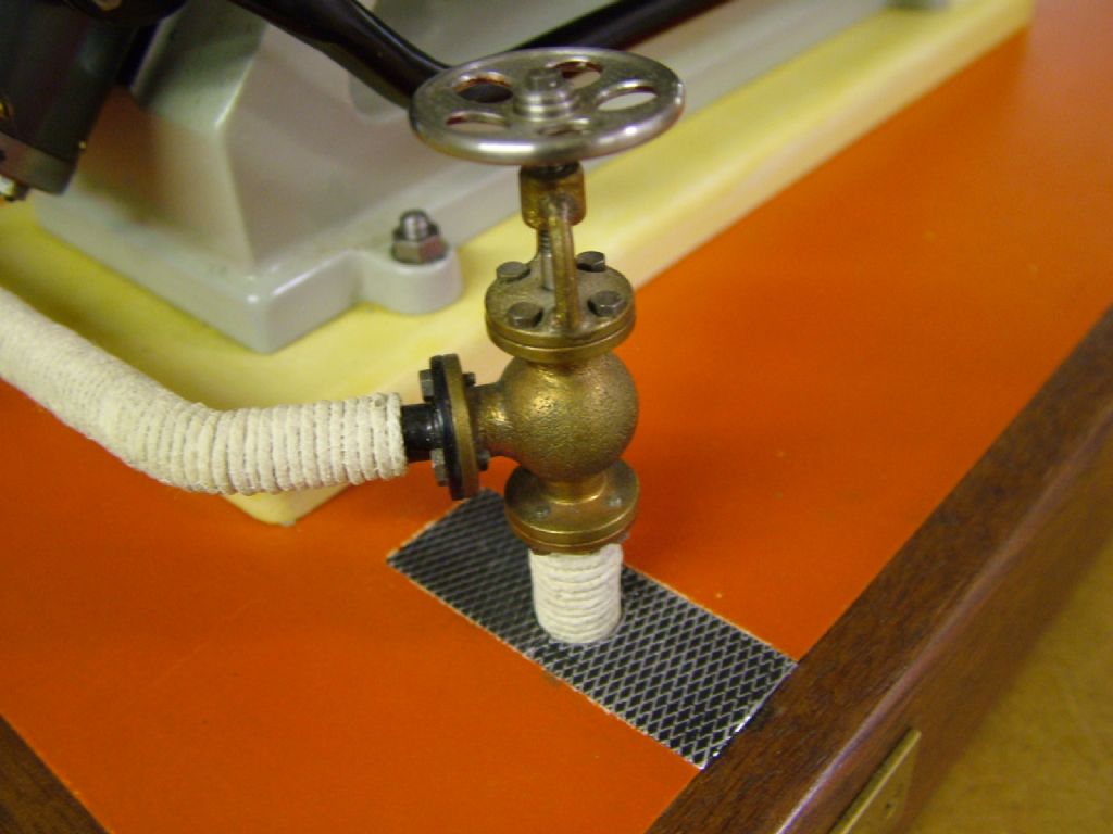

I have also used an engraver to dimple the surface of bronze to give a cast impression
The tool needs to be blunt, not a sharp point for the best effect. Here's another example on a home made valve body.
Hope that's of use - Tug

JasonB14/08/2022 06:55:40
avatar
25215 forum posts
3105 photos
1 articles
Interesting to compare the "cast" valve with the painted casting behind in Ramon's last photo. Can't quite remember the scale of his diagonal engine maybe 1/12th but once painted it's effectively smooth and I would assume you want to paint the traction engine model.
