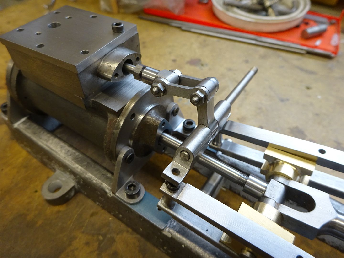

And the first Steam parts. After a long lay off, the James Coombes is back from under the bench and back on it.
Schoolboy error - the long rods are 1/8th thick and the short links are meant to be 1/4 inch thick. Nesting them together in 1/8th material wasn't the smartest thing I did yesterday...
I didn't cut through the material and rely on tabs, but left 5 thou to hold all the components together. I did have some tabs, but wherever the machine cut a tab, I got a machining mark in the side of the part, I still trying to work that one out. I can't see where the cutter (3mm Titain coated carbide) deflection came from to blemish the part.
Also used a slitting saw in the Warco mill, so getting all the skills warmed up

It's often as the tool goes downwards at the end of the tab that the cut changes from the side to end cutting which causes the tool to deflect. You can reduce it by altering the tabs from straight sides to ramping up and down. Also set a final finish cut at full depth and set the others 0.1-0.2mm from the final profile.
Parts like that I would tend to drill the holes first in smaller stock. Then put a bit of scrap aluminium into the CNC vice and have the machine drill two holes that can then be hand tapped. Screw the work to this block and use an adaptive cut at full depth leaving 0.3mm axial stock. Then do a contour again at full depth with 0.2 roughing and final 0.1mm pass Saves getting marks at the tabs and no material to file off where the tabs are or depth is not full height

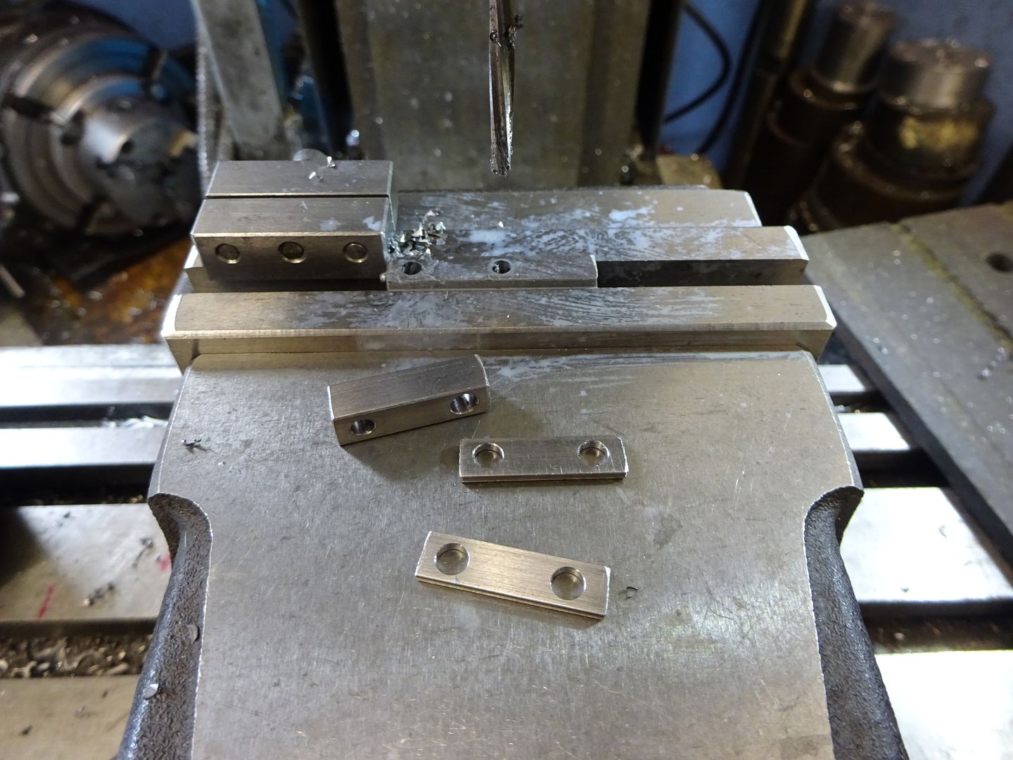

I managed to get the short links drawn up for my version of the James Coombes so had a go at cutting them firstly with adaptive and then with the contour as though cutting out of a larger sheet.
These are the links, two at 6mm thick and one at 5mm thick as I'm making mine in metric. They are all reamed to fit on a 4mm dia shaft and have reamed 3mm holes at the other end for pivot pins. Ends are 7mm & 6mm dia respectively with a 4mm wide central waist and holes are at 14mm ctrs, Internal fillet radius was set at 3.25mm so a 6mm cutter would not end up with too much engagement angle.

I tend to find flat bar nicer to machine than sheet/plate so picked up a bit of 1" x 1/4" probably EN3 and held it in the manual mills vice to drill and ream the six holes on a simple pattern located with the DRO, could have used the CNC but not much in it time wise. Holes were spotted as I wanted good accuracy, then drilled with 2.8 & 3.8mm stub drills and finally reamed. Having it in the vice like this with no tooling plate below allowed the 3mm hand reamer to pass right through, not such an issue for the 4mm machine reamer - both run in the spindle.
A couple of quick passes with a 10mm HSS cutter had the 1/4" material reduced to 5mm and 6mm as needed.
Then over to the Femi to chop the bits off the bar
The KX3 was fired up and a bit of scrap aluminium held in the vice. Sometimes I just use the jog to drill these mounting holes but on this occasion used the CNC picking up the hole locations from the same F360 file and tapped the holes by hand. First hole had X&Y set as 0,0 which matched the larger hole position on the work which I had set as datum
One of the 6mm pieces was screwed on and the start button pressed. and quickly completed. Swapping it over for the 5mm thick one the job took a lot longer, I could probably have had a steeper ramp angle that would have reduced the time a bit. At just before six mins you can see the final full height pass starts.
Final parts feel burr free which is not bad as the cutter has done quite a bit of work and no difference in finish between the two options that I can see but I'll be sticking with the first adaptive option as it gets the job done and I'm not just putting a lot of wear on that first 0.6mm of the cutters flutes. All cuts were climb cutting.
