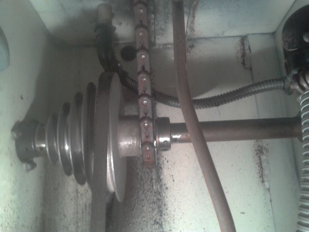

Can the original counter shaft arrangement be mounted underneath?
Nicholas Farr26/07/2022 07:03:21
avatar
3988 forum posts
1799 photos
Hi Rich2502, you can have the countershaft wherever you like as long as the belt will allow. My Boxford underdrive has the countershaft in the cabinet directly below the lathe, but of course the lathe and cabinet was designed that way.
