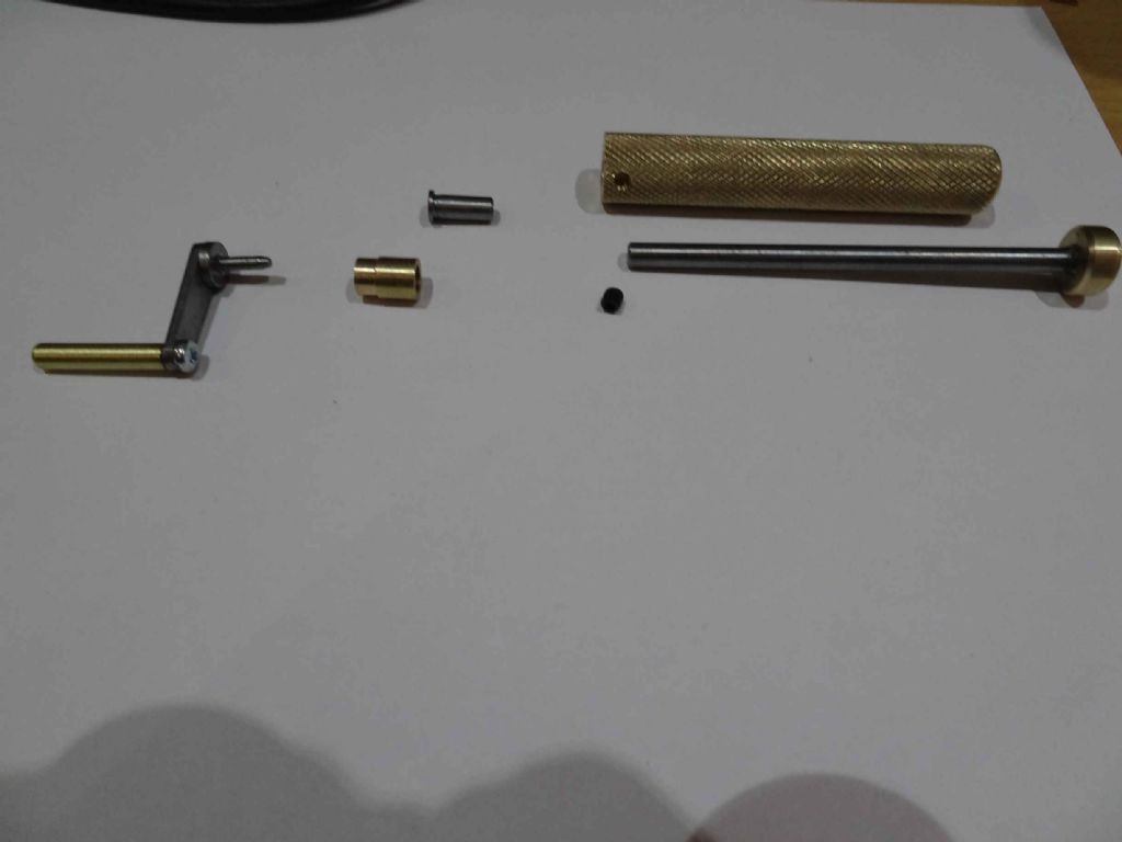

Below is the main spring winder. For those who don't know of this instrument of torture, it winds the spring into a cylinder that's just a tad smaller in external diameter than the internal diameter of the mainspring barrel.
Here is the spring loaded on the arbor. It then gets put into the barrel at the end of the handle (you have to have different barrels and arbors for different watch sizes). Wind the spring in through in through the gap in the barrel..
see the mainspring barrel just to the right of the spring. It's about 7mm across and 1.3mm deep.
once the arbor is removed you put the tool end into the mainspring barrel and eject it with the rod that goes through the middle.
