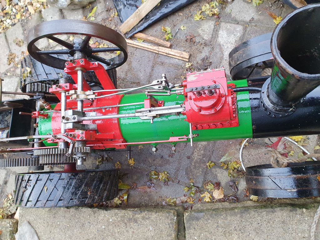

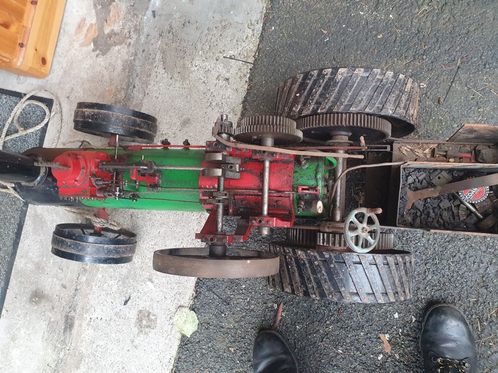

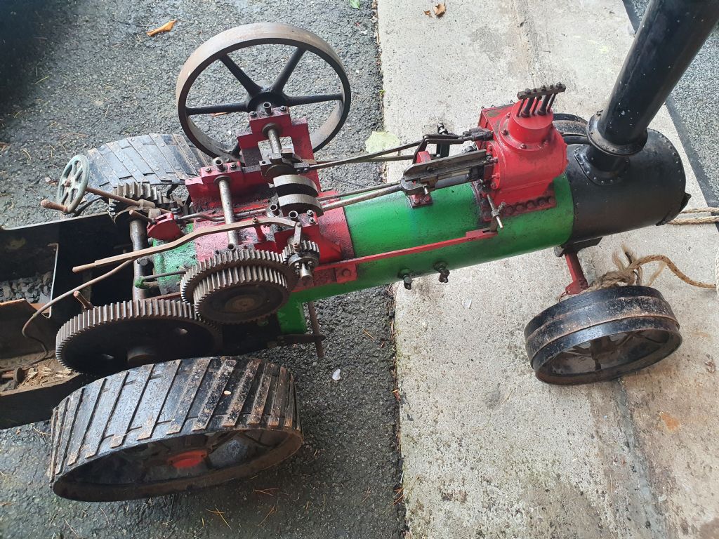

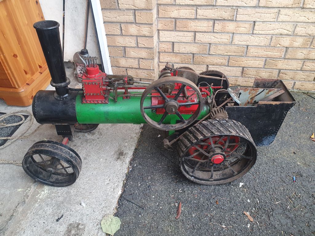

f4.jpgf3.jpgf2.jpgThank you for the replies.
I have manged to find out how to add pictures
Here is the 2" Fowler and 1 picture after giving it a clean.

looks to be more of a very basic free lance design than anything Fowler and no sign of any ploughing gear or drum

Apart from a bit of missing plumbing to get water into the boiler via the two clack valves on the side of the boiler and the pump and injector there does not look to be much missing to get a basic running engine. Steering also needs looking at. I have my doubts as to whether it could be converted to a ploughing engine for several reasons.
However before you invest any time and money into it get the club inspector to look over that steel boiler, at 60 years old and no way of telling what use it has had or how it has been stored it may not be safe to use.

Have a look at this engine in Station Road Steam's archive, the builder of yours may have once seen onewink
He was certainly thinking of an early Fowler Ploughing engine like the K5 shown as the drive gear layout and cylinder are of the same general layout and it has the double tee ring front wheels often seen on a ploughing engine. The offset flywheel side crankshaft bearing bracket suggests there were thoughts to add a bevel gear to drive a shaft down to the cable drum but none of that has been done.

The raised sides of the hornplates are missing, which may mean it is not the Haining design and someone was freelancing an earlier wrought iron engine with the cradle for the crankshaft.
The cylinder is looking for it's missing coffee pot cover and only Fowler used them, It also has the Oxford rebuild style safeties and smokebox + no Church valve.
The rear wheels are built Superba style in three pieces.
For drawings the bigger Haining Class V 16nhp will be close enough with care, as serialised in ME during 82 to 83, you rarely see the proper A3 drawings, but these are identical to the ones in ME. The K5 is a much smaller 6 to 8nhp engine though it does have the correct straight flywheel.

 Hi Alexander, Your engine appears to be a standard traction engine as it does not have a winch.

I mentioned earliad my doubts if it could be made into a plough, these are some of the reasons why
To me it looks like the smokebox on Alex's engine is the wrong way round, of the ploughing engines with long smokeboxes the perch bracket should be towards the front which puts the axle forwards giving room for the drum. Is it really only held on with 4 fixings?
The lack of hornplates and any sign of bracketry for the ploughing shaft and drum pivot will mean that welding the last two and suitable strengthening plates to the boiler will be required which would likely need a coded welder or a very capable person and weld tests.
Also well as some way to get a central bearing onto the spindly looking crankshaft. Then there is the issue of how to support the winch controls with no hornplates. Side load on the bevel and lack of specticle plates or meaty enough bearing supports would mean you could not really pull anything even if you got a drum fitted, thats if the low spoke count wheels did not fold first.

Just noticed that the bevel gears are hiding in the tender along with a spare / knackered piston and all the coal.
There's more than one builder been involved, the last one doubling up a Minnie crank, bolting on the smokebox and chucking a fire in it.
