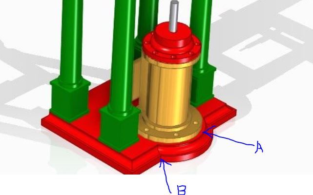

This thread is about how 3D CAD helps designers spot errors as a design develops. It's founded on JasonB's build thread, which is inspired by the Stuart Turner Real Engine, based on a full-size type.
Learning Solid Edge, I was looking for an advanced Assembly exercise in which I develop an entire engine from a photograph only.  The goal to create engineering drawings from an idea of the layout without the dimensions needed to build a working model. Jason often does this, and I can work from his latest .
In CAD Jason's Real Engine looks like this::
And my unfinished blinged-up clone in SolidEdge:
Not bad, but CAD helps spot important errors:
A - eccentric can't connect to the slide-valve (when it's added). Easy fix
B - Flywheel is on the wrong way round and hits the frame. Easy fix.
C - Base is foreshortened so the piston can't connect to the crank via the conrod. Fixing it is a good test of the CAD package: can I just slide the front of the base and the cylinder without disturbing the pillars and complicated headstock? Fingers crossed, I think it's easy.
A serious flaw in the cylinder:
Here, one of the 8 PCD stud-holes, circled D, is too close to the steam port. All 8 holes need to be rotated to provide clearance.
I need a dimensioned Third Angle Plans to fabricate parts in my manual workshop, no castings. CAD generates the plans, and the operator adds dimensions and other annotations as necessary by clicking.
The cylinder example reveals another glitch - the dimensions highlight the chance to use standard stock sizes has been missed! Reducing the amount of unnecessary machining and swarf.is always worthwhile.
Makes me appreciate Jason's efforts even more!

The eccentric won't be such an easy fix as when you move the cylinder further out the valve chest will move too and then you find the eccentric rod hits the entablature. Took quite a while playing about altering parts and then looking at the assembly as it updated to get something I was happy with.
You will probably also need a 5 stud bottom cylinder cover fixing as your nuts will be close to the passages. Yes it's a separate part so you can bore the cylinder right through not blind as you have it

A few improvements: the pillars weren't long enough to accommodate the piston stroke, so I lengthened it by eye. Jason's point about the tight corner is corrected, sort of, Added a conrod, and made a start on the guide slide, and connected the piston. Also moved the eccentric along the shaft - didn't dare look to see if it fouls the top, I think Jason is right, it will.
The concentric constraint between cylinder and base isn't missing - optical illusion. the garish colours don't help!

After dinner and beer, I found the duff constraint and fixed it allowing the flywheel, crank and piston do move together. Problem: the piston hits the bottom of the cylinder just before bottom dead centre, crunch:
I can turn off the cylinder to show the piston has about 4mm clearance at top dead centre:
Suggests shortening the conrod by 4mm will allow the piston to run full travel inside the cylinder without hitting the ends. Hope so because the other options are more complicated - changing the cylinder length, crank throw etc.

Well, 3 steps forward, 2 back. The reason the model wouldn't sit straight on screen was I must have accidentally rotated the base off the top plane at some point, don't know how - some sort of 3D earthquake.
Added guide rails, valve box, connected the eccentric and dropped the psychedelic colour scheme.
Another huge fight with relationship constraints today, I think because I don't understand them properly.
Despite bugs the model nearly rotates properly, except the axle jumps out of the bearing blocks unless the flywheel is turned dead slow. I believe the model's parts jumping out of position is caused by setting one or more relationships incorrectly and/or by an interference.
Jason was right about the eccentric not aligning with the valve box, it's about 7mm out. For the time being I've fixed the error with a bent strap.
Still lots of flaws in the engine and my CAD technique.

Good news, producing Section Views with Solid Edge isn't too difficult, especially from a simple plane:
Shows a couple of potential build problems. The red ringed steam inlet hole is close to breaking through into the cylinder and the two vertical steam ways are dangerously close to breaking into the exhaust passage, The holes are drawn with flat ends, real ones would be made with 118 degree tipped twist drills, and the deep holes might wander too.
The entry points at the rear into the belt look a tad awkward to get at:
And I don't like the square edged steam-ports either!
Best to fix it even though I suppose most builders would ignore the design and mill a semicircular port.
Another design question: how deep and wide should the semicircle be? I think the output area into the cylinder should be somewhat larger than the steam passage. In my cylinder the passage is a 3mm diameter hole, 7.1 square millimetres, so specifying the exit slot be cut with a 6mm end-mill 2mm deep gives roughly 10.5 square millimetres, an aperture that shouldn't throttle the engine. Nor should the exhaust belt, which is twice 15 sq mm into a 5mm diameter exit (19.6 sq mm)
The bends and narrowness of the cylinders steam ways might be improved. Increasing the diameter of the steam passages through the cylinder would be good because a pipe's steam capacity follows a square law. In this engines a 4mm hole rather than 3mm almost doubles the amount of heat available for conversion to mechanical work by the piston.
