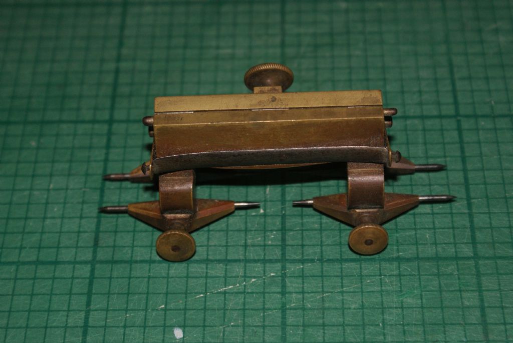

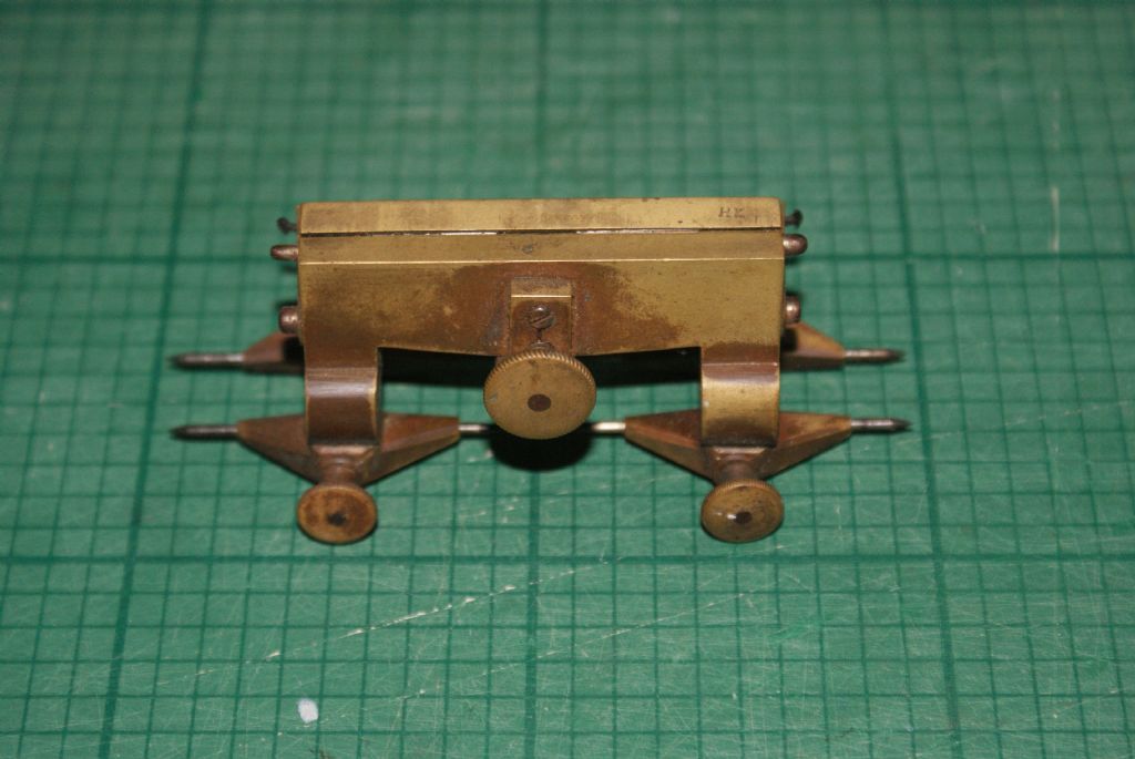

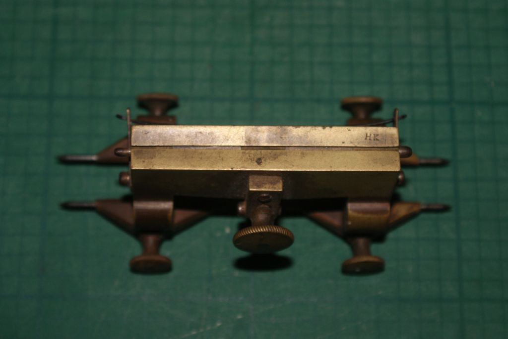

dsc04861.jpgdsc04860.jpgAnybody anydsc04859.jpg ideas on what the item is, what was it used for and how was it used.
The squares in the background are 5mm

Its a depthing tool for checking the mesh of clock wheels and pinions and then used to mark the centers on the clock plates

Clockmakers depthing tool - for setting out the pivots of wheels and pinions.
