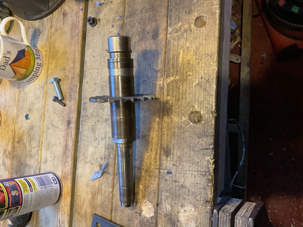

My wife does not need all that gardening stuff in the shed, so when I saw an old Burke horizontal mill for sale, at a good price and with tons of tooling, a stand and a motor, I decided to go for it. The Zyto and Dore Westbury are now both working fairly well so I need a new toy to fix up.
It’s still in the car, but I got the arbor out this morning, having cleaned up the cutters that came with it.

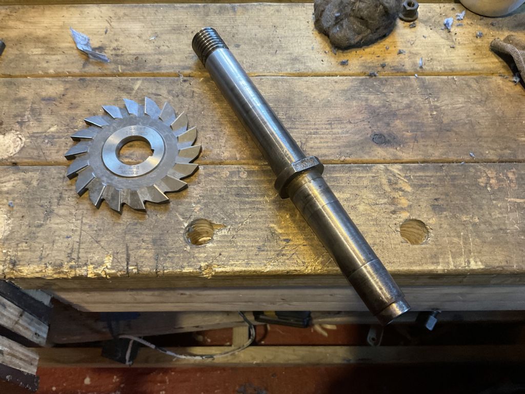

I was surprised to find the arbor had no key slot, despite most of the cutters clearly wanting one. Is this normal? Is friction enough to hold such cutters?
Or will I need to mill a slot in the arbor/get another one? Apparently it’s a Browne & Sharp #9 taper.

No keyway is fairly common on arbors for smaller horizontal mills. Friction should be enough to hold the cutter for the width and depth of cut that can be taken. I suspect that B&S tapers are rare in the UK, so hang on to what you've got. All the arbors for my horizontal mill have keyways. But it's a heavier, more powerful, mill capable of taking large cuts.

Yes, normal.
Opinion varies. Some like the positive drive provided by the keyway for maximum metal removal, but things break when there's a crash. Others prefer to rely on friction, which is enough for most purposes and is less likely to damage anything when a cut goes wrong.
What sort of hobbyist needs to maximise metal removal rate? I suspect bad-tempered gorillas with a headache! I prefer to work within what I and my machines are capable of, which is slower than what professionals must do to earn a crust.

I have used horizontal mills for many toolmaking years and have never needed keyways even on quite heavy powerful machines but on hard working heavy production work they are used to maintain accuracy with gangs of cutters and to make it possible to unscrew the arbor nut after heavy use I have seen a case hardened arbor nut "explode" under heavy industrial use due to lack of a key tightening a cutter gang. That takes a LOT more power than us model makers are ever likely to see. If the at least one spacer needs to have a keyway to make it possible to use a key with thin cutters Colin

I wouldn’t use a key in anything less than 6mm wide. With thin cutters, particularly slitting saws there can be the danger of the cutter shattering if keyed, rather than slipping between the collars. Also narrow cutters have a tendency to deform or shear through the key making it difficult to remove.

Even if you thought it needed a slot - DON’T!
That arbor was ground straight as a precision piece of kit. Cutting a slot would very likely end up with an arbor which is not quite straight!

I've just looked up the lathes.co description, but it's limited only to the smallest in the American manufacturer's range, designated the '0' and slightly large '1'. The number being that embossed on the casting, with the name.
Nevertheless the text suggests all these machines were small, and fitted with lever-action manual feed, via rack and pinion. Such machines, including the lower ones in the English-made Denbigh'H' series, were designed for semi-skilled production tasks like cutting slots and spanner-flats, on small components.
So the lack of a keyway may have been intended to give some protection against an operator - probably on very tedious piece-work - over-loading the cutter on a stub-arbor that has no outer suppport. An arbor with keyway would be more for the controlled conditions of a machine with self-acting feed, set to give the appropriate tooth-load.
Milling-cutters are all given keyways so they can be used on suitable machines, but that does not mean they always need a key.
