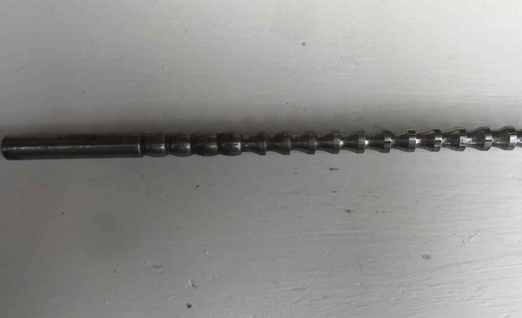

Why not 'gun drill' the bores with a single lip cutter made from drill stock? Guaranteed size and roundness as well as concentric.
I think this has been covered before, but more to do with automotive size valve guides, in that thread I replied the production method I most favoured was the broached finish with 'ballising'
Here is the picture I posted from that thread of the Triumph Meriden tool used for producing the PB guides in their engines:-
Martin
