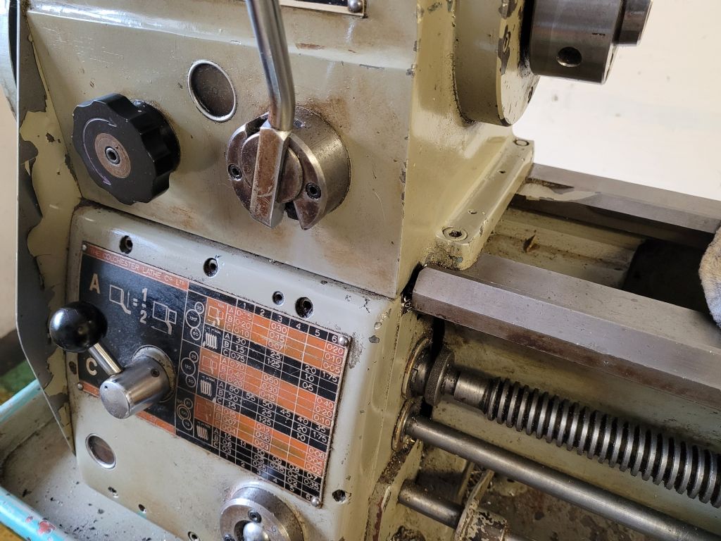

Hello all,
Apologies for my first post looking for info but im unfortunately on a deadline to move this lathe before i have to return to work.
Essentially ive just acquired this Colchester from my neighbour who sadly passed away recently. I wasnt that interested in it to be honest as i already have a fairly new warco to do my odds and sods and as I definitely fall into the amateur category, my needs are fairly basic. But once i saw it, i knew that it was just in a different league to mine!
Ive stripped it down as much as i thought necessary (including removing the motor), unbolted the bed from the stand, and i still cant lift it! But looking at the headstock, it seems to be two gearboxes stacked ontop of each other and removing the top one (chuck drive) appears to be relatively straight forward. Question is, will i be compromising the setup of the lathe by doing this or is this a necessary evil to shift the lathe?
Thanks in advance.
Gaz Lippid08/08/2021 17:55:46
13 forum posts
9 photos
Although ive no doubt you guys already know what im talking about, heres a picture showing the headstock in question. It looks like two bolts at the front onto the bed and two at the rear. 'Seems' straightforward?
Neil Rimmer 108/08/2021 19:04:17
8 forum posts
The front gear box, is bolts and dowls, and can be removed, pulls forward. The head stock is bolted to the main bed, (then lifts up) I removed mine the first time I moved it. The bed on its own, remove the saddle as well. it is still very heavy, but managable.

It all depends on how far you need to move the machine. I have the very same lathe and had to move it some distance when I collected it. I used an engine hoist to lift the lathe from the stand and place on a pallet truck. I strapped the lathe well down and with my partner pushing and me pulling was able to move it 200 yards to my trailer. I hated the idea of taking it all apart. I removed the motor, tail stock and crossslide to reduce the weight and try to balance the lathes weight better.

Thanks guys. I managed to drag the whole thing into the middle of the room but once id unbolted it from the stand it became very apparent just how unstable this thing it. I really cant get over how heavy it is compared to my chinese Warco.
But, as someone has already mentioned, removing the cross slide will help but how difficult is it to remove the whole carriage? It looks like id would have to remove the guide bars and feed shafts to do this. Would this be a step too far?

BTW, you will need an honours degree in the 'Crypton Factor' to figure out the gearing and gearbox, it's not at all like that on my Student which a mentally retarded chimpanzee (me?) can understand, it is so obvious. I managed to get to grips with the Bantam gearing eventually and added copious notes in the margins of the manual which is very unclear, in my copy anyway, where the Imperial instructions end and the Metric instructions begin.
NB. Just seen your latest post regarding removing the cross-slide etc. The lead-screw, feed-shaft and control-shaft will just slide out if you remove the end support bracket. Don't lose, or replace, the thrust bearings when you take the shafts out. You can then drop the apron off the saddle and, after removing the rear shear guide, you can then simply lift off the saddle, if I remember correctly. I had to do this to replace the cross-feed screw which had a lovely sine-wave bend in it after the cretins had dropped the machine. Fortunately, the saddle hand-wheel had taken the brunt of the impact, shattering in the process, but the apron remained firm and the shafts and lead-screw were not bent, otherwise it really would have been a total loss, except for spares.

Gaz, The 'apron' is the lower front part of the saddle which is held in place with four Allen screws. It contains the feed gearbox and half-nuts, plus associated levers and carries the saddle hand-wheel. The rear-shear guide, as I termed it although it is probably more properly called the rear-gib plate or strip, is the part under the rear of the saddle which prevents the rear of the saddle lifting. You will find some shims between it and the base of the saddle. It's all very easy to strip down and re-assemble, as you are probably finding.
