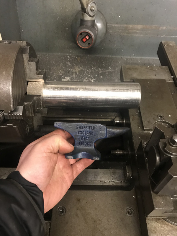

I started by bunging a bar of recently acquired stainless scrapbinium in the lathe and set to. (Anvil for Scale )

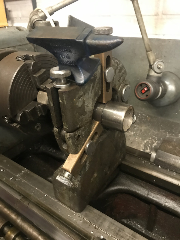

The stick out was a bit much, so I set up the steady in avoidance of wearing a 2" diameter chunk of steel
Faced the bar off to give me an idea of what I was working with,

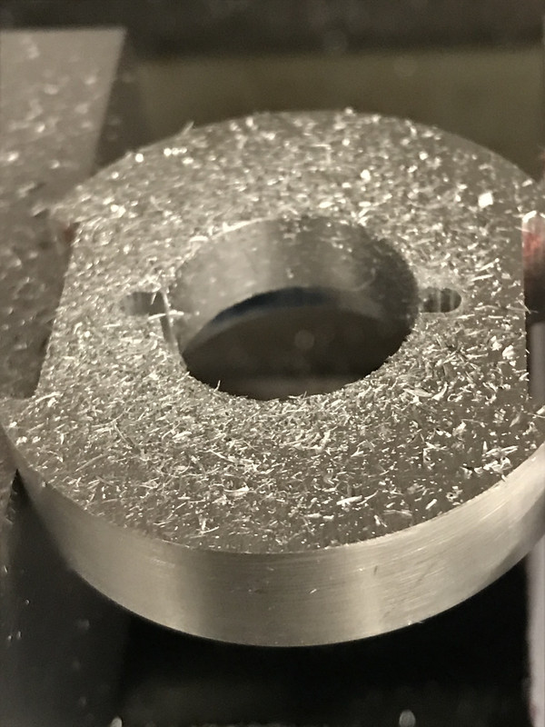

and then chucked a hole at the middle - the movement is actually a lozenge shape, so I roughed out the movement hole and the step for the crystal and chapter ring.
That done I bevelled the front and parted off a roughly case sized ring.
The hacking out of the movement hole will come later - on the Milling machine.

The movement actually sits pressed up against the back of the chapter ring, so my datum point was the recess that the chapter ring sits in. The back of the blank is not yet at a specific place, so I made a brass plug to sit on the chapter ring ledge and allow me to set up from the other side
These 2 mini slots define the ends of the lozengeish movement shape.

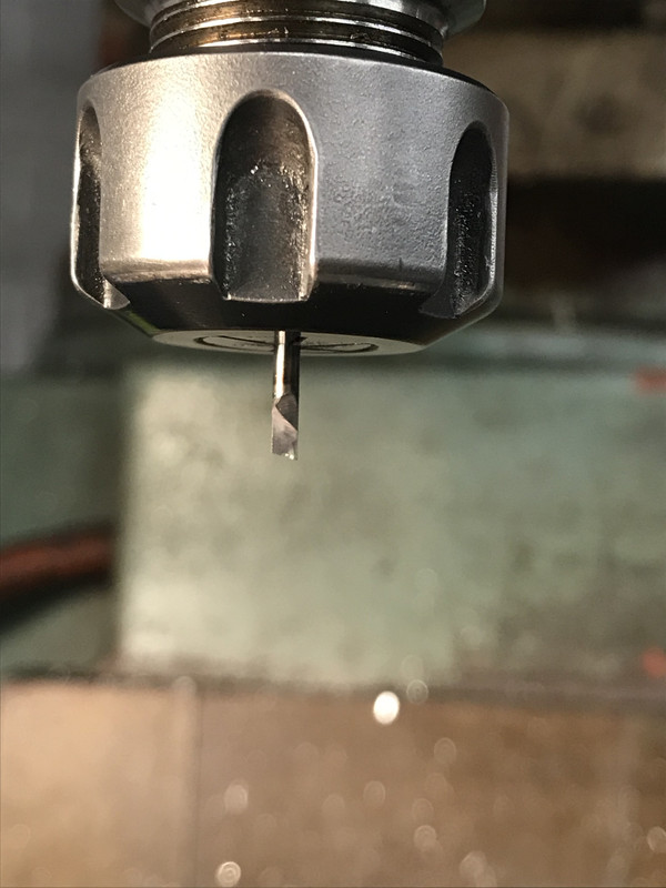

This is a single lip cutter - its ground out of a solid carbide bar and is a fair amount bigger that the hole I intended to make, but needs must - I can always sleeve it (shh - spoilers

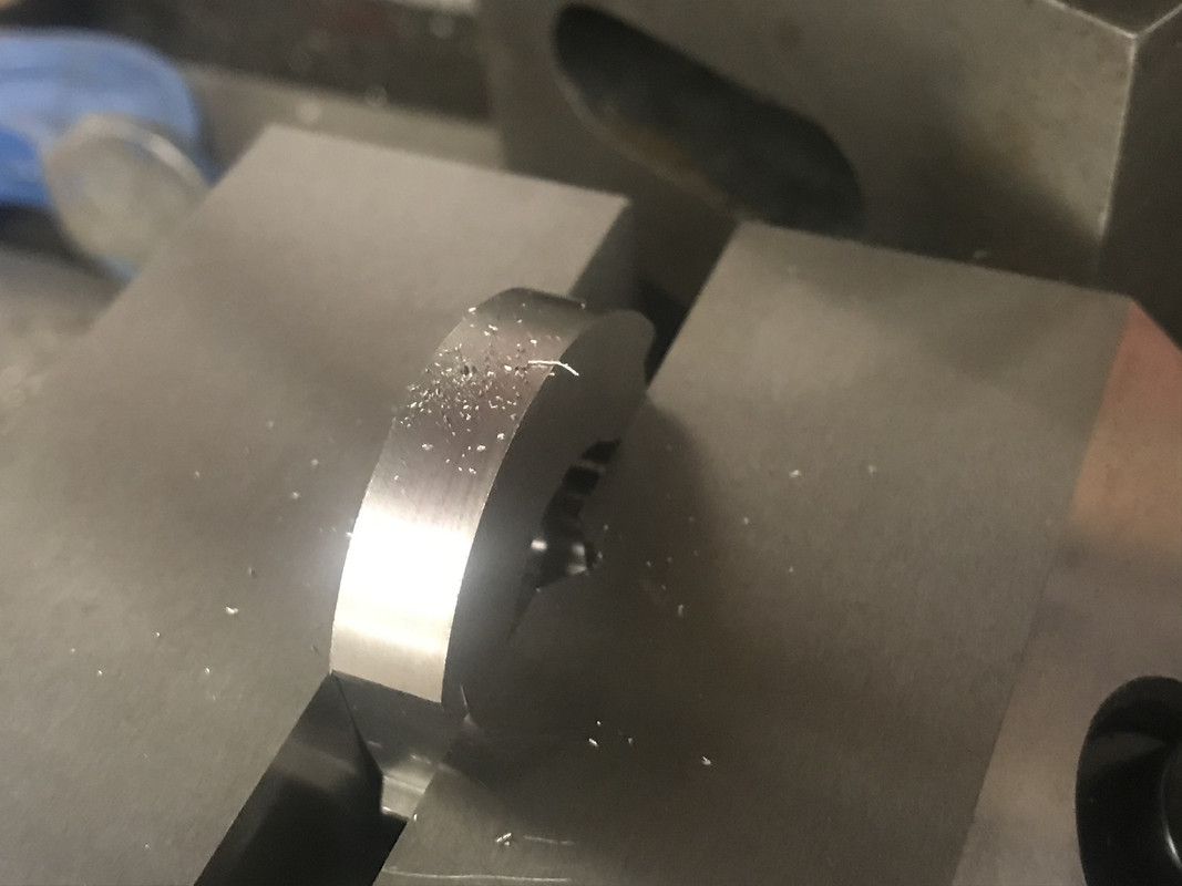

I machined the round surface flat first, so I had a good starting point, and then pecking 1 thousandth of an inch at a time I proceeded to drill out the broken bit and the rest of the hole. Incidentally the plaster is in no way related to the watch case.
Now seemed like a good time to make it more watch case shaped, so I created some angled sides - Straight edges and curves are IMO a good design statement.
Whilst I had the case setup I put in the spring bar holes - I prefer drilled lugs as it makes strap changing much easier.

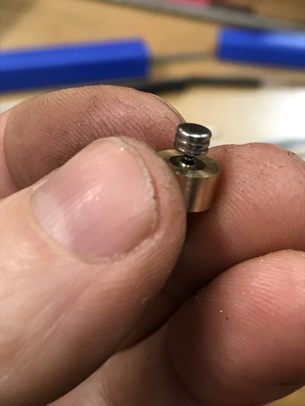

I originally planned to make the case and stem tube in one piece, but the rather large hole required a new plan.
I didn't have any stainless in about the right size, but I do have some brass. So brass stem tube / crown guards it is.
The colour will make an interesting contrast, it might even look like a design choice

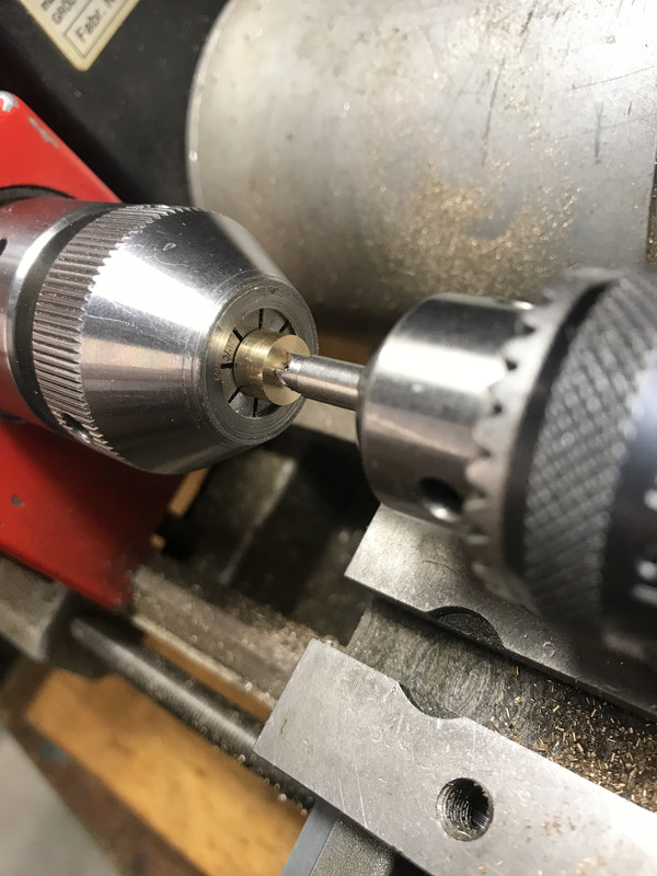

I made a cutter to create the crown recess from silver steel:
I filed 4 'teeth' onto it.
Then having faced and drilled a piece of brass on my smaller lathe I setup to use it
The original crown and stem fit beautifully, Feels like the o-ring seals will be fine.

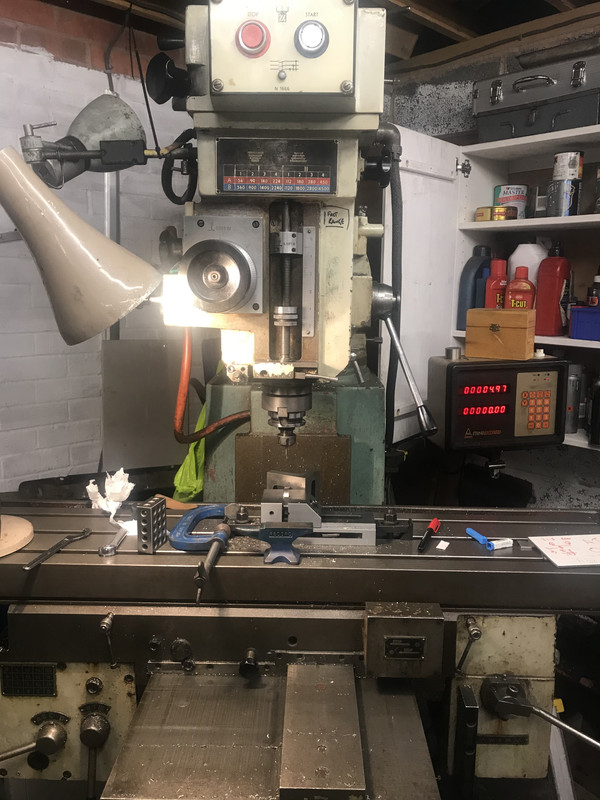

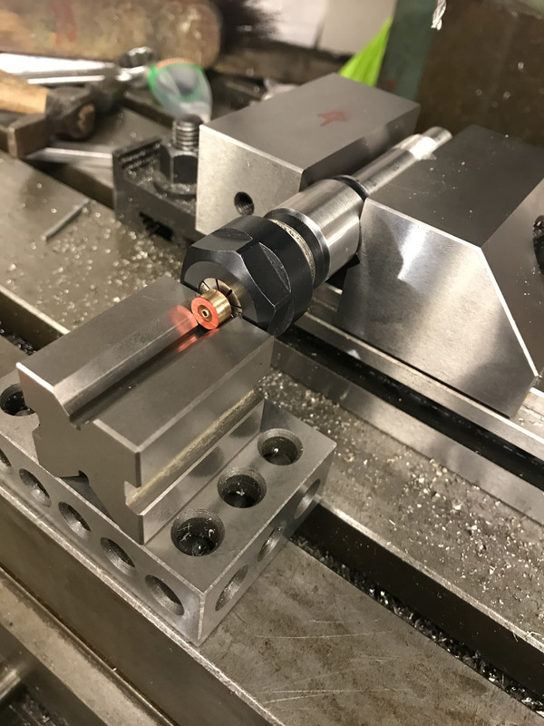

To the milling machine!
Flip and repeat for the other side
Ta Da! now its simpler to get to

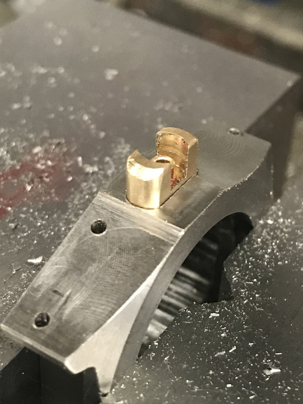

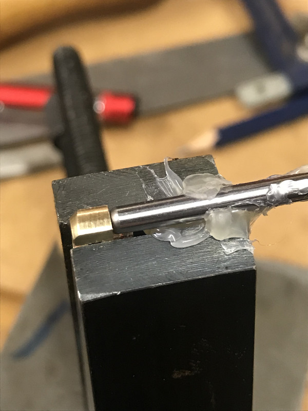

The milling has left somewhat sharp lines on the guard.
I wanted to blend them, so with the help of a hot glue gun and a piece of carbide I made a radius filing jig.
My little assistant helps to illustrate the size of these things
Once radiused I can then use the same diameter endmill to cut the recess into the case to fit the crown for length (its amazing how these things work out )

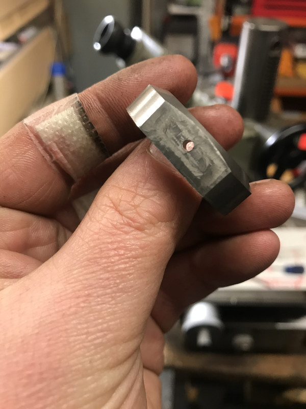

Crown sorted now time to do the light pusher.
She was very adamant this still had to work.
Of course its another hole in the case but this one I didn't snap a drill in. You can see it just next the the crown guard in the previous photo.

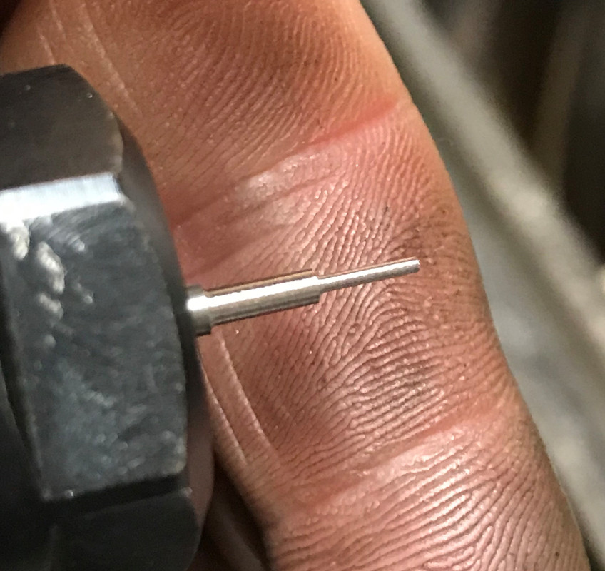

The Light pusher has a pair of o rings, a spring, and is held on the inside of the case with a tiny tiny E clip.
Fortunately I had just finished making a grinding work holding spindle, so I pretended my surface grinder was a cylindrical grinder:
Then made a quite long, stepped and very thin thing. To turn this on the lathe would have been 'tricky', especially as the stock is already hardened.
Then "all" I had to do was put a groove in the end with a small diamond file

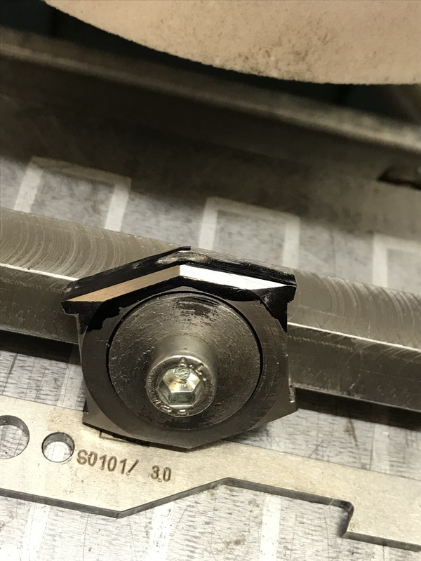

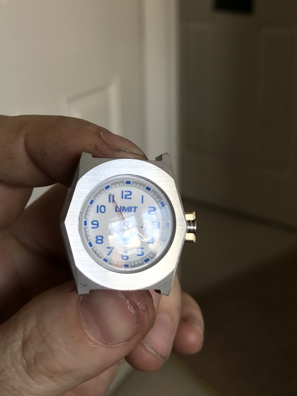

All the bits are made - time for some finishing. I surface ground the straight edges, of course scrapbinium is not magnetic, so I had to make a fixture to hold the case to the chuck. First I ground the sides and then I added some facets - to reduce the weighty look of what is admittedly a large is chunk of metal.
The end result came out ok I think.
Its not perfect, but I'm fairly sure she wont snap the lugs on this one:
