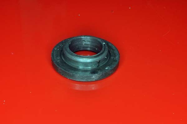

Hi there,does anyone know the dimensions of the base of the tool post stud on a ml7,as in the part that goes up into the topslide not the shaft or thread size.Im fitting a quick change toolpost and the stud is different,so am going to turn up a base to press into the bottom of topslide threaded to suit new stud,if anyone knows the diameter would save me having to take it apart and back together before I make it!

Richard S214/07/2021 15:32:11
avatar
237 forum posts
135 photos
ML7 tool post base measurements of mine are 0.8735" x 0.192" thickness. The dowel pin is 0.081" diameter.
It is on a PCD of 0.3135" on mine, so nominally 5/16" (0.3125). The pin height is 0.2187" or about 5.5mm-
This is a 1949 model, the dowel pin size is wire/number size 46. Later Myfords may have different size pin.
And I've gone to the effort of providing an image-
