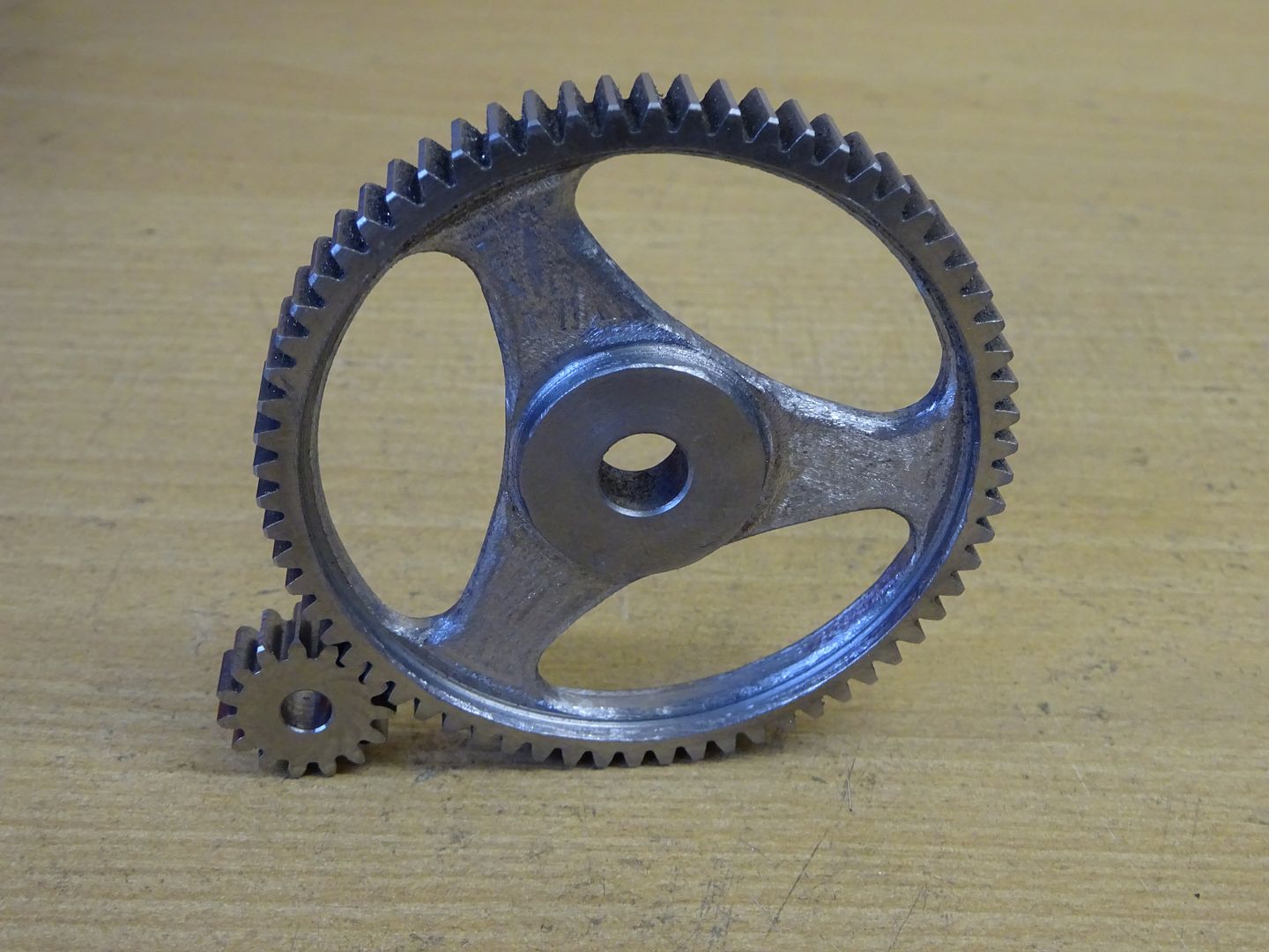

I bought some similar very cheap ones and found they wear quite quickly, OK for a couple of gears but could see the finish going off after that.
I hope they are MOD1 as your image shows 16DP which is close but not MOD1 and the 14.5pa is not usual on MOD cutters. No mention of MOD or DP on Amazon eithercrook

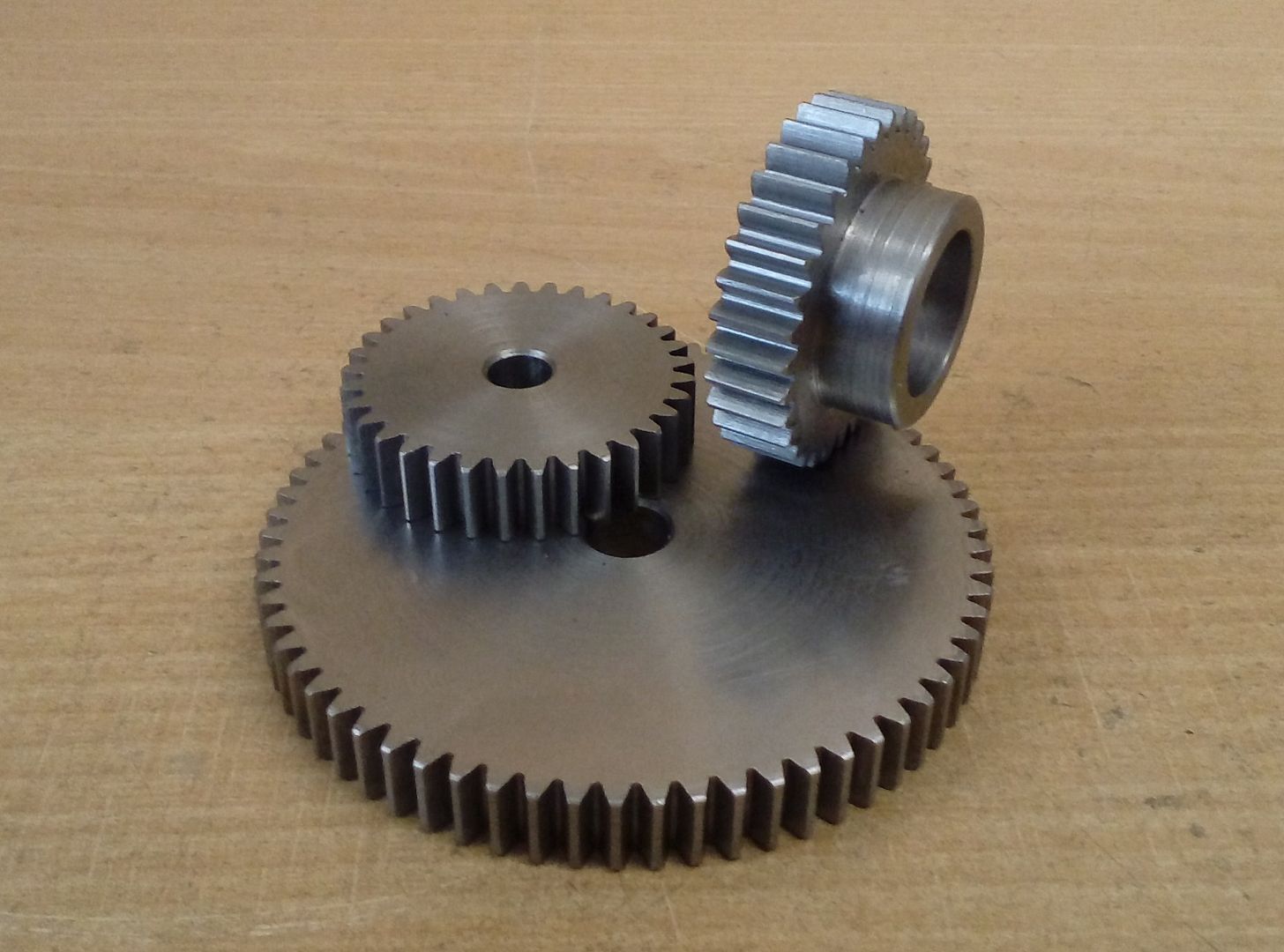

EN1A on the smaller gears, Larger one was more likely EN3, blunted a lot faster than say the £20 ea RDG ones. Think they were MOD0.5 and about £5 each

Posted by JasonB on 12/07/2021 12:32:32:
My goodness, your gear pictures make me even more determined to cut involute teeth. What is wrong with me? face 22
