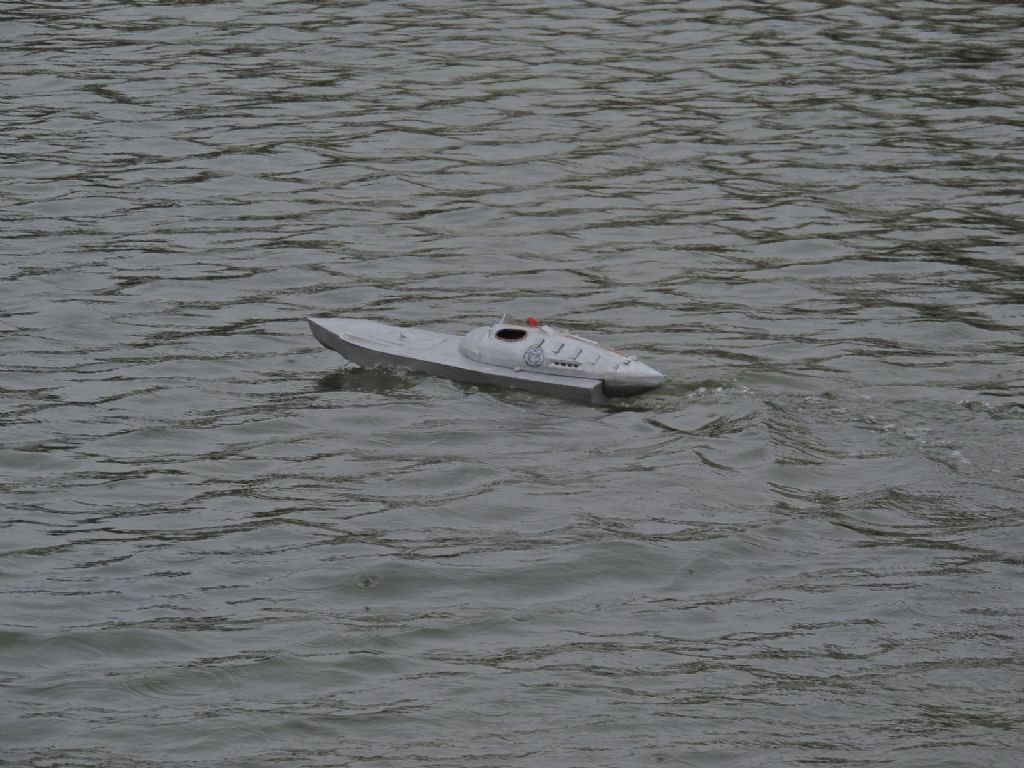

I made Vic Smeed's 'whaleback inspired' model from a Model Boats special when I was in school. It was underpowered with a 'monoperm'. About 2000 I finally finished it with a freelance superstructure and got it going with a 540 motor. It went like waste matter off a shovel, with a three-foot rooster tail behind it!
I've just got it back into sailing condition, it's well over 40 years old. Will be interesting to see how it performs. back in the day I (Literally) ran rings around an off-the -shelf electric speedboat with it..
With less weight, same motor, more battery and a better designed hull Miss Britain ought to go even faster if I can get it sorted.
I have a much closer scale Whaleback in 1:16 to my own design that I want to get into sailing fettle as well. I'#ve also agreed with Dad that I can get his Cossack back on the water.
