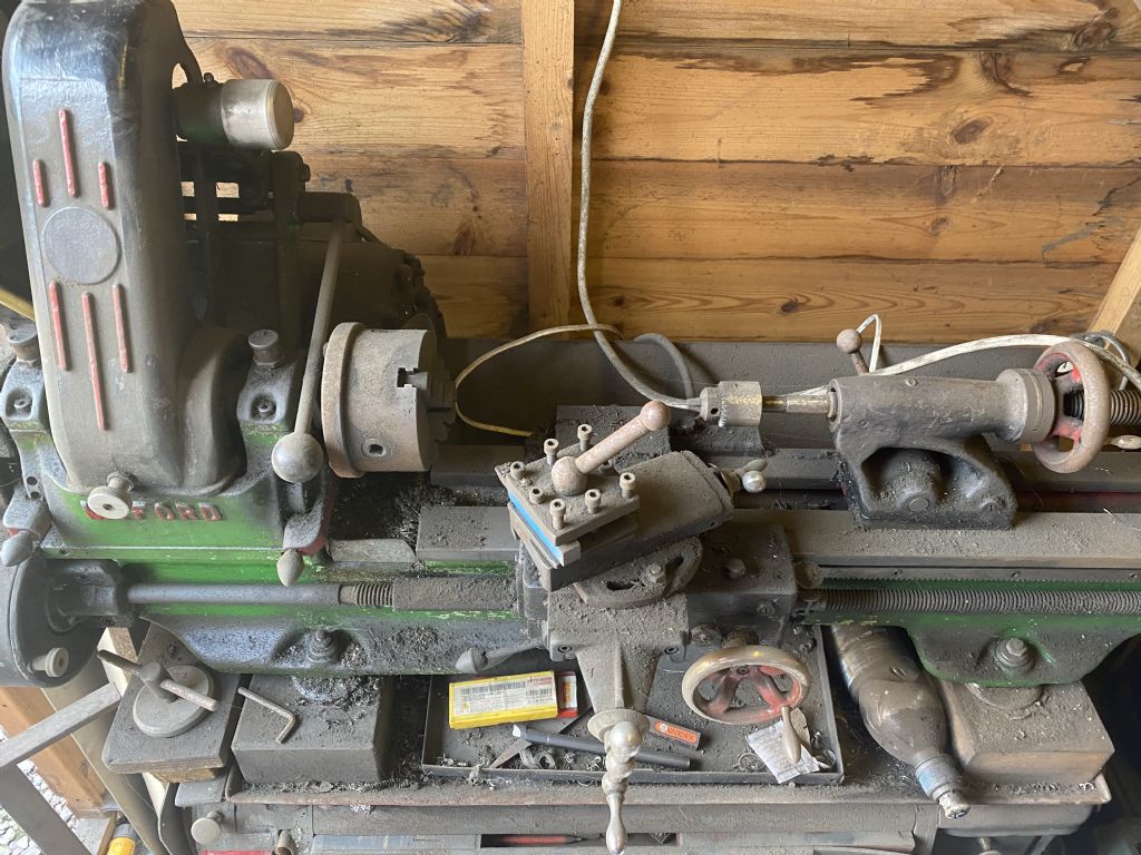

Hi I was just wondering if anyone would know what model this is and anything else about it.

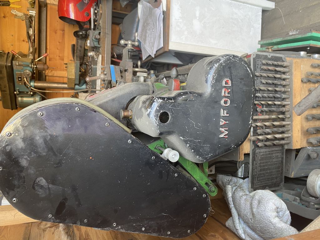

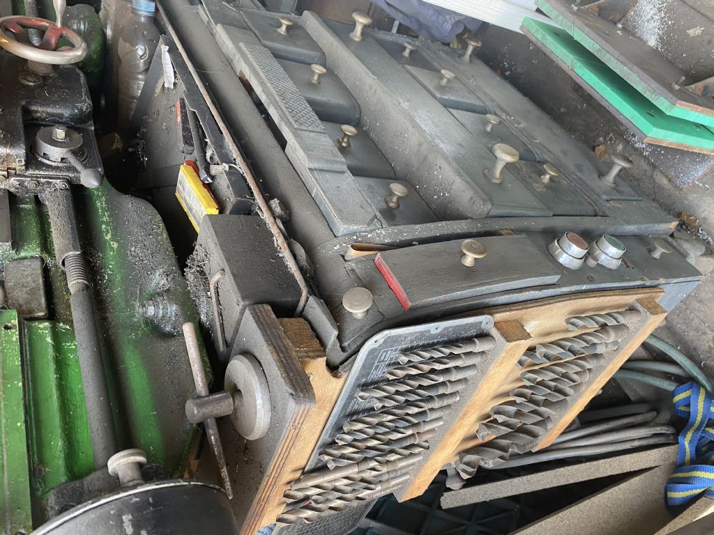

d2029247-e8c6-447d-b6bc-010995fbbca0.jpeg700217ad-353f-4c5d-8b18-6576bc8eb681.jpeg6a25e7b5-9bab-40da-86e6-aff14ba3be4b.jpegHi thanks for the reply, i have now inserted the photos.

It is a very early ML7 lathe probably 1947 to 1951 vintage.

The serial number, normally stamped somewhere on bed, would help.
Grindstone Cowboy20/03/2021 15:21:11
1160 forum posts
73 photos
Serial number will be on the back vertical machined surface on the right as you look at it.
Shannon Mackintosh20/03/2021 19:29:37
4 forum posts
4 photos
Hi
Thank you for replying, does anyone know how much it would be worth and do you know the best sites to sell it on. The only number we can find on it is 73/1103
Thank You.
Nigel Graham 220/03/2021 20:56:55
3293 forum posts
112 photos
That is a Myford ML7 but the number you quote might not be its serial number, although 1103 would correspond to being made in 1946-7.
The makers didn't exactly help us, with their habit of stamping the number on the back of the bed, but that number does not otherwise square with Myford serial-numbering practice, because the ML7s were designated by the letter "K" followed by 4 digits starting with 1001 made in 1946, then 5 digits from 1950 on.
The Myford section of the lathes.co site gives a list of the numbers against years.
Mine for example is K2227, so made in 1947.
It is stamped on the rear vertical face of the bed, behind and below where the tailstock is usually parked.
Myford machines go for quite a lot of money if in reasonable condition and with plenty of their tools and accessories. Where to sell? Well, this forum's, or the magazines' Sales ads, would be a good start, especially as you've already given us a couple of photos. You could try lathes.co, for a fee, but I think fixed, not commission. Or Homeworkshop ( I think dot-org), a classified-ads site for workshop machinery and tools - as I recall it doesn't charge but asks for a donation.
