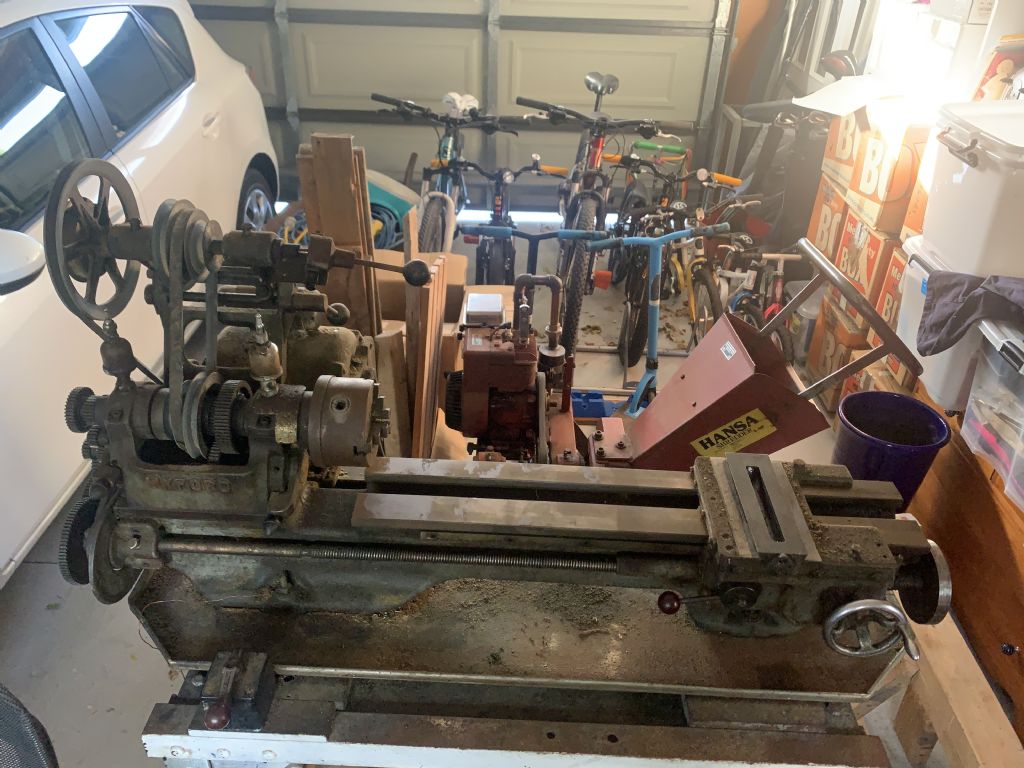

Afternoon all
I recently inherited my grandfathers lathe that has been sitting in storage for the last 25 years. It’s pretty gunked up and has accumulated some rust, sawdust, dust and grime.
In short - its a restoration project! Something to keep me busy for the next few years worth of weekends 😉
The manual I can find online for ml7’s is dated recently (1997) but obviously older. Based on the serial - K2276 - this machine was early; 1946-1948 era.
So my question is (apart from where to start!) - what would this have looked like when it came out of the box? Is the 1997 manual appropriate?
I’m guessing bearing are likely going to need replacing, and the bed looks like it has some surface rust that may require it to be refaced. I’ve also got some questions about cutting metric threads that I haven’t had a chance to chase - so if anyone has some good references to look up, I’d appreciate the links.
Thanks for your help
Tom

Hi Tom,
Where to start? Cleaning it might be a good idea. Next would be to measure it up to see what, if anything, is worn to the point of needing correction.
The one thing you should not be doing is ‘guessing’.

ML7 Users Manual is available free all over the net for free. Not sure of its year of publication but ML7 was an ML7 with few changes -- in the finest British industrial tradition -- until its obsolecense and demise.
But you should also get The Amateur's Lathe by L H Sparey to give you more practical pointers on how to use the machine and sharpen toolbits etc.
+1 on don't pull it to bits to clean it. Not a beginners task. Tidy it up and learn to use it. Scotchbrite might clean the rust off the bed. Don't use grinders or abrasives on the bed. And clean the Scotchbrite off after.
Bearings can be adjusted by removing tiny shims from between the two halves if there is excessive spindle play.
Bed can be saved from a regrind by doing a Wide Guide conversion . See MEW issue 287 for details. But no need to rush into that straight away. Get some use out of it first.
Metric threads can be cut on a Myford using the standard change gears without needing special gears. Charts for that are in the book Screwcutting in the Lathe by Martin Cleeves.
These books are still in print and available and reconditioning Myfords has been in numerous previous threads on here if you do a search.
And plenty of help on here if you have specific questions.

I would just gently rub the rusty parts with some wire wool and oil. That will remove most of the rust without harming the machined surfaces. You may be forced to do some dismantling, if parts cannot be reached, but it is an old machine and if you intend to use it, the parts made are more important than just how pretty the lathe that produced is.

Thanks very much everyone for the advice. My inclination was to strip it as a project - lots of sage wisdom here has convinced me to take the subtle approach!

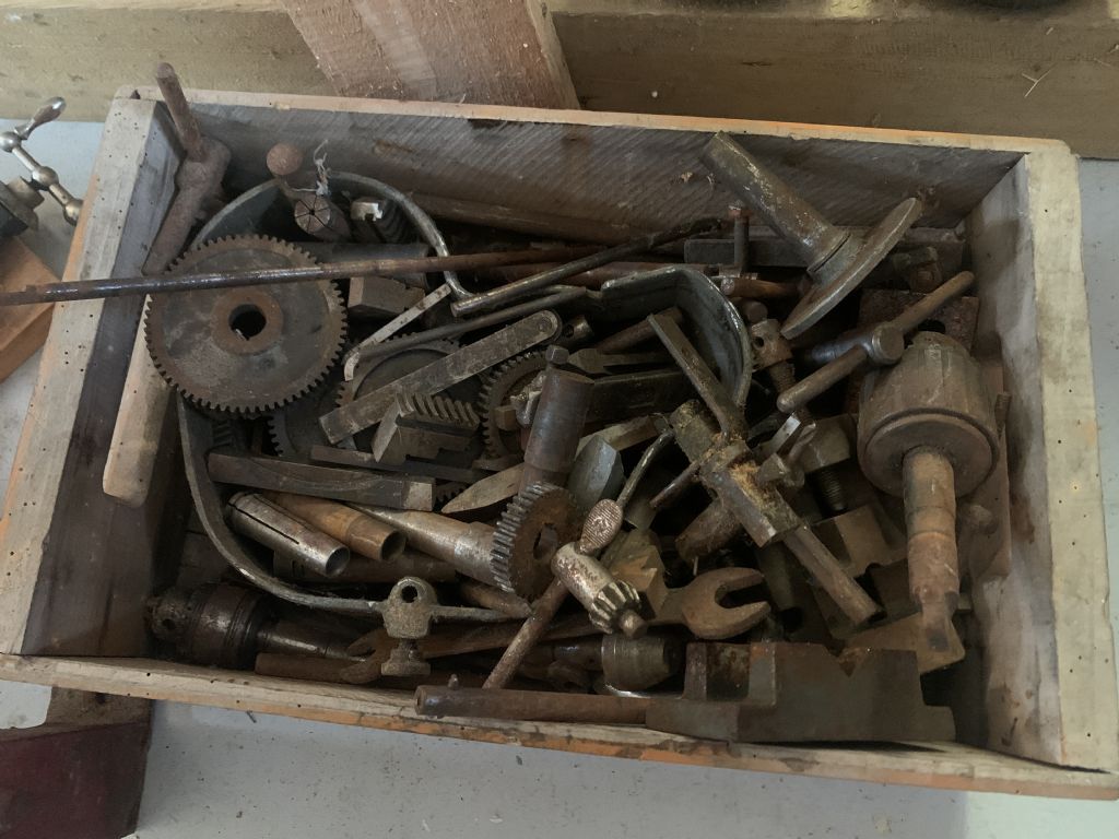

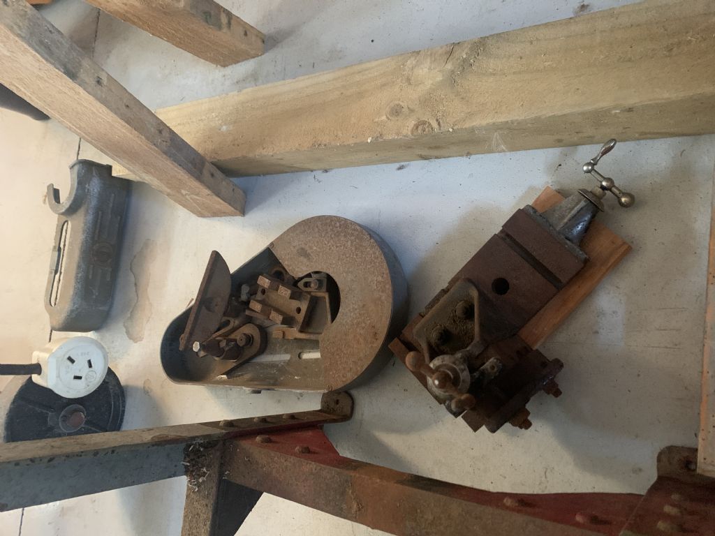

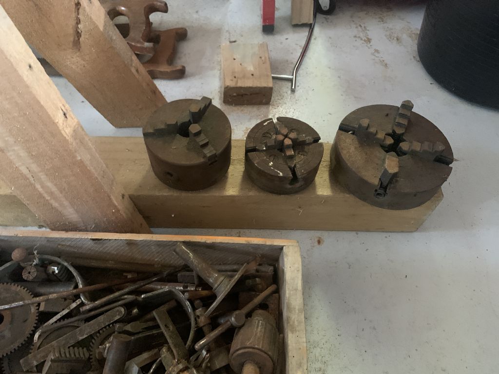

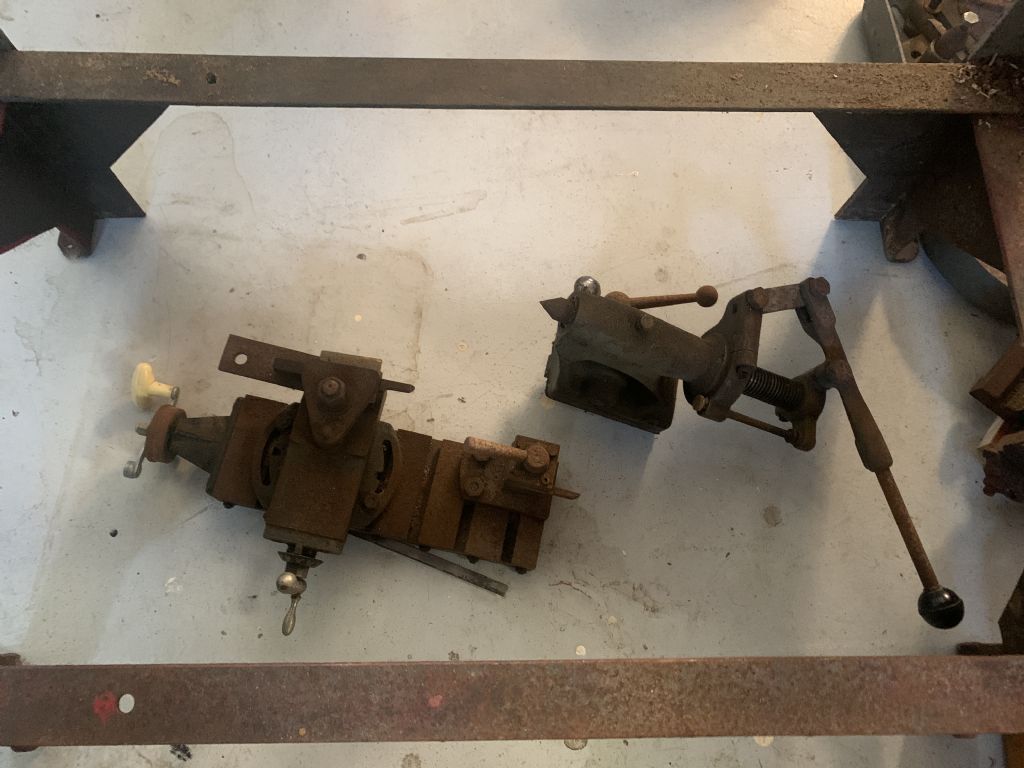

Wow! Looks like you have scored the motherlode of Myford accessories there. And the rust on the base machine appears very light. I would clean the paint down with degreaser etc and maybe wire brush the painted area and repaint with brush paint without disassembly. Looks like the bed ways and leadscrew and motor drive unit are all in pretty uncorroded condition. That is great,
The boxes of bits appear to contain a fantastic collection of accessories. The old boy seems to have collected about the full kit over the years. I see a long cross slide - highly desireable - with rear toolpost plus regular cross slide and veritical slide, plus lever action tailstock. All very desireable. And the boxes appear to hold a treasure trove of change gears and tooling. Very good. And I see a Myrford milling vice, various collets, a ball turning tool, V blocks, reverse chuck jaws, hand turning rest and just about everything imaginable short of the Myford dividing head. A good haul!
PS every time I look at it I see more. It has a clutch and a graduated leadscrew handwheel. Awesome.
Shame the cross slides etc appear to be more rusted than the main body of the lathe so best clean them up, post some pics and seek advice on best way to proceed there. Again careful cleaning and repainting with a brush will work wonders. A wire brush in the electric drill is good for painted areas and rust that is NOT on essential precision slide ways etc.Do one piece at a time so parts do not get mixed up etc.
Keep us posted on how you go. And seek advice frequently. What you have there is well worth taking care of.

I agree with Hopper that you have scored a wealth of desirable accessories for your ML7. I suggest that you trust your late grandfather's judgement regarding the non-Myford items - he almost certainly acquired/collected them because he figured they'd be useful. Time will tell.
The official Myford user's instruction book (that's not its proper title ) includes illustrated parts lists. These include what are often termed 'exploded diagrams'. Those lists and diagrams are available in down-loadable form on the Myford web-site. (Also, I believe, for the Super 7 as well as for the ML7.) Here's an example: **LINK** . (Note to moderators: I hope I am not out of order with this link in view of the latest forum rules. )

P.S.: The electrical socket in one of your photos doesn't look like a UK item - what is your geographical location?
