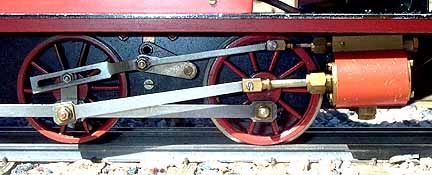

JasonB10/02/2021 07:15:22
avatar
25215 forum posts
3105 photos
1 articles
It is not so much the amount of movement but the relation of the movement of the piston in relation to the valve. As a good starting point when setting the timing the valve eccentric or in this case your pendulum needed to lead the crank by 120degrees as it stands yours has no lead so you won;t get steam entering the cylinder at the right time.
The double crank is one method that would work as is the eccentric and angled valve that I suggested above.
Example of the double crank arrangement.
Redsetter10/02/2021 09:22:10
239 forum posts
1 photos
The most difficult part of building the loco in question will be making the cylinder and piston. In comparison a single eccentric or slip eccentric valve gear is an easy job and will work well.
You could consider using an oscillating cylinder engine with a geared drive but this is not really much easier. Oscillating cylinders are not quite as simple as they look, and have to be accurately made to work properly - perhaps more so than the slide valve equivalent.
I would suggest that if a good "alternative" valve gear for small models existed, then it would have emerged already in the 100 or so years that we have been playing with steam engines.
Nick Clarke 310/02/2021 11:51:54
avatar
1607 forum posts
69 photos
Posted by Redsetter on 10/02/2021 09:22:10:
Or as an alternative what about the slip return crank as used by the Hackfly locomotive?
Redsetter10/02/2021 12:06:15
239 forum posts
1 photos
Posted by Nick Clarke 3 on 10/02/2021 11:51:54:
No reason why not, though perhaps a bit fiddly in 0 gauge and of course only suitable for outside cylinders. It depends how well it fits in with the overall design. It is sometimes overlooked that valve gear is three-dimensional, and has to fit in the space available.
