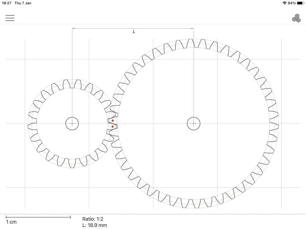

Michael Gilligan07/01/2021 19:34:18
avatar
23121 forum posts
1360 photos
Sorry, Brian ... This only does Module and the centre distance is a tad too big : but it gets you in the right ballpark.
Module 0.6 Gears 21 tooth and 42 tooth

Michael Gilligan07/01/2021 23:36:21
avatar
23121 forum posts
1360 photos
For Brian, or anyone else with a similar query ...
I have just downloaded a very simple [and free] iOS App which does these calculations
... highly recommended if you have a suitable device
**LINK**
https://apps.apple.com/gb/app/spur-gear-calculator/id827110560
No fancy graphics ... but it seems to get the sums right
