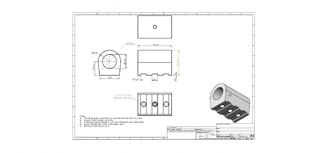

Ian Armstrong24/12/2020 17:19:19
17 forum posts
1 photos
Hi Oily Rag
My first stab at dimensions. I'm making from scratch and only have the 'Bedroom workshop' photos to work from.
Ian
peak424/12/2020 17:19:29
avatar
2207 forum posts
210 photos
If you're not already aware, The Bedroom Workshop is quite a good resource for information.
My own RGA (as yet unused by me as I need to make a universal head) id different to the one shown in the photos in this link. Rather than a solid Z shape, mine is built up of several parts; the top piece which supports the head is on a swivel, which looks original.
Depending on what design you're looking for, you appear to have a couple of options.

Oily Rag24/12/2020 18:03:14
avatar
550 forum posts
190 photos
Hi Ian,
I've dug my Clarkson RCA out and what I'd forgotten is that it is a MkII - having said that I am not sure it is a standard MkII as it came directly out of St Mary's Rd Factory and may be a prototype or special.
Perhaps someone can confirm if it is a MkII!
On this the toolholder assembly (I've still got to dig that out!) is similar to your drawing but the tenon is coaxial with the bore not at right angles as shown in your sketch.
It locates into the female tenon slot as shown in the first photo. It has a very long toolholder 'tube' to allow for long tooling to be raidiused. I also have a lathe style square toolholder which allows lathe tooling to be radiused accurately.
I'll dig the bits out and post later!

Oily Rag24/12/2020 22:10:00
avatar
550 forum posts
190 photos
Ian, peak4,
Ere'tiz:-
and separately with its sleeve:-
Look in my album "Clarkson T&C' for further photos.
The lathe tool tip grinder eludes me at the moment but I shall search it out! Measurements for the tenoned block (it is interesting that it is made in aluminium ), is as follows:-
Overall length = 2.887" (Not including the internally screwed collar/thin wall sleeve - that is 2.248" o/d, collar shoulder depth 7/16th, bore i/d 1.5005", sleeve o/d 1.6845"
C/line of bore to tenon location face = 1.125", tenon face major width = 1.92", tenon locating width = 0.8745", depth of tenon = 0.245". 3 holes in male tenon are tapped 7/16" Whit (BSW) there spacing along the tenon length are 0.567" from one end x 0.9" x 0.9" ctrs.
Sleeve clamp screw is 5/16" BSW centrally displaced along axis centreline.
The thread in the retained inner sleeve appears to be 1 5/8th x 20tpi whit form (but I will confirm later)
The long sleeve is interesting in that it is in two parts (which at the moment I cannot separate!) More details of the sleeve will follow. There is one other item which I need to photograph and that is a straight shanked (1.000" dia) centre point which is the setter for the radius offset. it fits into one of the sleeve ends (one long sleeve end is 1.250" dia the other is 1.000" dia)
Hope this helps you get started on making swarf, if you need any other dimensions then feel free to mark up any of the photos and repost.

Clive Foster24/12/2020 22:14:43
3630 forum posts
128 photos
Ian
I have a Mk 1 radius attachment with the correct adapter holder. Your drawing looks about right. I can easily check the dimensions if you send me an electronic copy of your drawing to work from. Picture above doesn't blow up well enough to see properly. With luck you can save in a CAD format that I can open and edit directly.
PM me for my E-Mail.
