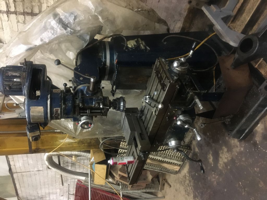

Hi All.

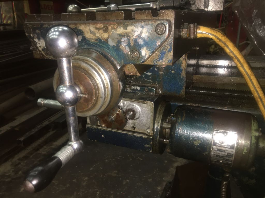

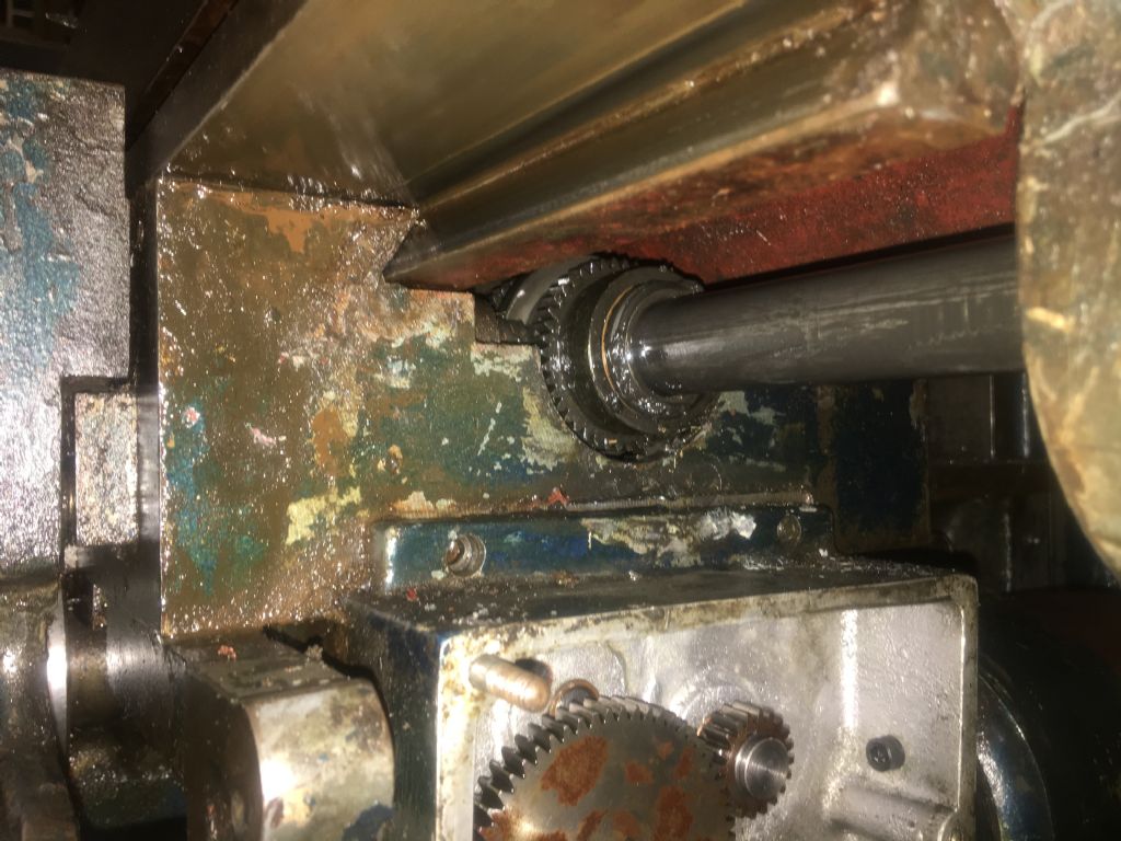

Ive had collision with the stop on the power feed and lost drive and was wondering if there was shear pin I've missed.
The motor and the change gears drive fine but there is no drive to the leads screw. I did have a quick look last night but was unable to get the drive box off so i removed the handle and the end cap casting on the right side of the bed but was unable to remove the collar or incremental dial( i thought it may be on a keyway). I didn't want to force it as i can till use the mill at the minute without power feed. Any advise or pictures of the parts brake down would be much appriciated.
Regards
Scud

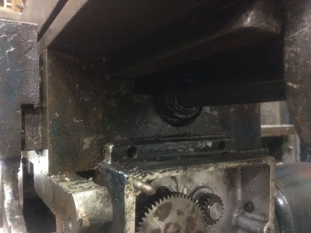

can't feel any knotchyness but when I've removed the change gear cover all is turning fine in there but when i look up in the bottom of the bed the gear that drives the lead screw is not turning but the shuttle lever works ok for left to right and from what i can see appears to shuttle ok. It does look like the drive gear may have dropped?? but not sure if that is just the top of an intermediate gear and should be clear of the lead screw

Quick and dirty test is to try and back drive the leadscrew. Best if there is a nut on the end but if not suitable soft packing and parallel grip pliers or similar to get a hold on it should suffice.
If the screw turns relatively freely it will, in conjunction with similar observations of the gear train, help you narrow down where the drive has been lost.
Shear pins or similar weak links like Myfords Tufnol gears are normal in feed drive trains.

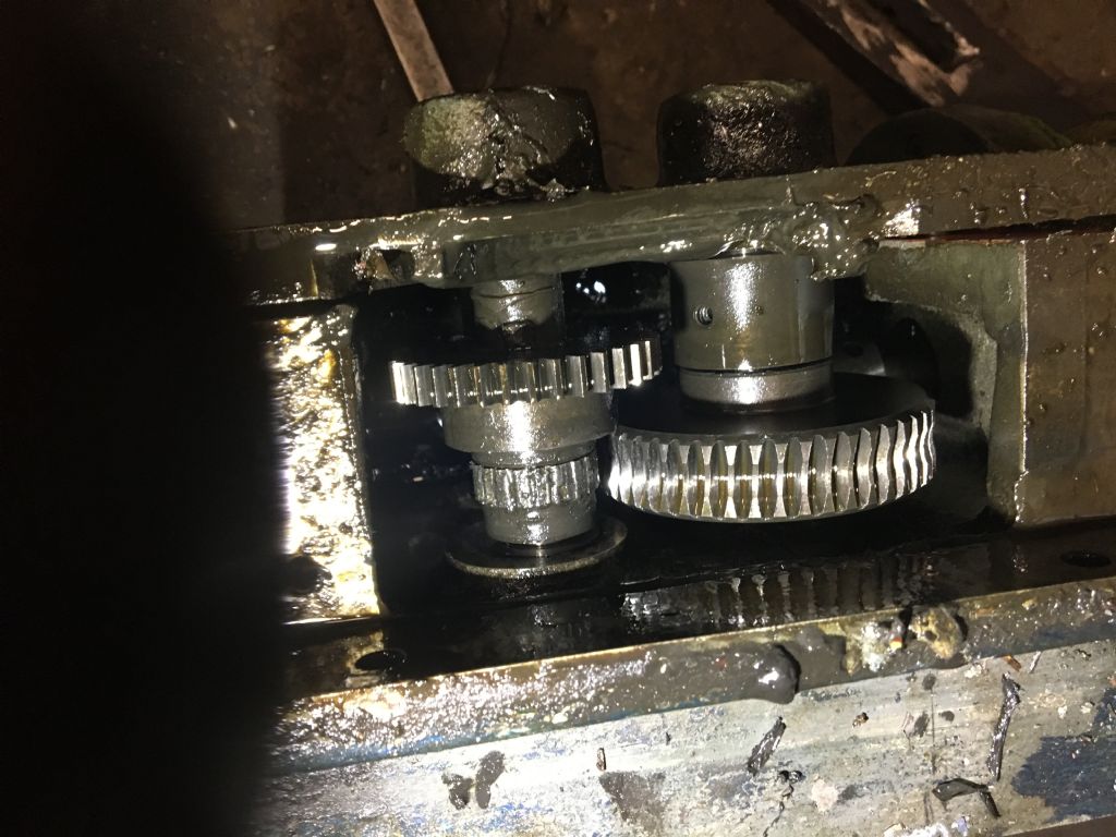

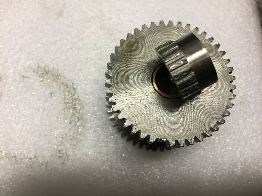

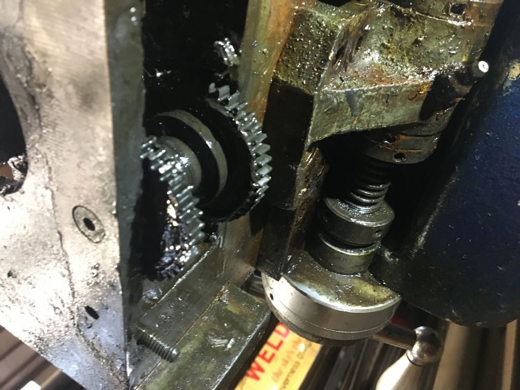

346f4a14-4c5a-414e-b329-516c1e781993.jpegHi all well after a good few hours stripping the mill gear box assy down, I’ve found the problem and it’s not good see photos. My next question is where may I locate these 2 stripped gears.

These are the 2 gears required now removed from the boxe0172d94-9d13-42e7-bb11-1a4843100b94.jpeg
