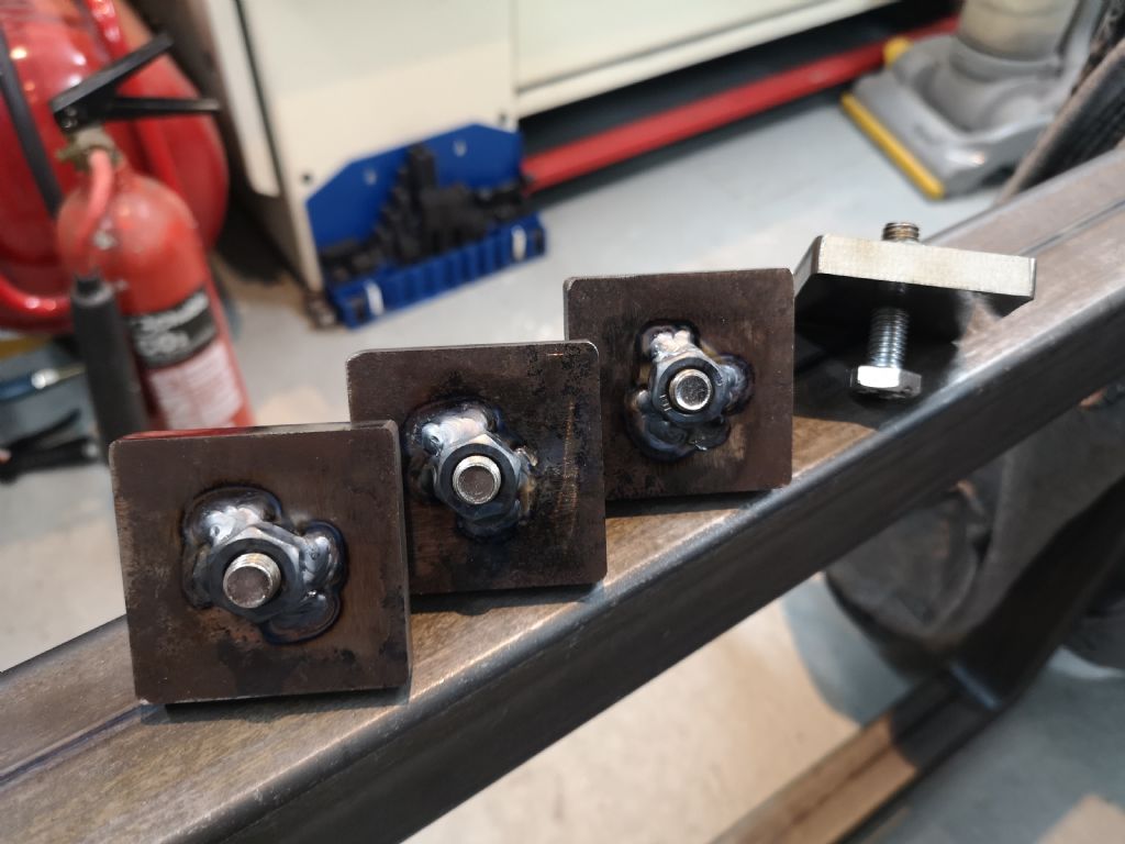

Building the table
Cutting box section:
Tigging up:
Adjustable feet:
3D printed pads, to save the floor:
Fini:
Cutting steel for the router frame next.

Steviegtr25/10/2020 20:45:29
avatar
2668 forum posts
352 photos
What would we do without box section. Nice to see you are using the Tig set.
Steve.
