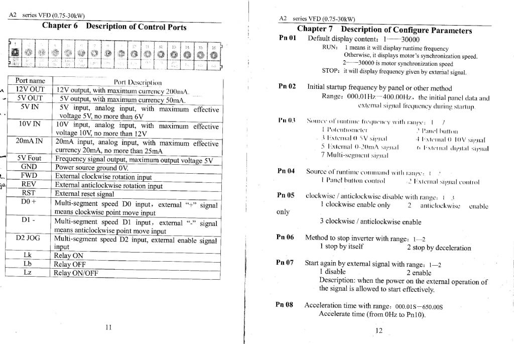

As documented elsewhere on the site, I've been working my way round the workshop converting my machines to 3-phase motors with VFDs one per machine. I started with the mill with a HuangYang VFD. Easy, peasy. Then the shaper with a a cheap import controlled from the panel - no problem.
Now the lathe. Again a cheap import supplemented with a forward/reverse switch, E-Stop switch and Speed pot in a remote unit bought from the Internet. I thought it would be simply a matter of following the same steps as with the mill (also has remote), but oh no! I can get the forward/reverse switch to work despite an incorrect wiring diagram supplied with the remote. Can I get the VFD to recognise the remote potentiometer? Well, no, actually, I can't. These are the connections additional to the mains in/3-phase out in the manual:
My dilemma is where to connect the pot leads? The obvious connections are GND and 5V out to either end of the pot track and pot wiper to the 5V in terminal. Combine that set up with parameter changes Pn04 to 2 (External signal control) If I set Pn03 to 1 (Pot frequency control) it runs but no speed control. Set Pn03 to 3 (External 0-5V) the lathe doesn't run at all and the pot doesn't alter the displayed frequency.
Any bright ideas, chaps? I've been pulling my hair out over this for two days, off and on and I'm reluctantly resigning myself to operating the lathe from the onboard panel for the time being, or buying another HuangYang unit.
Hope the manual scan is legible.

Have you tried Pn04=1 (Command from panel), and Pn03=1? Then press run, and twiddle the pot. Should prove the VFD is working.
I think you have the pot wired correctly (though what value is it?) but it's not clear where the external start input is. Just a guess, but it may be done by putting +5 on either FWD or REV. ie they are Run FWD and Run REV, rather than just direction options.

Hello John, is Pn03 = 1, frequency reference from the pot on the front of the drive. Have you checked to see if there is a voltage present on the 5V IN terminal when you are trying Pn03 = 3 ?
Regards,
Michael
Edit - The digital inputs are switched to COM to energise them as you have seen on YouTube.

John, in which case Pn03 = 1 may be invalid for your drive. I have been looking at a manual for a drive (on the web) that has a small knob (potentiometer) on the front, pages 11 and 12 of that manual are exactly the same as pages 11 and 12 in your manual.

That isprobably explained by the fact that my manual cover two different VFDs- one with and one without a panel mounted potentiometer. Which only serves to confuse matters even more. I'll get there-maybe not tomorrow, maybe not the day after, but sometime. I won't be beaten. Think I'll check out the internal fuses, just in case. The manufacturer thoughtfully suoolied three spare ones inside the terminal cover. They must have know I might do something stupid!

Yes, that's the same manual as the one that came with the vfd, same manufacturer. My problem is getting my head around the parameters and my fingers around the wiring. I'll go back to square one parameter-wise and start again this morning. At least I can make it run forwards and backwards.

Well, with a combination of help from here, a deep re-think, a reset to factory settings and a night's sleep later and it's sorted. Everything is back together and working as it should. Except I have mislaid the 4mm key that drives the spindle gear. It would be the smallest one, too. I'll have to wait until Monday when the key steel I've ordered arrives before I can do any cutting under power. Manual feed only for the moment.
A big thank you to everyone who responded either on here or by PM for your help.
For the benefit of anyone following in these tracks, these are the settings I used with reference to the manual page 9 in Peak4's post:
Pn01 = 1 Displays instantaneous frequency
Pn02 = 50 Starting (base) frequency
Pn03 = 3 Selects remote pot wiper as source for frequency control
Pn04 = 2 Selects remote forward/remote switch for direction selection
Pn07 = 2 Enables the start again function from external source
Pn08 = 2.5 Seconds My choice of acceleration to speed - I always reduce to zero speed on the pot before switching off.
Pn09 = 2.5 Seconds. Deceleration time see previous note
Pn10 = 60Hz Maximum frequency set in the software.. Again, my personal choice to prevent chuck overspeed in highest gear ratio.
Pn12 = 50Hz. Motor rating frequency
The rest are as per the manual.
Remote wiring connections reference page 5 of the manual referred to above:
Potentiometer: "low" side - to GND, "high" side to 5V OUT, Wiper to 5V IN
Forward/Reverse switch: GND to one side of the switch, the relevant lead to the respective FOR and REV terminals on the VFD.
Hope that helps someone.
