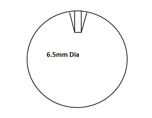

Hi Guys,
           Using a fly cutter to cut a clock pinion is not an easy task on higher carbon steels. I am told it is a good idea to remove as much metal as you can before using the cutter.
Using a slitting saw achieves some removal.
However what I am looking for is an economic way to remove metal after the slitting saw to leave a chamfer which the pinion cutter can hopefully finish.
There are several possibilities and I have a rotary table so can rurn the stock as needed.
My ideas off the top of my head
Dremel diamond disk used on Sherline mill. A purpose made fly cutter just for hogging out. A chamfer bit (but is expensive) A double angle bit (is expensive), a rotary burr.
What do you more experienced guys suggest (apart from buy a Thornton's cutter).
Chris

JasonB24/08/2020 17:22:11
avatar
25215 forum posts
3105 photos
1 articles
Simple single point tool in a homemade holder. Tool can be ground from broken ctr drill or milling cutter shank if you don't want to buy a HSS blank. Holder is just a bit of round steel bar, cross drilled for the toolbit and tapped at the end for a lockscrew

Try making two angled passes per tooth, this will leave you next to nothing to remove with your flycutter. If it is so difficult for you to make a pinion why don’t you make a lantern pinion instead? Lantern pinion only involves turning a cotton reel shape and drilling a few holes and poking a bit of pinion wire into them.

No need for me to make the holder as I can use the HSS blanks I have in the fly cutter holder. I think this may be the easiest solution ...thanks for post.
Thanks Baz, I am making a pinion purely to know how to and in doing so trying to look at best options. The lantern pinion is for another day. I am told making a pinion from high carbon steel is difficult especially with a fly cutter. Part of the fun is finding the best way to tackle a job, given I am a man in his shed economics comes into play.

Thanks for all posts, points I have picked up on are;
If using Silver steel anneal it first to be sure it is at its softest.
If you have as I do a rotary table you can run more passes at a slightly different angle.
Do not use abrasives on machine (My comment: but if you do use a cloth to protect ingress)
Because the final cutter is machined HSS is not to my knowledge normally used to make the fly cutter. However I am minded to attempt cutting HSS as Jason says using initially the grinder and then my new bench sander where I have more control. How easy it is to get such a small cutter by hand will be interesting to find out. This HSS cutter in theory should cut a chamfer and be easily modified / sharpened for another pinion.
I would also add I am keeping in mind the use of EN8 to use which is I believe machinable and can be through hardened.
