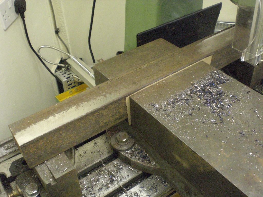

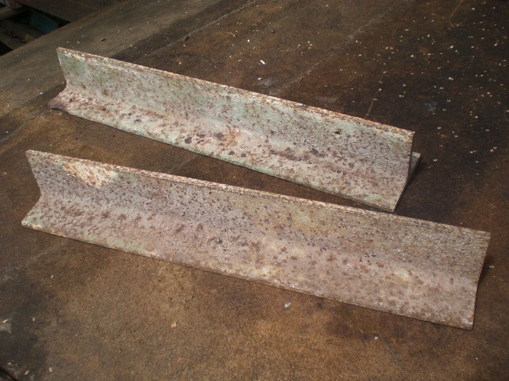

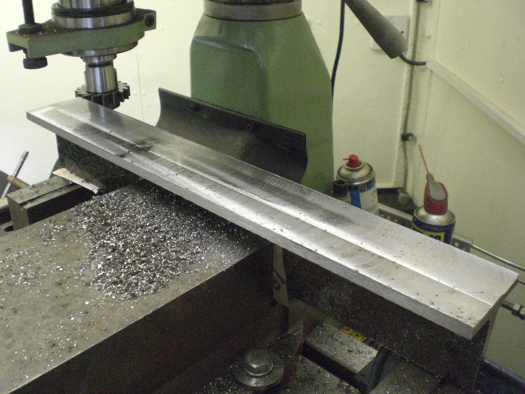

The above side is the third side that was milled. After finishing truing up the bar and while my vice was still set up on the machine, I turned my attention to making the pressing blade, which I made from a piece of 3" T iron, with a thickness of 3/8". 12mm was cut off with a disc cutter each side of the flat portion, as of course this was not truly square to the other part that forms the blade and it would have meant a lot more machining and would have made it much thinner, but there is no need for it to be 3" wide anyway.
After facing the flat portion, the two cut edges were milled to be equal distance from the blade portion. Again the two end were supported on the upturned V blocks and you should notice a piece of folded paper under the left hand end, this was just level up the flat portion after taking an initial skim to get the minimum amount to mill off.

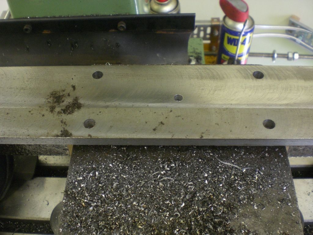

Four 8mm bolt holes were drilled while in the vice and using the DRO to get them centrally located, which are for attaching a plate and pin for my fly press, also a small central hole for a location pin for the plate and fly press pin.

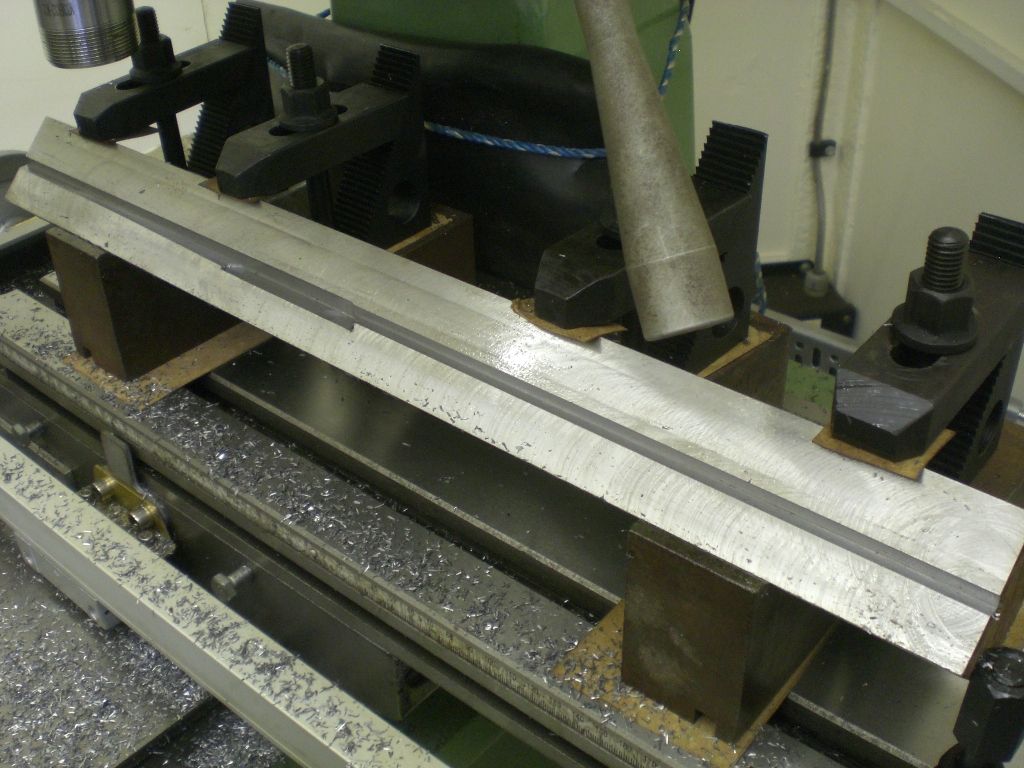

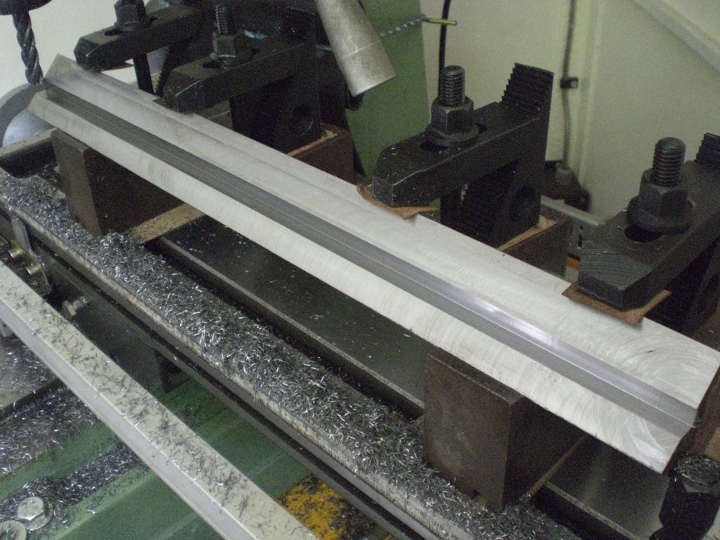

The T bar was then clamp down on the milling table, with the blade portion upwards and trued up along one of the edges of the flat portion and 12mm of the top end of each side was skimmed to get a a central location to cut a bevel on each side.
A bevel was then cut on each side using a 60 degree angle cutter, to leave about 0.3mm flat between the two bevels and a file was lightly used to take off the cut edges.
Thus the T bar blade is finished.

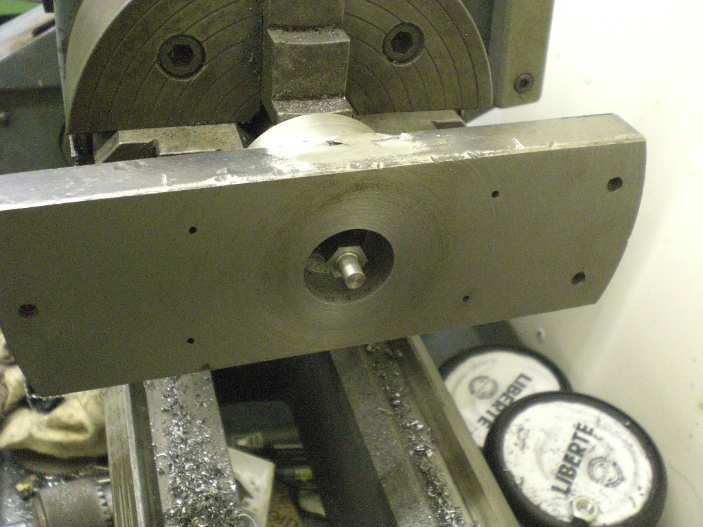

Hi, this week I've set about making the pin and plate, (on and off) which holds and presses the T blade, so an old piece 70 x20 black bar that was made for a one off job, several years ago was selected, so just cleaned the rust off with a wire brush with my 4 1/2" angle grinder.
A short piece of 2 1/2" BMS was then welded onto the side shown above.
I then cobbled four railway line fish plates and some 24mm threaded rod together, to make a press frame for pressing out the bowing in the plate, caused by the welding distortion.
The plate was set up in a four jaw, so that the BMS piece was towards the tailstock and running reasonable true and this was then turned down to a diameter of 55mm approximately and faced off, drilled and tapped 16mm. The top side of the plate was also face off, just to make it tidy.
A 1" diameter piece of BMS was turned down to the same length as the BMS on the plate and was threaded with a 16mm die and a short hole was drilled and tapped 8mm in the end for a locating pin. The photo shows a bolt in the threaded hole.
Regards Nick.

The pin was then screwed into the plate boss and then set up in the four jaw, so that the turn part of the boss was running true and the plate side that attaches to the T blade was faced off. The thread in the old hole in the plate was bored out and also making the hole to run true.

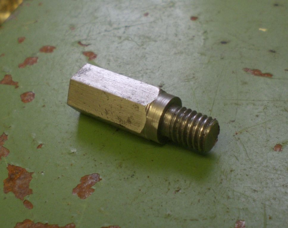

I then turned up a piece of 7/16" (11mm) hex bright bar with an 8mm thread 12mm long on my mini lathe and cut off a piece about 30mm long, ready fir the locating pin.
This was then screwed into the main pin and tighten up and the projecting part was turned down to 6mm and faced off to length.
The plate and pin is now ready for the fixing holes on the T blade, to be spotted through using the locating pin to get them central with each other.

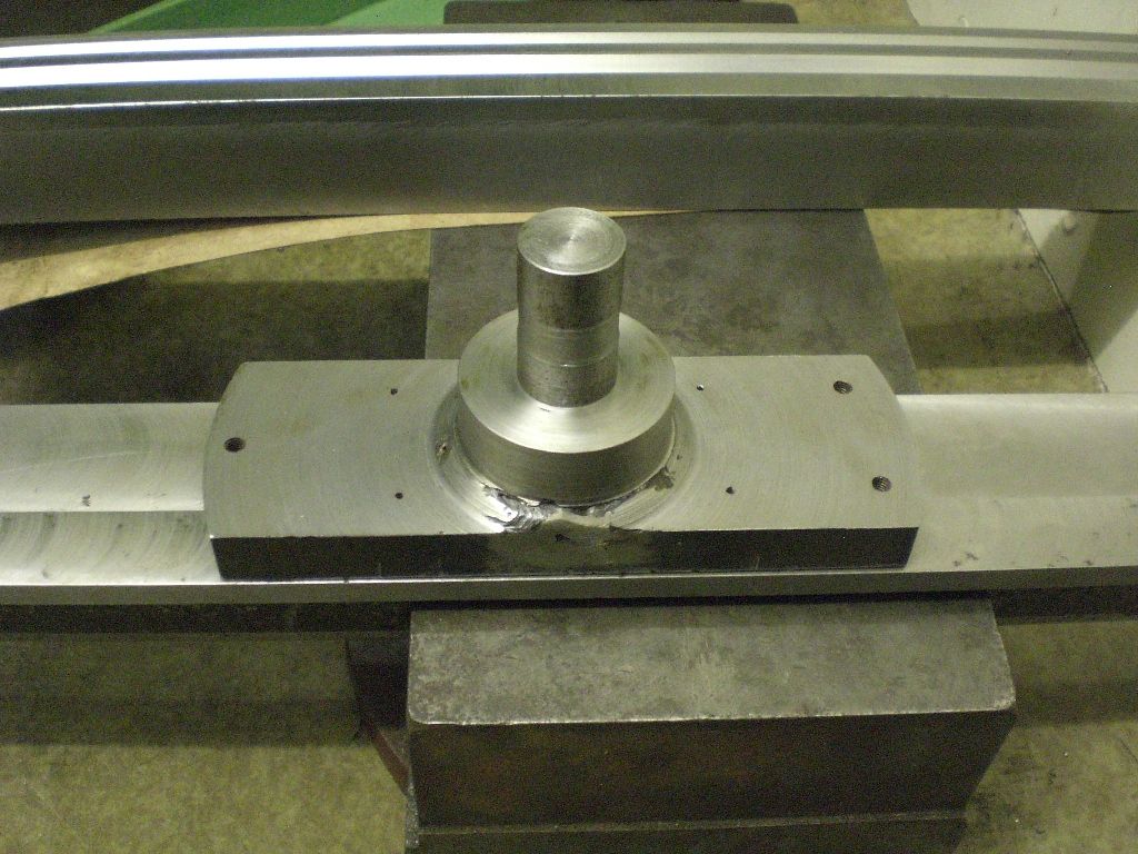

Nicholas Farr17/08/2020 21:11:53
avatar
3988 forum posts
1799 photos
Hi, I clamped the pin and plate to the T blade and spotted the holes with a transfer punch.
The plate was then drill 8.5mm and bolted to the T blade and was set up for a test bend with a couple of pieces of scrap 0.9mm ally, the length of the V block and T blade.
The bending operation was straight forward and quite effortless and produced a very good 90 degree bend in the test pieces.
This completes the making, but of course, shorter T blades can be made, if needed and fitted to the same pin and plate.
Regards Nick.
Edited By Nicholas Farr on 17/08/2020 21:15:40

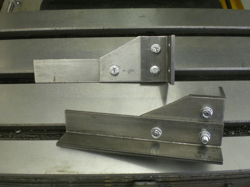

Nicholas Farr04/10/2020 09:14:34
avatar
3988 forum posts
1799 photos
Hi, I've added a back-stop and metal support rails to my V block, these can be fitted to either side of the V block, depending on which V is being used, as the back-stop bar won't reach close to the edge of the V on the far side. First two rails were built up from BMS angles and a piece of 2.5 mm MS sheet and bolted together.
The position for the threaded holes for attaching them to the V block each side were established by setting the block with the V's facing downwards on my milling machine table and the rails were positioned and clamped to the side of the block and a transfer punch used to mark the hole centres, which were drilled and tapped into the block. They were then fitted to the block to make sure the tops came level with the top of the block.
Two support rails were made in a similar fashion, but with a flat bar and a strip of nylon, and have the same hole centres for attaching to the block as the back-stop rails have. A strip of 3mm MS sheet 400mm long x 50mm wide for the back-stop bar, had each edge milled to remove the ragged edge of the guillotine cut and also to ensured a good measure of straightness.
After the back-stop rails had slots cut for 5mm S/S coach bolts, the whole system was fitted together.
I do intend to make another back-stop bar that will be only about 15 or 20mm wide, when I get a suitably thick piece of BMS flat bar and this will have slots in it to allow the bar to be set at different angles to the V's in the block.
Regards Nick.
