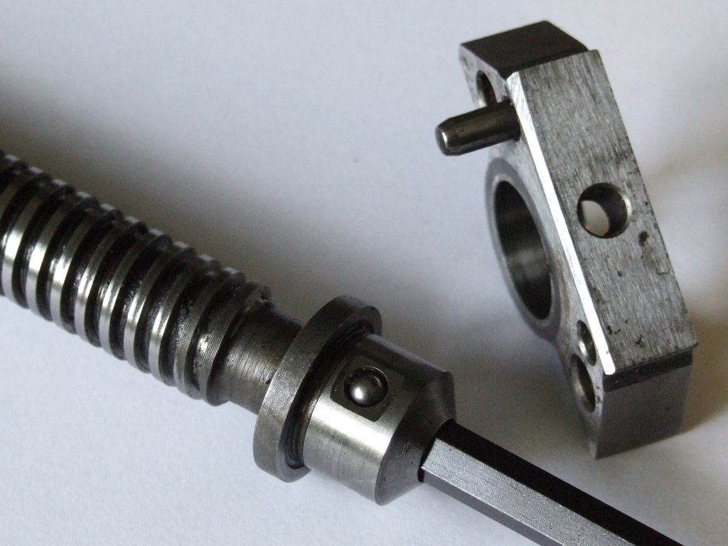

Andrew Johnston25/07/2020 09:48:19
avatar
7061 forum posts
719 photos
Finally got around to disassembling my UPA4:
Fairly straightforward, although it wasn't quite as the instructions detailed. I also fell at the first hurdle and had to buy a set of larger circlip pliers. Once I'd got the correct tool it took 5 seconds to remove the circlip!
It's clear that the locking mechanism for the coarse feed has parts missing. It's missing one ball, a spring and a detent. Sadly the spring and detent are not shown in the picture in the instructions. I can see how it would work, but it would be very helpful if someone could confirm that the lock only works in three places, spaced by 120°, and corresponding to the positions of the three balls. It's simple enough to get a replacement (4mm) ball but I'll need to make the detent and possibly the spring. I also need to replace a missing 4mm dowel pin.
Andrew

JDEng26/07/2020 08:44:55
27 forum posts
Posted by Andrew Johnston on 25/07/2020 09:48:19:
Andrew
Andrew,
The coarse feed on mine locks in three places, each at 120 degrees. The detent appears to be at the bottom and the ball in this position is spring loaded, with the other two balls being loose when the key has been removed.
Regards,
John.
Andrew Johnston26/07/2020 11:01:28
avatar
7061 forum posts
719 photos
John, thanks for the confirmation. Here are the parts:
You are correct that the detent and spring are housed in the hole in the block at top right. Note the block is missing a 4mm dowel. At least the serial number on it agrees with that on the main body.
I don't think the 4mm balls are spring loaded directly. When the Allen key is fully home (as above) the ball is slightly proud of its hole. I think there must be a tophat shaped detent in the hole in the block. When the ball is proud of the hole the detent can't engage with anything. As the Allen key is withdrawn the ball drops to the bottom of its hole and when the screw is in the correct place the detent can drop into the 4mm hole, thus locking the screw. The hole in the block is quite short so the spring is going to be short, given that the detent needs to be long enough to stop it canting over.
Andrew
