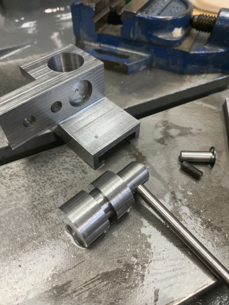

714 forum posts 414 photos | An item I have had on trial for a while is a set of Adjustable Stops for the Emco Rotary Table. These are in-valuable when two radii have to meet, or intersect. As the Stop takes away any chance of an over-run with the table, or turning the handle in the wrong direction. I was using this today on the Main Support for the Lathe Tool Honing machine I am building and described on a separate post. Also in use is something I made over 30 years ago, and shown above the graduations in the next photograph. It is a simple stepped and slotted Hold-out Washer. This sits beneath the indexing pin handle on the Rotary Table, there-by keeping the pin out of engagement with the Dividing Plate. This is a real boon when circular milling. It takes minutes to make but saves hours of frustration. Also in the shot is my revised X-Axis Stop and move-able cursor holder. More on that another time. Regards Gray, Edited By Graham Meek on 31/07/2020 15:18:48 |
Kiwi Bloke | 01/08/2020 07:46:38 |
912 forum posts 3 photos | Gray, it looks as though you are entirely successfully using your (modified) Emco 'Indexing Unit' as a rotary table, for machining slots and other curved surfaces. One would have thought that Emco intended it to be used this way, as well as for angular positioning and indexing, but the FB-2 manual states unambiguously that the table locks should be tightened before any machining. This would explain their decision not to name the thing an indexing rotary table, I suppose. But why make something that is almost a rotary table, and then instruct users not to use it as a rotary table? Strange. Several years ago, when I looked at my unit, I was surprised to see that the worm's axial constraint effectively depended upon on the nut securing the handle, and there was no provision for end-float adjustment. Also, even with the eccentric worm carrier turned to maximum worm engagement, there was significant angular backlash at the table (as far as I remember, the worm was not moving axially). I wasn't impressed, and supposed that the unit really wasn't designed to be used for anything other than angular positioning. I had other rotary tables to use for arcuate machining, so I didn't pursue it any further. What are your thoughts? Have you modified the wormshaft's location arrangement? Another possibility for adding stops to rotary tables is one or a pair of bands, incorporating tightening scews, which clamp to the table's periphery. A radial projection from each band can then contact a stop fixed to the unit's body. (Think glorified Jubilee clip, if my description isn't clear). |
Graham Meek | 01/08/2020 11:24:46 |
714 forum posts 414 photos | Hi Jerry, I understand the confusion with the Emco Rotary Table, given the Manual only describes an indexing function. As far as I was concerned the attachment was both from the start of owning Emco products. It would have been better if Emco had chosen a 60:1 ratio as regards using the attachment as a Rotary Table. The 40:1 ratio is a bit fast for circular milling but you get used to it, although somewhere in my drawing files I have a 60:1 worm and wheel conversion drawn up. I used the attachment as both Dividing Head and Rotary Table until I had a chance to design my own Dividing Head. This is a marriage of GHT's Versatile Head, the Emco Rotary Table, the Emco machine Vice swivel base and a bit of Meekising. As regards the end float on the Worm Shaft. In the normal Emco design all float is taken up by a special Bellvue Washer with a cut-out in it to clear the locking screw of the sector arms on the indexing plates. This serves two functions in that it provides friction to make sure the sector arms stay put, but also to take up the play in the worm shaft bearing. This is fine for indexing, but when it comes to circular milling it has an Achilles Heel. Provided the cutter rotation and rotary motion of the table are in sink, everything is fine. If however the rotary motion is using the Bellvue washer as its resistance to the cutting forces things can get a little hairy with a tendency for the cutter to snatch. To this end I have done away with the Bellvue washer arrangement and fitted a special spacer to take up the backlash. I use the same arrangement on my Dividing head, and feel I had better take some photographs of that. One photograph saves a thousand words, the special spacer can just be made out in the last photograph of my last post. As regards the depthing of the worm in the worm wheel. In the M8 Tee Bolt slot for holding the Rotary Table down to the cross-slide or milling table there is a Slotted Grub Screw that acts as a stop. This is screwed in or out to get the desired adjustment, but you will need just a little play. Hope this helps, Regards Gray,
