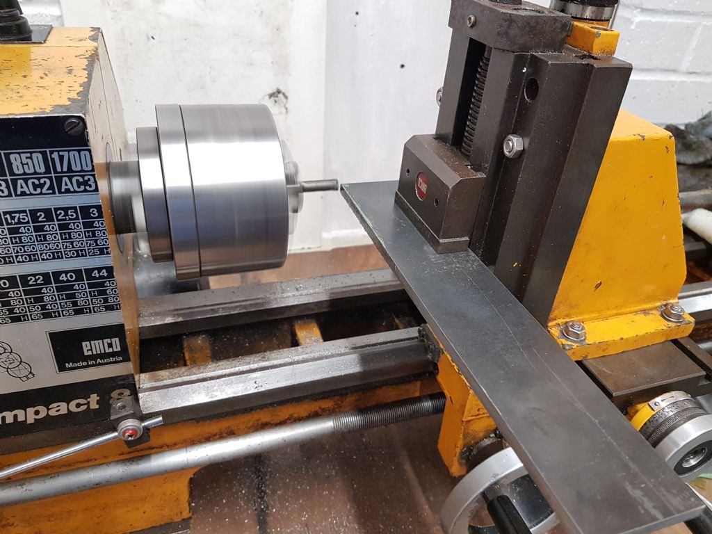

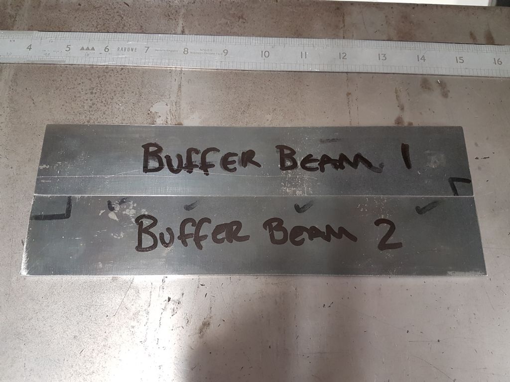

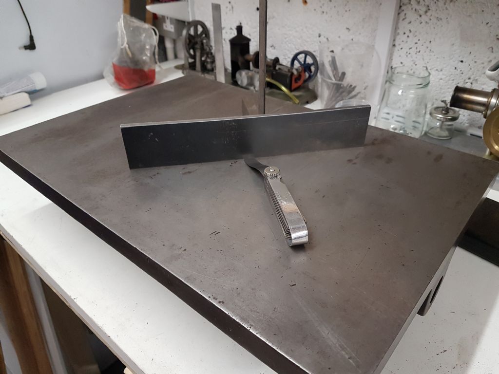

Thanks Jon. Good advice. I've not got round to fully explore the drawings yet. I've been fabricating the buffer beams again today. They are the correct size and the finish is good considering I don't have a milling machine, yet, so I used the lathe with a vertical slide and finished off shaping them by hand. Still waiting for the frame material, expecting it mid week.
I used the surface plate to check for a straight finish using a 0.0015" feeler gauge for accuracy

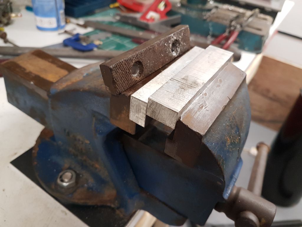

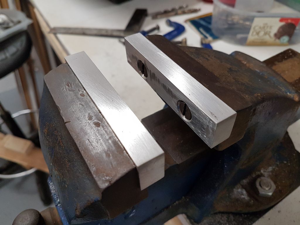

As mentioned in an earlier post, and seeing how job helped me with the photo uploading, here's the vice jaws I made out of aluminium I know it's not engine bits but I thought it was necessary so save damaging future parts 20200523_200240.jpg

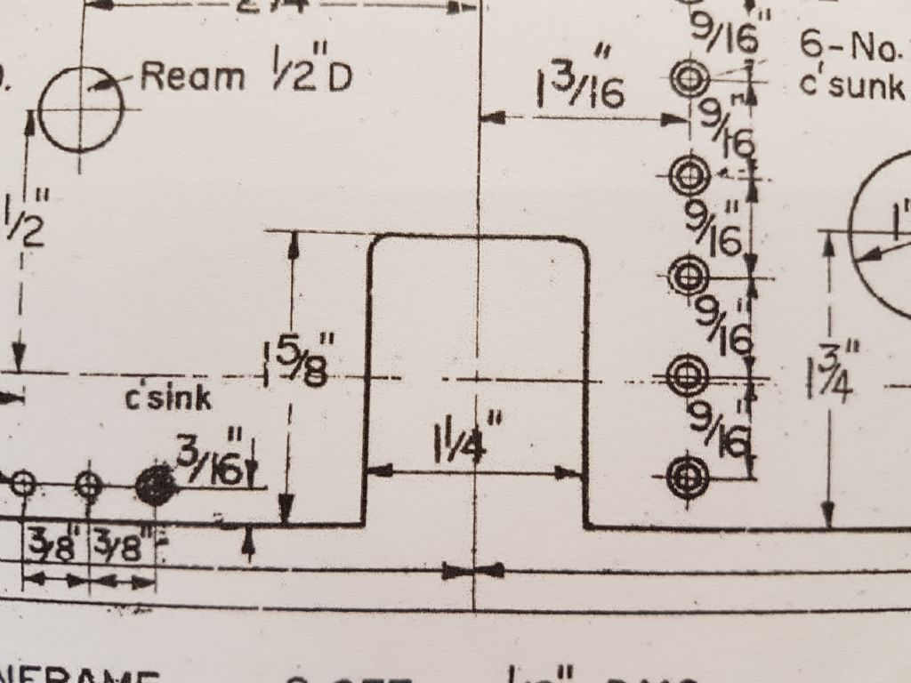

Iain Bachey26/05/2020 23:12:14
avatar
13 forum posts
11 photos

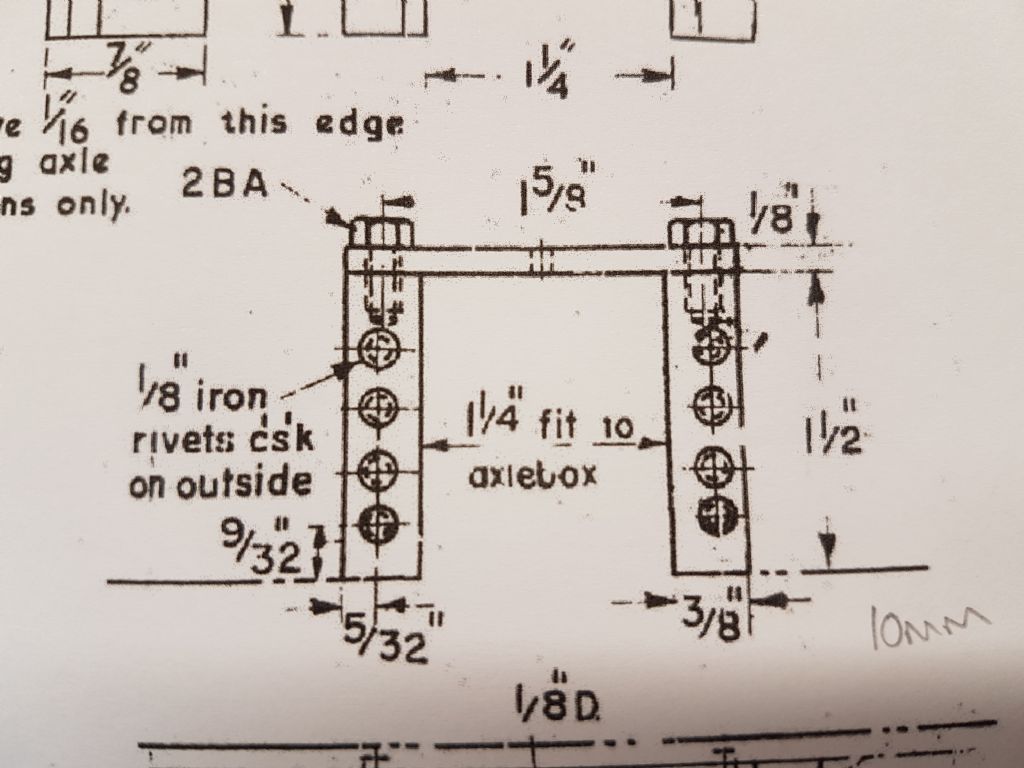

I've been having a look at the Simplex frame drawing, and as previously reported, there's a fault with the horn block dimensions. As I'm a newbie I would have just fabricated the parts as shown. Below is the area on the drawing where the reported error is. 20200526_130116.jpg
It shows the hornblock as 1 1/2" then the upper plate a s 1/8".
The next photo shows the axlebox cut out as 1 5/8".
Is the top plate supposed to be flush with the axlebox upper cut out or slightly lower, 1/8" lower?
Regards. Iain.
David Wasson27/05/2020 00:20:41
avatar
149 forum posts
43 photos
The horn blocks should be made to match the frames. Hornblocks should be 1-5/8" , not 1-1/2".

Thanks David. I'll pencil it in on the drawing. Hoping to get both frames cut out to the correct rectangular dimensions tomorrow as the material arrived today
David Wasson27/05/2020 01:19:09
avatar
149 forum posts
43 photos
This dimension is confirmed in ME Dec 1968 for cast horn blocks also. The opening should be 1-5/8" by 1-1/4".
Jon Cameron27/05/2020 09:09:43
368 forum posts
122 photos
Hi,
Yes as David says, it needs to be 1.5/8" to match the opening of the slot. the 1/8" top plate needs to have its lower edge flush with the top opening of the slot.
Id also check the hole for the oil to the axle block as I remember something not aligning there quite right. But I may be mistaken on that one, and it was how Id drawn it in CAD that caused the issue???
