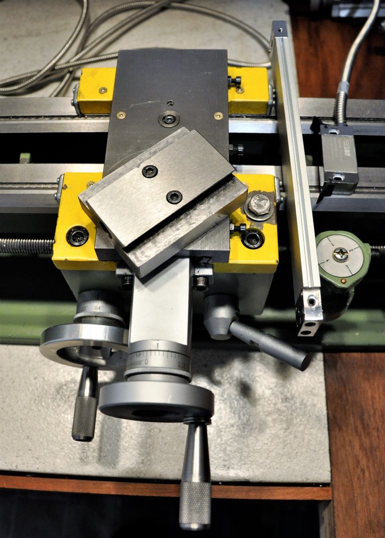

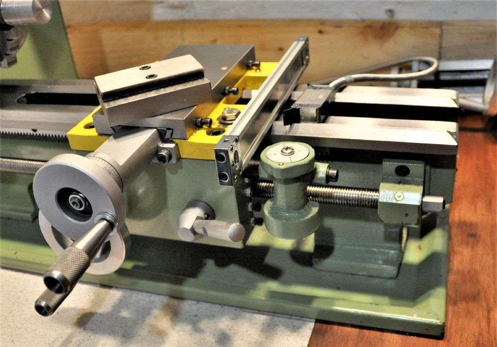

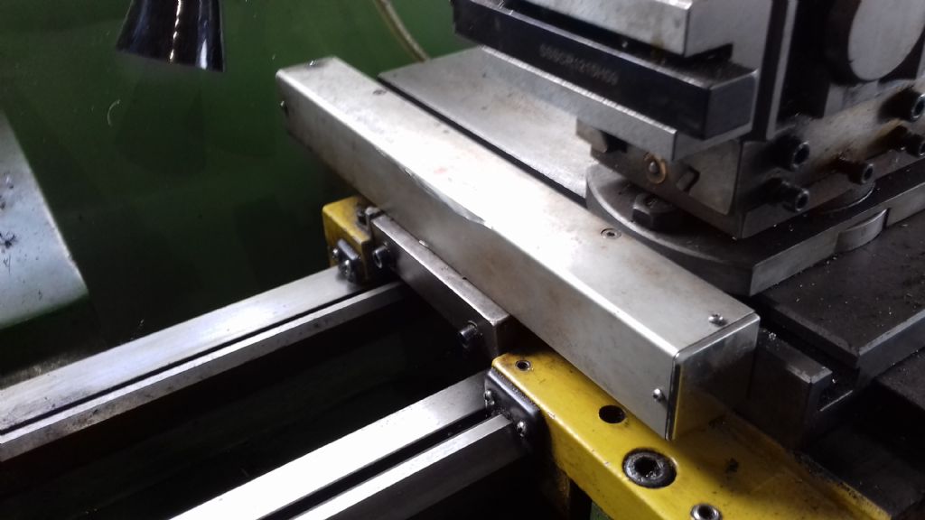

I have just taken delivery of a 2axis DRO which I intended to install on my Warco WM180 lathe, however now that I have the bits I am beginning to think that I have bitten off more than I can chew. I can see that I would need to fit offset bars and brackets to the cross slide to clear the gib adjusters, oil ports and the swing of the compound slide not to mention the carriage lock. Anyway I'm not one to give up that easily so I wanted to ask if any member has fitted a DRO to the WM180 or similar or has photos of a pre-fitted one to provoke a little thought. I have added photos to illustrate my remarks.

If you are going to mount it where you have it pictured just make sure you can get the tailstock close enough to the work particularly when turning between ctrs or drilling small holes in work that does not protrude far from the chuck or faceplate.

I fitted my scales to the right hand side of the carriage on my WM250VF but found it really restricted the tail stock for drilling. Changed it to the front of the carriage and seems to work well. Just need to watch if the chuck jaws are quite wide they can catch on the scale cover. Let me know if you need a photo of the installation. Cheers the noo.

I had just rested the scale there hoping for a bit of inspiration, although I think it would have to be offset from the cross slide quite a bit to retain access to oil ports and gib adjusters etc. I did look at mounting it on the chuck side and there would be less interference apart from as you say it would catch on a wide open chuck, but aye John a photo would be great if you don't mind. I know the reader would need a bracket of some kind because it's a magnetic scale, which could be my main mistake.

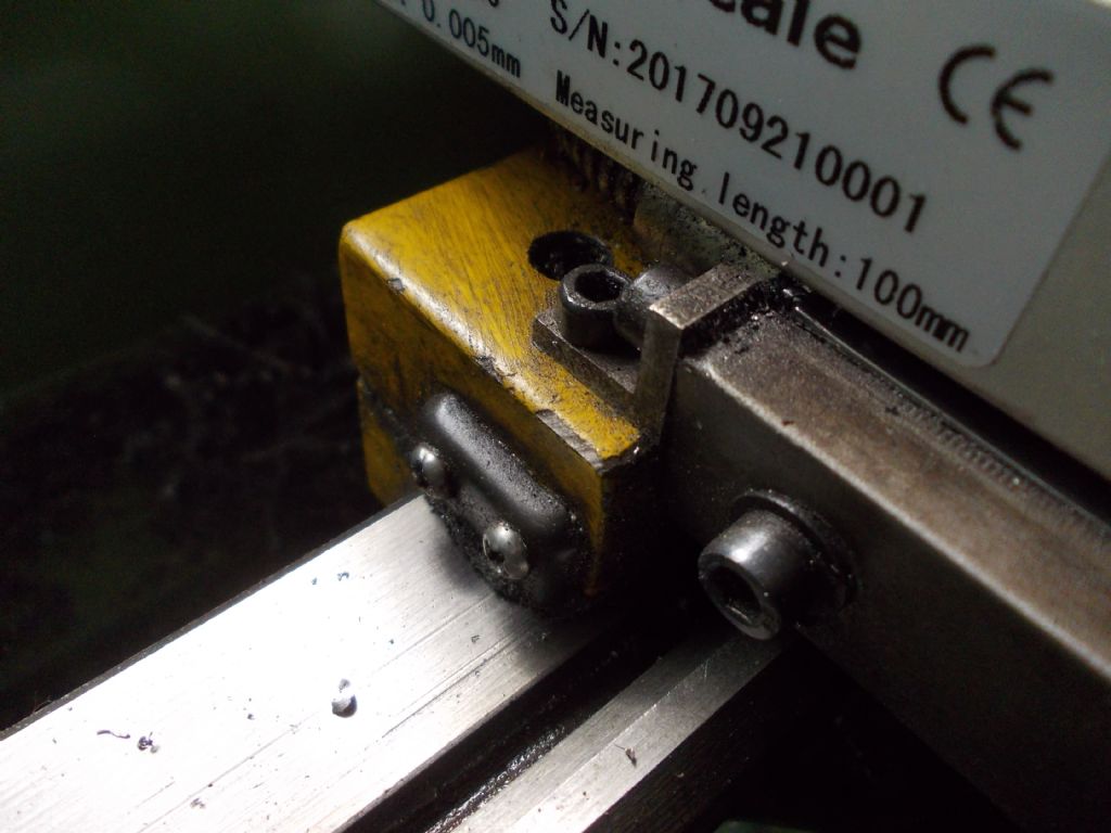

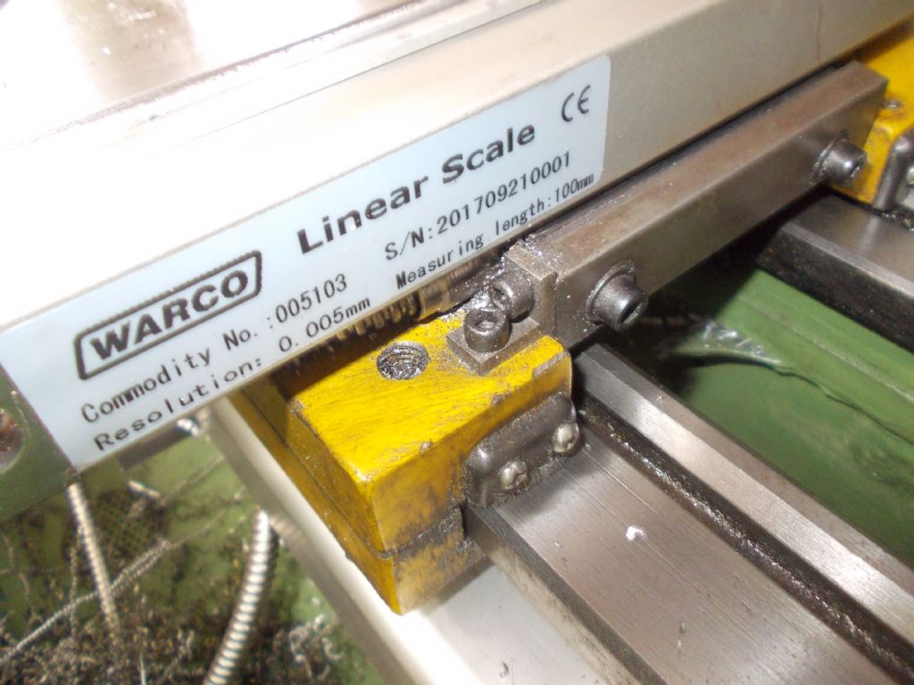

Hi Keith,
Here are a couple of photos of my set up. You can see what I mean about the chuck jaws!! a wee scuff on the swarf guard. Anything else I can help you with just let me know. Cheers the noo.

Hi Keith,
I didn't use the brackets that came with the scales but had to machine one to get the scale to fit at the front of the carriage. I'll take the guard off this afternoon and see if I can get a better photo of the bracket. Cheers the noo.

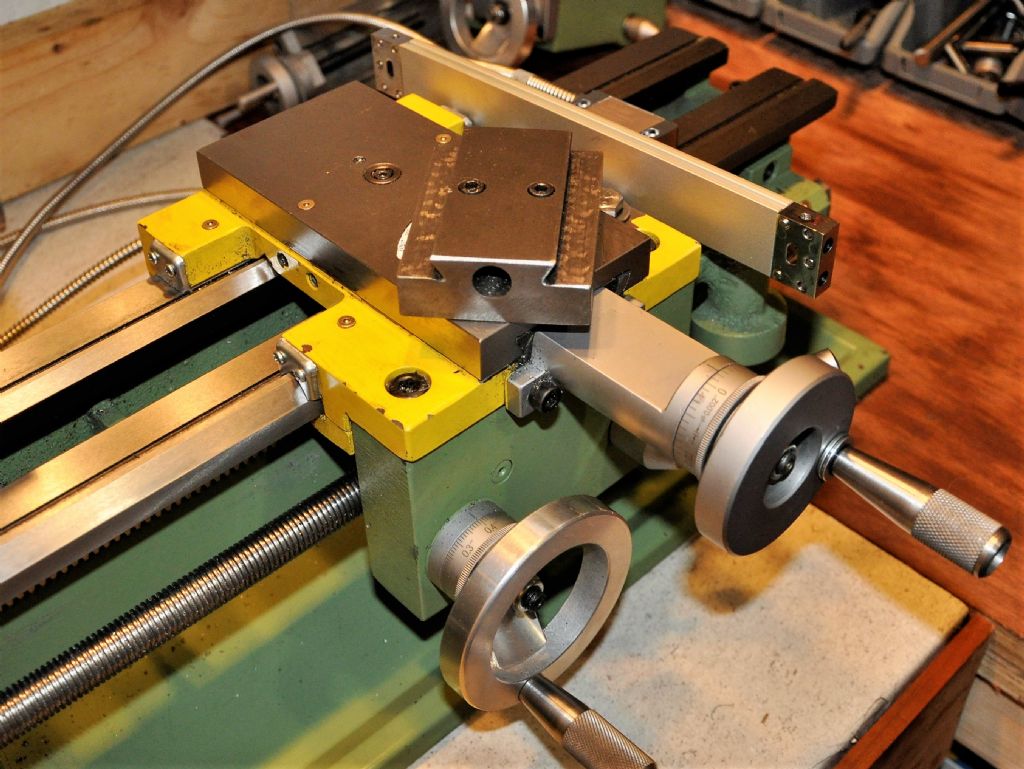

John Slaven27/04/2020 13:30:18
avatar
27 forum posts
17 photos
Hi Keith,
You can see the small angle bracket better in these photos. I know it doesn't look very substantial but I've had no problems with the scale sensor in the last 3 years. The scale itself was attached to the cross slide by drilling and tapping (carefully) There are a few Youtube videos showing scale installations on various lathes that may be of help to you. Cheers the noo.

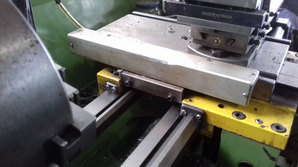

ChrisB27/04/2020 23:02:32
671 forum posts
212 photos
Posted by Steviegtr on 26/04/2020 17:44:59:
Is there room under the cross slide as a guy I saw with a myford had mounted it in the recess underneath & it was hidden from any intrusion, looked very neat.
Steve.
There's no room for a standard scale (with the extrusion) to fit under the cross slide. The way I did it on my WM280 was by installing the magnetic tape (only) under the cross slide and fitting the readhead to the carriage. Best solution imho, you can get the tailstock as close as you want to the carriage, and no fear of the chuck hitting the scale.
Nothing much to see in reality, as the scale and read head are under the cross slide, but you can just make out the cable of the read head.
