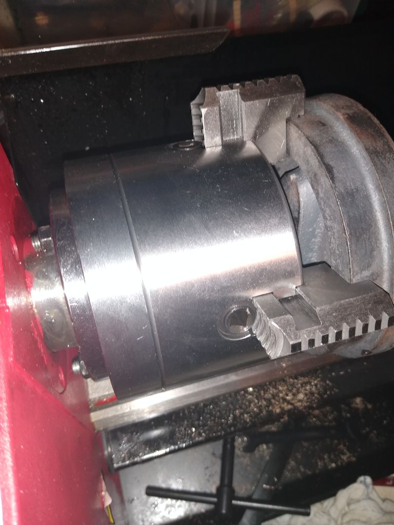

Nick Clarke 325/04/2020 10:35:01
avatar
1607 forum posts
69 photos
Here is the ARC 4 jaw and backplate just fitted onto my SC3 - it takes up some of the length between centres, but less of an issue on this lathe. The casting is a 7 1/4" Tich wheel - Just trying it for size!!

Posted by Nick Clarke 3 on 25/04/2020 10:35:01:
Did you come to the conclusion that the jaw projection was a bit too much?

Posted by ega on 25/04/2020 11:11:21:
I just wanted to see what the capacity is - I only roughly centred it by eye but it ran smoothly enough with plenty of jaw engagement and plenty of clearance over the bed. I need to practice centring things in a 100mm four jaw!
I have access to a larger lathe with backgear at the club workshop, and at my rate of working all of our current troubles will hopefully be out of the way before I need to turn these wheels (actually at my rate of working probably the next two issues to face us as well! smiley)
So unless we are still in lockdown this may not need to be resorted to - but I am confident it could be done should I need to.
The wheel by the way finishes to 4 1/2" over the flange so without measuring it, is probably about 4 3/4" as is.

_igp2582.jpg_igp2581.jpgI have just got the photo's of the modified 100mm chuck.
