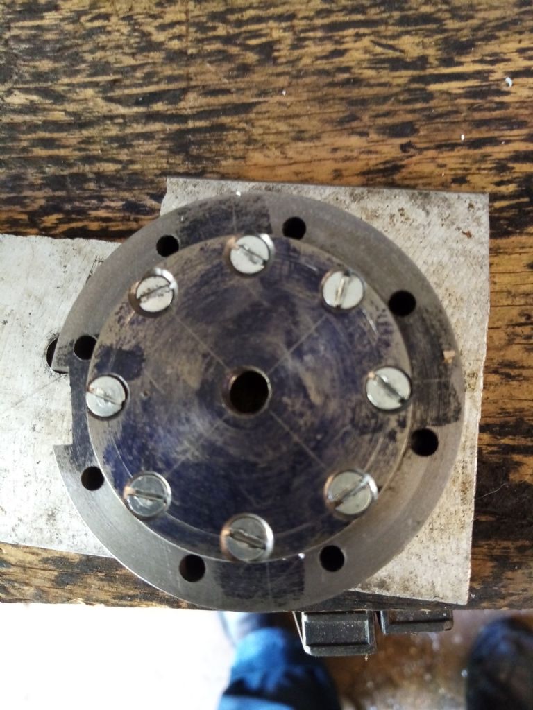

Arthur Goodwin13/05/2020 19:12:57
71 forum posts
45 photos
Hi All
Been making good use of the lockdown to crack on with my engine (every Cloud.......)
Now at the stage where I am ready to do a test build of the cylnder and its constituent parts.
It is made up of 6 seperate components all 2.25 diameter (or thereabouts)
What I would like to know is, what is the preferred gasket material for a steam cylinder and what thickness should I be looking to use.
I have scanned other forums and the variety spans from using a dollar bill to brown paper and oil
I will be including some pictures on my next post of the parts and completeed cylinder,
Regards
Neil Wyatt13/05/2020 19:20:41
avatar
19226 forum posts
749 photos
86 articles
Something thin like brown paper is good to avoid changing the dimensions too much. Instant gasket is fine if you are not expecting to disassemble too often.
Proper gasket paper can be thick enough to cause pistons to lock if tolerances are close.
JasonB13/05/2020 19:36:22
avatar
25215 forum posts
3105 photos
1 articles
I use a liquid (instant)gasket on all my engines which effectively has no thickness when assembled so you don't need to make any allowance for it, get it from the likes of Halfords.

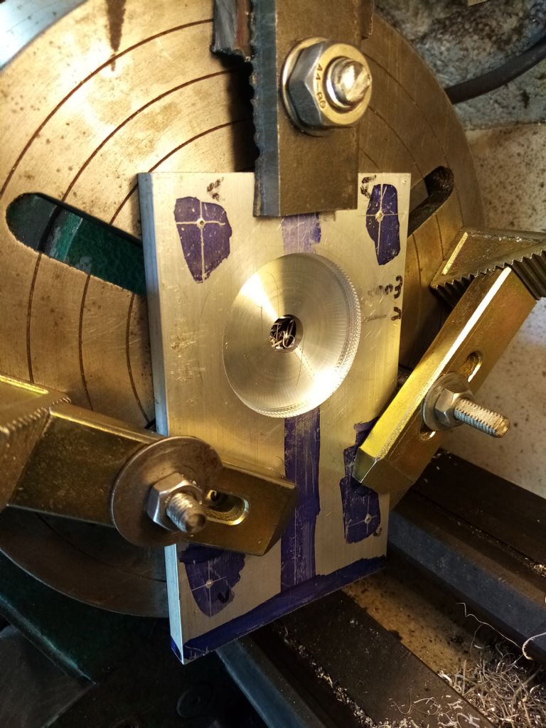

Arthur Goodwin19/05/2020 21:34:51
71 forum posts
45 photos
Hi all
Not got round to assembling the cylinder as Ineeded to prrpare the base for it.
This is were I hit a problem. The base measures 7.5 X 3.5 inches, when I mounted it to my face plate and centrslised for the counter bore, the throw was 6.5 inches and fouled the bed. My lathe is a 5 inch denford.
The only way forward was to saw off 1.5 inch.
Now looking at this with hindsight (a grrat thing) what i should have done was make the steam chest cover the same diameter as the S C and use the same bolt circle to fasten them both dowm see pics.
Any reason why Bob would not img_20200519_143218.jpghave chosen this option?
