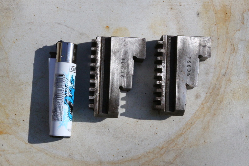

I'm after a set of outside jaws for my Pratt 1213 160mm chuck. For the price of original parts I can buy a new (not original) chuck and back plate. Suggestions?

I notice the Rotagrip price is £130.56 for the hard outside, could you get a set of the soft jaws and modify them to do the job, the EK16 are £31.63 a set.

Square Peg, what is you location ? I have a set here (if I look hard enough) I bought a new chuck when I could not afford a new set of standard jaws. The old chuck is still in the workshop, with all the variations on chucks you would need to try for fit.

OK I've found the chuck and jaws. The chuck catalogue number is 9580??1705
Stamped on the front is T03604 Stamped on the back 589 Stamped on jaws 680
Key sizes are 18mm sliding width,7.3 from bottom of scroll teeth to slot 7,3 Slot size 7mm
Let me know if of any use.

Close but no cigar! Thanks for looking. Home and Workshop have a set for a reasonable price so I'll have to bit the bullet. What's really annoying though is that I have 2 of the jaws, the third was missing when I bought the lathe.

I have an original 4" pratt 3 jaw chuck on my ml7 and I wanted outside jaws. some googling and EB gave me serious headache. there are hundreds of different catalog nos http://www.rotagriponline.com/datasheets/Pratt/PrattChuckSpares.pdf
AFAIK you really need the exact match otherwise the jaws may not fit and be a waste of money given that the asking price for spare is 50% of a new chuck with 2 sets of jaws. Not worth the risk as you cant always try it first with EB sellers.crook
Charles Stanley Gordon03/07/2021 11:44:04
2 forum posts
1 photos
Measure the existing jaws and fill in the chart, check your sizes against any new suppliers sizes. some sizes are critical, others not so important, so Jaw width/thickness, Scroll, and the groove must be the same. The steps in the jaws are not critical nor is the overall length::: ...........So,      BDEh
