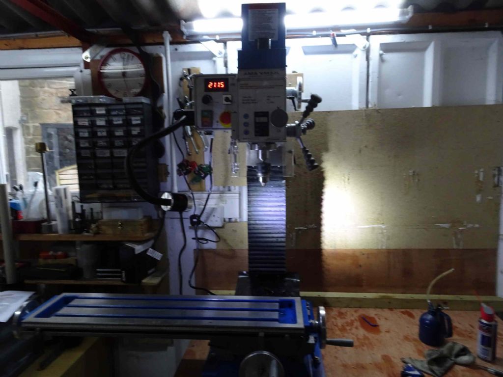

I went down to have a look at the Mill in Amadeal's warehouse in London (200 miles from home) and Hugh was helpful in showing me the options. I decided in the end to go for an r8 version with a DRO kit from Weiss to follow - he didn't have and R8 DRO in and I prefered to wait than go for an MT3 version.
The mill arrived promptly when booked and, much to my relief, the driver had a motorised pallet truck (with brakes) which made short work of the trip down the steep drive round the back of the house. I'd be dreading that.
An hour or so with a brawny young assistant and an engine hoist and the machine was inside and in-place. The installation went pretty much to plan which is not what I expected!

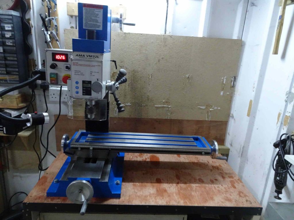

It's a big beast. The table is 840x210mm with a travel of 580x200mm (or two feet by 8 inches for you old timers). Despite what the spec at Amadeal says, the book and machine claim the motor is 1.5KW (10 times the power of my CMD10).
Here it is with the table fully to the right
and to the left

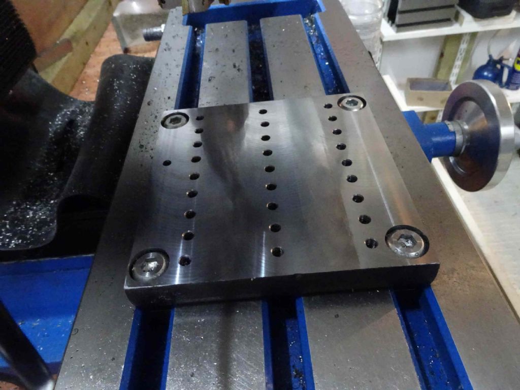

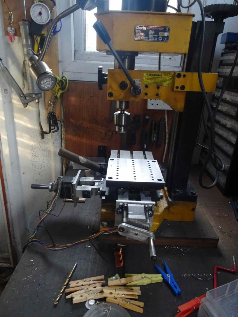

This is the final product
This is a piece of steel i bought a few years ago when I had ambitions above my station.
I clamped it to the bed and faced both sides in 3 passes (63mm face mill - the same type Jason's been playng with). This didn't work as well as I hoped as I had to move the clamps around and I ended up with some slight ridges as the clamping location and force changed. the first face was the worse and the plate clearly wasn't particularly flat.
Next I drilled and tapped the holes. There is no tapping on this machine, but I just set it to about 100 / 200 rpm, pulled down the handle and it tapped! At this point I didn't have a 6mm collet so this was in the drill chuck and spun in the chuck if I wasn't careful. I also had to be careful to hit the off button at the right time. I can see that a tapping reverser would have some value.
Here it is against the machine it is emulating
Don't know what the pegs were doing.
Once I'd completed this I used my new Coax Indicator to find the centre of the 12mm holes in the corner, and then counter drill with the (now working) 20mm mill to fit some slightly turned down M2 bolts. The Coax was snuck in as part of the New Mill budget wink.
Finally, bolt it down at the corners and take a couple of thou off in a finishing pass - 3 passes of about 2 inches width each actually. In the right light there are some mill markings on this, but I think this is more to do with my uneven turning of the handles. A power drive is on my todo list. What I found quite extraordinary is that you cannot feel the lines where the passes intersected. Which says to me that the front back tram is rather good. The face mill cuts mainly on the left hand edge so I think that there is a bit of rotation I could take out, though frankly, I doubt my ability to improve in much beyond what i came like.
I also made some T nuts with an M6 hole so I could use some of my existing clamps

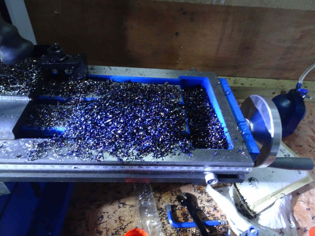

I mentioned the finish above. The worst finish I've managed so far is better than pretty much everything I've done on the CMD10.
Oh - one of the downsides of this marvellous thing is the tidying up. I've had to significantly re-arrange the shed to fit it in, which means I have things (collets, clamps, hammers) better to hand, but the damn thing moves metal some much faster, I have to tidy up after every session, or it would drown!

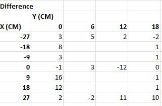

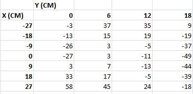

The challenge today was to work out how accurate the mill is. This in terms of the table and tramming.
The results were not entirely as I expected.
I took two sets of measurements. The first was to measure the height (more or less) below the spindle at 7 x 4 locations on the table.
in the X Axis that's 27cm, 18cm, 9cm to the left of centre and the same to the right (+ the centre of course) and from near the front at 0, 6cm, 12cm and 18cm towards the back.
The indicator was a compac micron indicator and the the indicator pin rested on a 6mm slip gauge, like this
This being 27cm to the left and 12cm back.
having run round these 28 locations, I then ran round the outside and through the middle to see how repeatable the measurements were.
I took the measurements and converted them to an offset from an average height
for some reason the very back of the table i rather low (that's a hair under 2 thou) and the right front corner a bit high.
The short form is that everywhere is within 2 thou (50 microns) of an average height and the middle and left of the table (if I ignore the back row), is more or less within one thou of an average.
I think that's probably reasonable, but would value input from more experienced machinists!
The next thing is to see how repeatable this measurements are. This image is the difference between the detailed measurements and the round the figure of 8 measurements.
Bearing in mind that that's in microns, I think that's pretty good in terms of repeatability, given the conditions were not exactly temperature controlled (outside shed with a fan heater!).

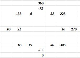

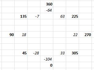

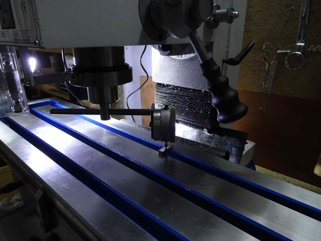

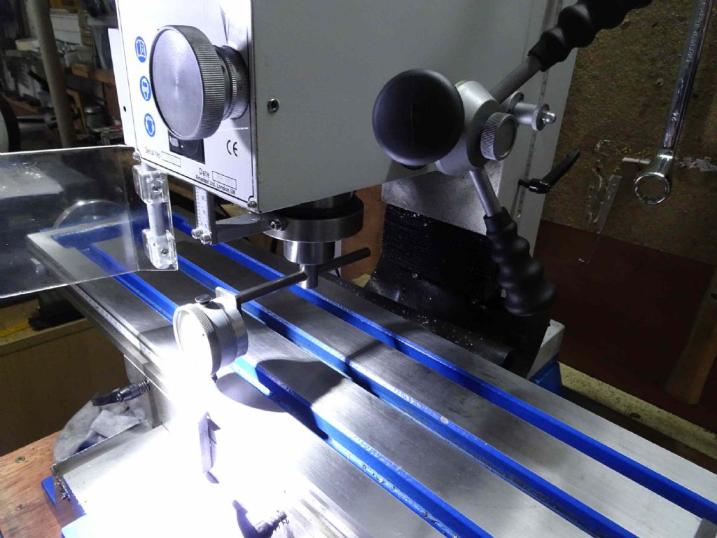

So what about the tram?
This is where I got a bit confused. The same set up was used as above, except the indicator was slid out from the spindle.
Same principle again - indicator needle resting on a slip gauge with readings at roughly every 45 degrees. I was making no attempt to be particularly accurate with this, but I did go round twice and the readings were mainly within a few microns. The indicator needle was roughly 9cm out from the spindle centre making the diameter about 180 mm.
This is the circle (sorry - you will need to use some imagination here).
so the left right tram looks good - 4 microns across 180mm sounds fair. Front, back is not quite so great with a lean of 40 microns in 180mm. You could move the front measurement up by up to about 10 microns or so, by pushing the column back (fairly hard). I honestly don't think I would make any attempt to improve this. except maybe by tightening up the rear bolts on the column - even then.
BUT. What I don;t get is how the 45 degrees settings are just wierd! Granted these were all taken with the slip gauge across the t slot, but still. Also I can't work out how we can have a circle with the height values at 0, 90, 180, 270. That's a saddle!
Interested in thoughts here.

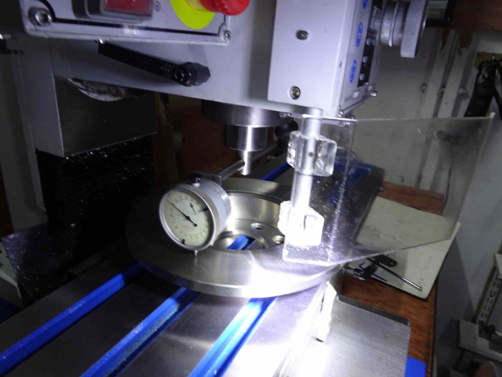

Finally, I got out a disk brake I bought a few years ago for when I had to do some tramming - as it's meant to be pretty flat and tried that.
With results as below
Not quite the same results but a similar saddle shape.
Any comments would be welcome.
Iain
Edited By Iain Downs on 07/01/2020 20:13:50
old mart07/01/2020 22:01:38
4655 forum posts
304 photos
The weight of the indicator is a factor when you are working in microns.
You can eliminate errors with the brake disc by rotating it 180 degrees. It might work better if the main diameter was down instead of the boss. The faces could be checked with a micrometer for any thickness deviations.

Iain Downs11/01/2020 19:52:48
976 forum posts
805 photos
Thanks. Mr Mart.
I don't think that the weight of the indicator is affecting this - it's pretty much the same all the way round the the circle.
I did try rotating the brake disk by 90 degrees and testing at 20 degree intervals. However, the results make me think I need to do some more measurements.
I tried wobbling the disk (pressing up and down), but the readings only varied by about 5 microns.

T slots.
in this machine the T slots are painted. Presumably to prevent oxidation (as you can't get to them to clean as easily).
However, this means I can't use the T slots as a baseline for lining up work pieces or vices.
Does the paint really give an advantage? Should I strip and if so, what stripper would work?
Iain
Edited By Iain Downs on 12/01/2020 10:13:01
Andrew Johnston11/01/2020 20:51:27
avatar
7061 forum posts
719 photos
Posted by Iain Downs on 11/01/2020 19:55:13:
That seems a daft, and expensive, thing to do! Never seen it before. Many cheapo clamping sets contain a T-shaped blade. That, combined with a dirt cheap small paint brush works fine for me when cleaning. Every now and again I'll push a scrunched up kitchen towel down the slots to clean out very fine swarf.
Andrew
