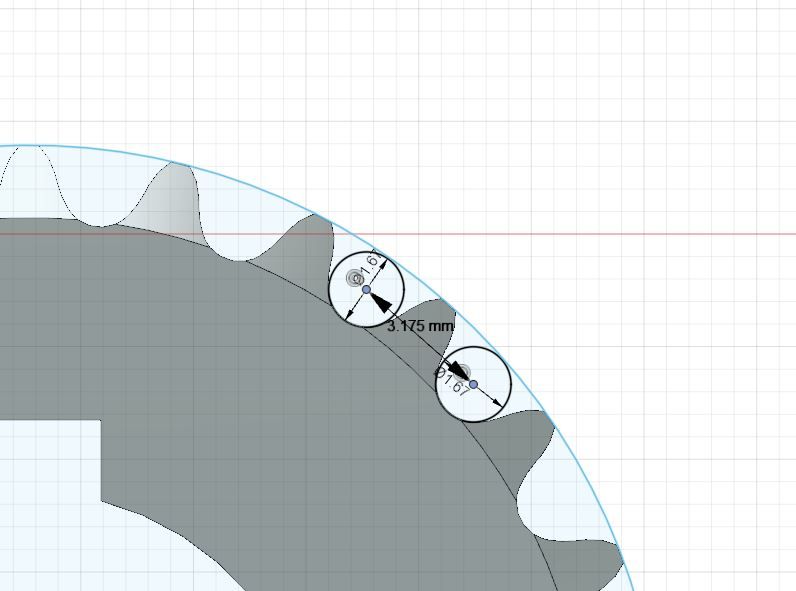

Hi I have a need for some tiny sprockets, but I cannot draw them as not sure how to draw the teeth!
The chain roller is only 1.67mm in diameter, the roller pitch is 3.18mm 28 teeth; 6mm center bore.Problem is when it is rotated there seems to be error... sprocket measures 30.22mm od over teeth... the small sprocket is 12 teeth! Any help please! Thanks vic

Hi, Vic.
Note that the roller pitch is a straight line, not a circular pitch like the distance between gear teeth. So the 'pitch circle' is a polygon with the same number of sides as the number of teeth, not a circle.
As each link 'unrolls' from the sprocket/chainwheel, the centre of the 'unrolling' roller generates a radius with respect to the roller still on the chainwheel. As the next link unrolls, the radius changes, but I think this is not important, as the rollers are held in the root of the sprocket by the tension. No doubt someone will come up with a specification.

JasonB05/01/2020 20:05:52
avatar
25215 forum posts
3105 photos
1 articles
Easy way is to import a cad file from a sprocket supplier and if they don't do 1/8" pitch then scale to suit.
this is a 28T 1/4" pitch Macmaster Carr sproket scaled 50% and I have added the two 1.67mm pins and measured the distance to show it works.

vic francis06/01/2020 09:17:38
125 forum posts
21 photos
A big thankyou to Bill, Ian, Michael and especially Jason, 👍. I really appreciate your answers, I had no idea. I look forward to experiment...

JasonB07/01/2020 20:39:20
avatar
25215 forum posts
3105 photos
1 articles
I would assume that offset is half the diameter of the cutter. But it would need to know number of flutes, feed rate and speed as well as any roughing cuts, finishing cuts, etc as you would not want to try and cut full depth and width with a 1.5mm cutter in one pass!
I did generate the code last night in alibre doing a facing pass over the top, drilled each at 1.6mm then adaptive clearing with a 4mm cutter and finally the contour with multiple passes so as not to overload the small 1.5mm cutter.
Watch that 3.2mm pitch, should be 1/8" or 3.175mm
