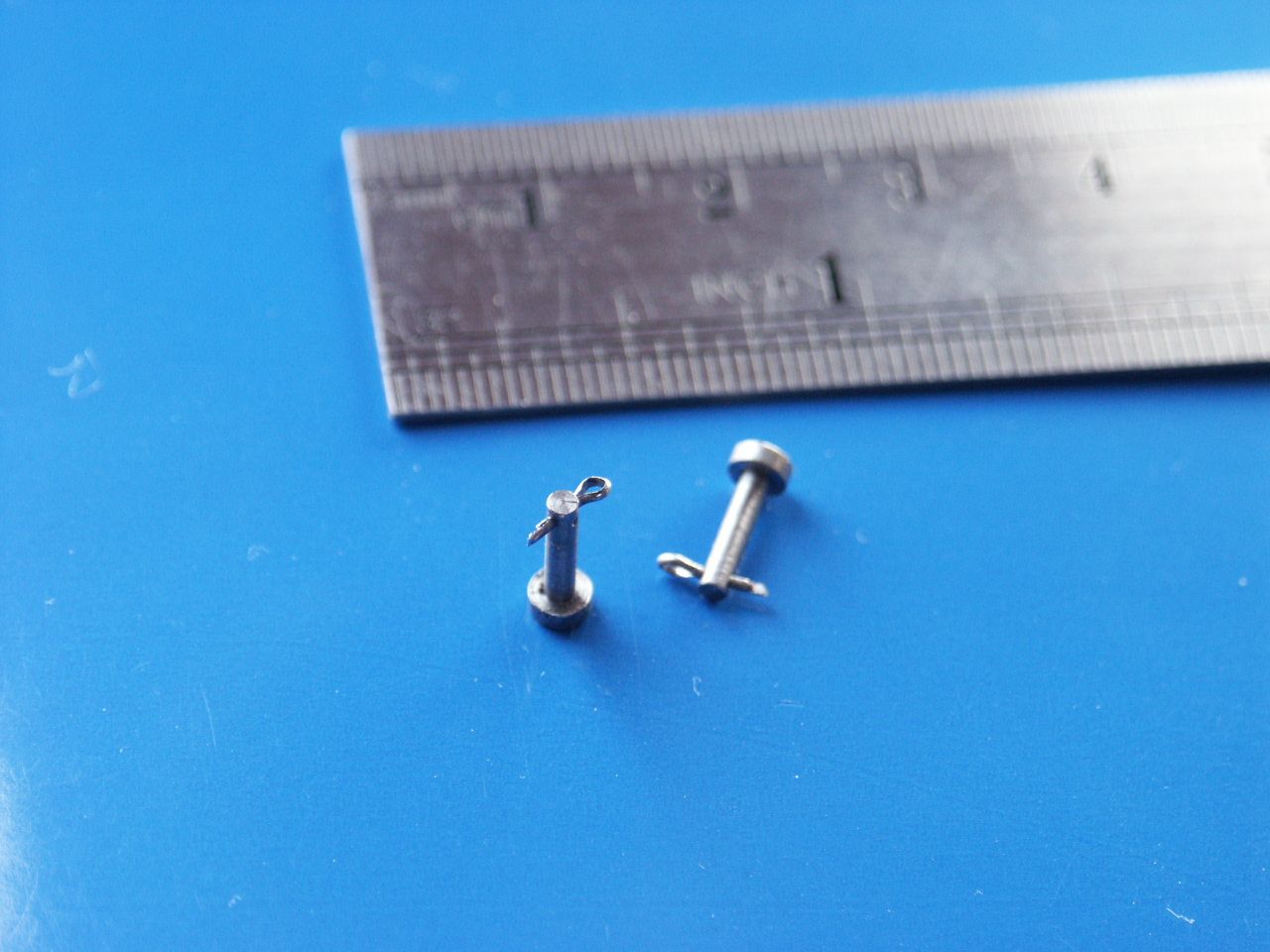

I have been making some M3 castle nuts which will require split pins when fitted.
What is the preferred method to make tiny split pins

Well you could by 1/32" ones (0.8mm) which is about right for a 3mm or 1/8" shaft from the usual ME suppliers
If you want to make your own then in the past I have filed 0.5mm steel wire down to half thickness and then bent to shape. A shallow Vee milled into some flat bar holds the while while you file it.
Finished job through 1/16" diameter pins

Thanks , I did not realise you could buy them that small . That said I think mine will need to be
a little smaller than 1/32 so I will get some wire.

One trick that I have used is to cut a length of wire and hold it under tension in a piercing saw frame. You can then draw file the wire to the required section before cutting and forming.

you can by smaller still if you look for them on ebay. type in split pin and all will be revealed. Done it myself a year ago. cheap as well
