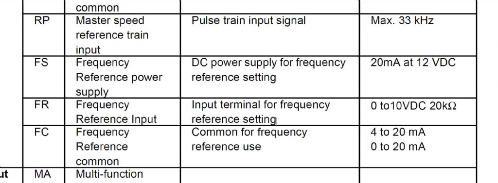

I bought a second hand Omron Varidrive V7 frequency drive, and wanted to hook up an external potentiometer.
The online manual is very technical, and not written in a very accessible language, but i have found out that i have to connect the pot to three terminals. FP (frequency reference power supply- 12v 20ma), FR (frequency reference input 0-10v 20ohm impedance) and FC (0v common).
Since i'm out of my element, i'm bit confused that the FP terminal supplies 12v, but the FR terminal uses 0 to 10v as reference voltage to regulate the frequency.
They call for a 2K-ohm pot at 1/4w minimum as the analog regulator, so should i put a 500 ohm resistor in series with the pot, at the 12v side, to limit the voltage to 10v? (i don't even know if my maths is right, or really what i'm talking about )
The diagrams don't show this - only the 2K pot, but the descriptions are very vague, so supposedly this is something i should know in advance, but i don't .
On many of their other drives the reference power supply is 10v, but not on the V7 series.
I'm not good at this, and all i want to do is have a knob that can regulate the speed of my machine, without having to get a degree in electrical engineering .

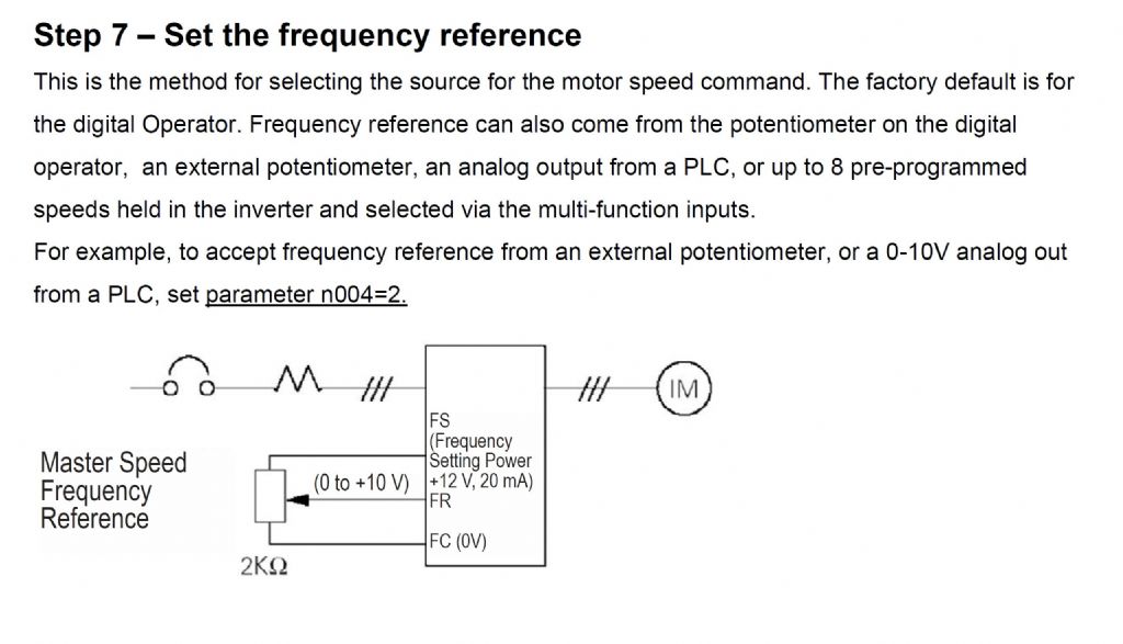

David Jupp13/12/2019 13:17:46
978 forum posts
26 photos
Diagram at bottom of page 65 of the manual shows how to wire it.

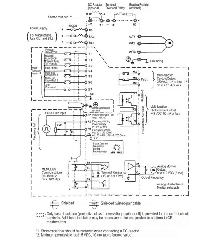

Thank you for looking that up David, and taking the time to respond i believe you are referring to this diagram:
I may not have been clear enough in my worry. As a beginner i see something that says it needs 0 to 10v, in this case the FR terminal, i start to question myself, before using a12v supply. Even with a potentiometer, i am regulation the voltage between 0 and 12v, not 0 and 10v.
I don't know if this over volting has adverse effects, or if the only side effect is, that the last sixth of a turn on the 2K pot, will be a "dead zone".
I might be overthinking this, but it seems very odd, that three terminals that are meant to interact has different voltages. On every other VFD i have seen, the frequency reference power supply voltage has been 10v, not 12v, so i thought i might have gotten my hands on some fancy VFD, where it's common knowledge that you are supposed to put a resistor in series on the 12v side before the pot, to get the 10v, since these terminals also can receive a signal from a PTC.
Here is the complete diagram of the VFD:

Hello Dave, and thank you for your kind reply. I was writing my previous post, while you were posting, so that's why my answer might have seemed odd.
You are indeed right that i misreported the impedance - it is indeed 20k-ohm. I don't even know precisely what impedance is in this context, and what effect it has.
I am ashamed to admit i don't even understand the calculator you linked to. I came to 500 ohm by thinking i would connect the resistor on the leg of the pot, that receives the 12v signal.
So my maths was as follows. I want 10v with a 2K pot, so I=E/R.
10v/2000ohm=0,005amp
I want to lose 2v, so R=E/I
2v/0,005amp=500ohm
But i'm sure your calculation is correct. I will see if i can get my hands on a 390 ohm resistor.
Clive Foster13/12/2019 14:15:01
3630 forum posts
128 photos
Peter
Way, way overthinking things.
When you use an external 10 V analogue input to control the VFD setting parameter n004 = 2 will also re-scale the input so 10 V is maximum speed. I suspect the external analogue control is actually a current loop rather than voltage.
When you use the on board 12 V source and potentiometer as per diagram maximum speed needs 12V, ie pot right at the end.
Presumably 12 V is provided to ensure that 10 V can be provided if the VFD is a master source for a current loop control despite some voltage drop over the wiring. I guess you'd select a suitable series resistor in that case.
Clive
Edited By Clive Foster on 13/12/2019 14:16:10

Norfolk Boy13/12/2019 15:21:35
74 forum posts
18 photos
I think Howard is correct, it is a simple voltage divider and the pot value can usually be about 2k - 10k ohms as it's job of division is all that is required. The 12 volts I believe is a red herring. (I have a Yaskawa and have no issues. I think where some of the confusion is coming from is that the analogue input can be used as a current measuring option instead of voltage reference. The reason being a long input cable may be subject to voltage issues through volt drop or interference wheras current is much more stable over distance. There will be a parameter somewhere to set this but voltage is usually the default.
Alan

Peter Graversen13/12/2019 15:41:06
6 forum posts
3 photos
Thank you Norfolk,
Yeah - i'm feeling more and more sure, that the 12/10v thing is a non-issue. I actually JUST got an answer to an email i sent to Omron 4 days ago, 1 minute ago, and they were pretty laissez faire about it, just saying: Don't worry about the 12v, and just use a 2K resistor.". Thanks i guess .
The mechanical side, like hooking up SPDT switches etc. i'm comfortable with, so now the potentiometer crisis is over, i'm good to go .
