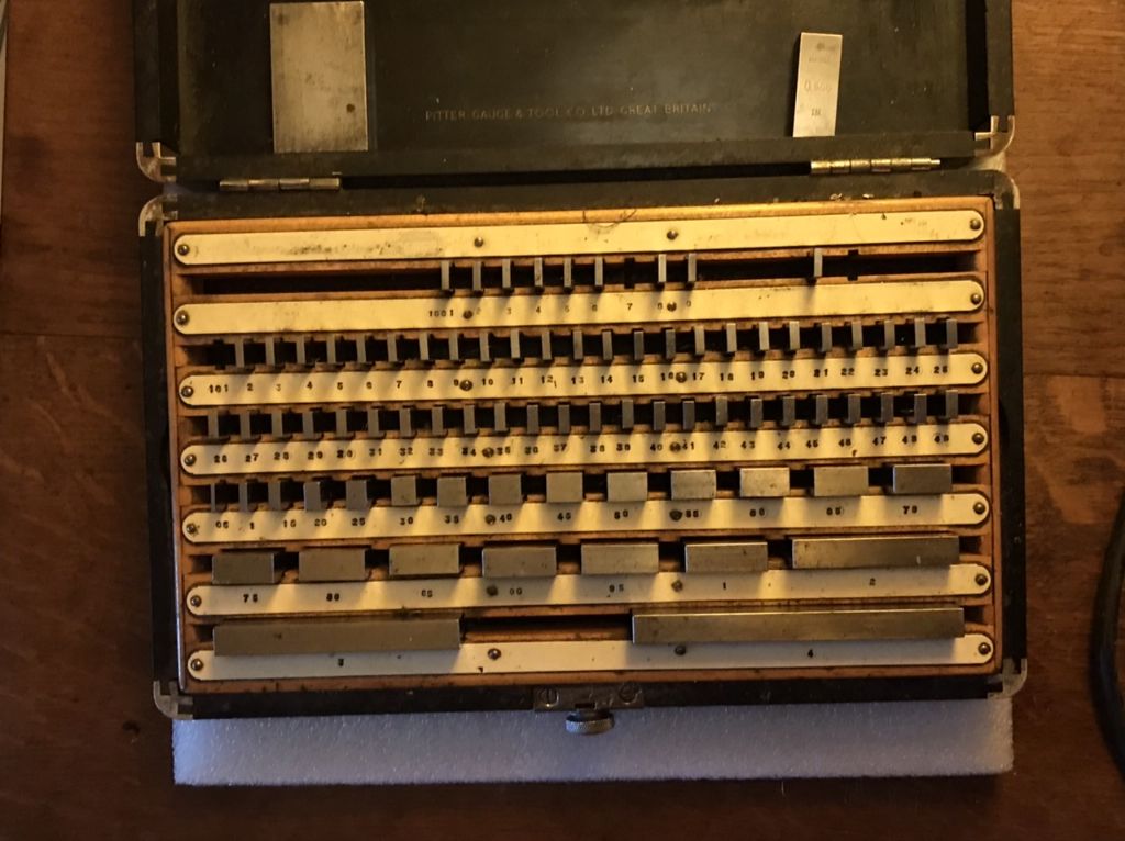

I just bought a Pitter Gauge & Tool Co. set of imperial slip gauges. Fair condition, I think, but there are a few questions - even after checking out a few videos.
There is no indication of grade, so would I expect that these are ‘workshop’ items?
There are seemingly spaces in the box which were not occupied (the 0.1007 slot was occupied by another slip) there being one piece (a 0.10075 slip) in amongst the four figure row (in the 0.1007 slot).
What should be in the two top row far right slots? Wear pieces? There is no indication in the box as to those slots contents.
I am wondering if there should be a 0.10075 slip included in a set such as this? Should it go in one of the unmarked slots? Or should there be another five figure slip included?
Are individual slips available for these older imperial sets? I did see one recent US video which centred around an imperial set. Nothing on epay.
Does anyone have a 0.1007 or 0.101 spare they would like to find a new home for, simply to complete the set? I, so far, have not really needed the precision/accuracy afforded by a set like this!
There were two extras in the box - an unbranded 2” (which likely belonged to a micrometer) and a Matrix 0.550 slip. Is there some abstruse benefit to having these particular ‘spares’ in the box or are they simply taking up space and potentially just rattling around.

It didn't start life with that 0.10075" slip, but I wouldn't worry about 1/2 of a tenth of a thou, half a thou is a much more realistic measurement for the real world. Anyone who says that they work to 0.00005" is either a liar, or delusional.
Sets of slips usually have a pair of 0.1000" wear slips in them, or the metric equivalent metric size.

Yes, I have since found the set is a ‘bitsa’. There are Matrix slips in amongst the set. I will not be worrying about it unduly and a thou is generally more than close enough for anything I do.
This set was too good to leave on the table. The five figure slip needed my wife’s smart-phone microscope attachment to be able to read ‘Matrix’ on it.
One thing, so far, is that every slip I have compared with my old mitutoyo digi-caliper has indicated with spot on agreement. Good to know the caliper is accurate.

Looks like a very useful set, it would be nice to complete it, and It probably is a 'workshop' set, I would expect an inspection set to be complete, because they are usually used in a controlled environment.
And I agree with Old Mart working to four decimal places (in imperial) is more than good enough for anyone in the home workshop, handling freezing cold gauge blocks with warm hands will drive anyone round the bend chasing a fraction of a tenth of a thou!
Intermediate sized blocks may be in the set to help cope with the imperial fractions that don't express well in thou or tenths. For example 7/64" = 0.109375"
Not sure imperial sets were ever completely rational. Some come with blocks that only deal with tenths, others have extra blocks covering a few or several common fractional sizes as well. I guess what was in the box depended on the purpose for which they were bought, probably in hope of saving time or money. On top of that old sets likely have chequered histories, with blocks being lost, replaced, or mixed up over the years.

I can see that may have been a good enough reason for it being there. Doubt if that precision will make much difference to my machining, but the set did become available after the death of a very well respected engineer who would quite possibly have attained those sort of accuracies. This, of course would require an extra level of precision for all the rest of the slips as the original set were only a ’four significant figure’ set in the first place.smiley
So now down to just a couple of questions as I could (if I was minded to) make up all the half splits using that fifth figure if the 0.1007 were present, by using an extra four figure slip (for larger measurements than 0.2007?)
Outstanding, is about these ‘wear slips’ - are they usually 0.1000 (ceramic slips would clearly be best for that?) and availability of spares (again the US seems to be the only place that still uses imperial slips!).

The two vacant spaces top R H S look as if they are intended for the two 0.1" Protective slips.

Hi I was lucky enough to find a complete set of imperial Pitter Jo blocks labelled inspection grade and in visually good condition, in the same box as the OP's. Howard is correct, those two spaces would have contained two 0.100 protective slips.Amazing what people sell at car boots, although it was in rural coastal Dorset!
