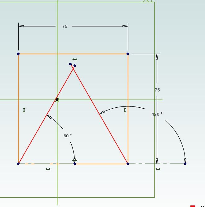

How would you go about establishing marking out lines on a piece of stock 3 inches square to achieve biggest equilateral triangle. Thanks

Draw 60 deg line up from one corner then a 60 deg line from opposite corner, two lines will meet about 10mm down from the top.
EDIT you could actually get bigger by tilting the base side

Taking that a bit further.
So if stock is a square, or you have a square marked out.  Start in one corner - draw 2 lines at 15 degrees to sides of square, join the points where these 2 cross the other sides to make 3rd side of triangle..
Or set callipers/compasses to 3.106" ,  start from one corner of square, where compass arc crosses sides of square gives other 2 corners of triangle.

You can get a bit bigger triangle by rotating it about one apex (not sure if that is the right term but one corner) , don't ask me how you would set it out except by trial and error.

Simple geometry, for a unit square the side of the largest equilateral triangle that can be inscribed is:
2*SQRT(2-SQRT(3)) ~ 1.0353
and the angle is 15 degrees as illustrated by David.

Hi, if your piece of stock isn't exactly square on any corner or if it is longer one way and you don't do cad, you can draw a square on a piece of paper that will fit onto your stock and mark the 15 degree lines off with a protractor and then cut the triangle shape out and glue it onto you stock and follow the edges to cut it out.
