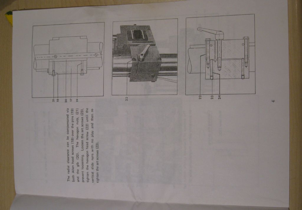

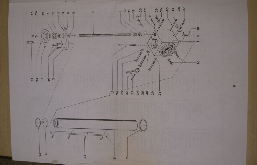

I have 3 FB-2 mills and have no problem with any, within the limits of such a structure..
The key is to ensure the various adjustments are well taken care of. You will never mill as heavily with Z axis motion as you could with a dovetail column mill. Likewise, in X and Y, you need to lock the head on the column when taking heavy cuts.
In the first picture you can see the vertical head Gib - item 20. This must be really well snug in the slot, up against the vertical key. Also, the sequence of setting the screws is important
page 2 shows the gib again (item 5) and all the setup screws.
It is also very important to ensure the two hex screws in the column support ( the base part) are well tight to ensure the column cannot rotate.
If you cannot read the text on page one, PM me and I will scan the pages and send them via email...
Joe

I did make some adjustments to the gib and the hex screws today. However I think after reading those instructions I will look at it again tomorrow.
I did initially have a problem with the column rotating when doing the vertical plunge. It shifted the head about 3mm which I could not move back without loosening the column. The side way forces from the slot drill plunge are really quite high, much higher than an endmill traversing. I have tightened the column and it is the vibration after that which I am asking about.
I have some more slots to cut tomorrow so I will see if the column adjustments have improved it.

I am not sure I agree with all the deriding statements re a round column mill. It IS less rigid than a decent dovetail column, but the limitations are very easily endured IF the mechanical setup is properly adjusted, as for ANY dovetail arrangement. Any loose adjustment anywhere critical will show up on any type of mechanical arrangement. I have 3 Emco mills now for over 25 years and if you might care to take a look at my albums you may see a large variety of work having been successfully executed on them. One of the three has been converted to full CNC with ball screws, and has milled full 3D work, with CNC motion in Z, of course requiring that the head can move up and down freely, aligned only by the properly adjusted slide screws and the gib. Granted, I do not do the type of Heavy Steam Generation work such as Jason does, but milling 25mm deep dovetails on phosphor bronze, with a 75mm diameter dovetail cutter is a doddle.
So, Adrian, do not let the naysayers put you off! Unless there is fundamental poor mechanical workmanship in the fit of your mill's parts, correct setup will give you a machine that is a pleasure to use, within its size limitation.
Regarding the 8mm slot drill - repeat the test before doing ANY adjustments and when the head 'vibrates', try to see where the motion takes place, ie, is it the column itself rotating in the base, or the sliding head on the column.
If the base/column junction, snug up those two hex bolts in the side of the base and try again. If not the column, then fasten up the vertical slide clamp, maybe slightly over tight, and try again. It the problem is mostly gone, then you need to do those adjustments as in page 1 of the pics.
Note also that rigidity on these machine does get worse the higher the head is raised..
