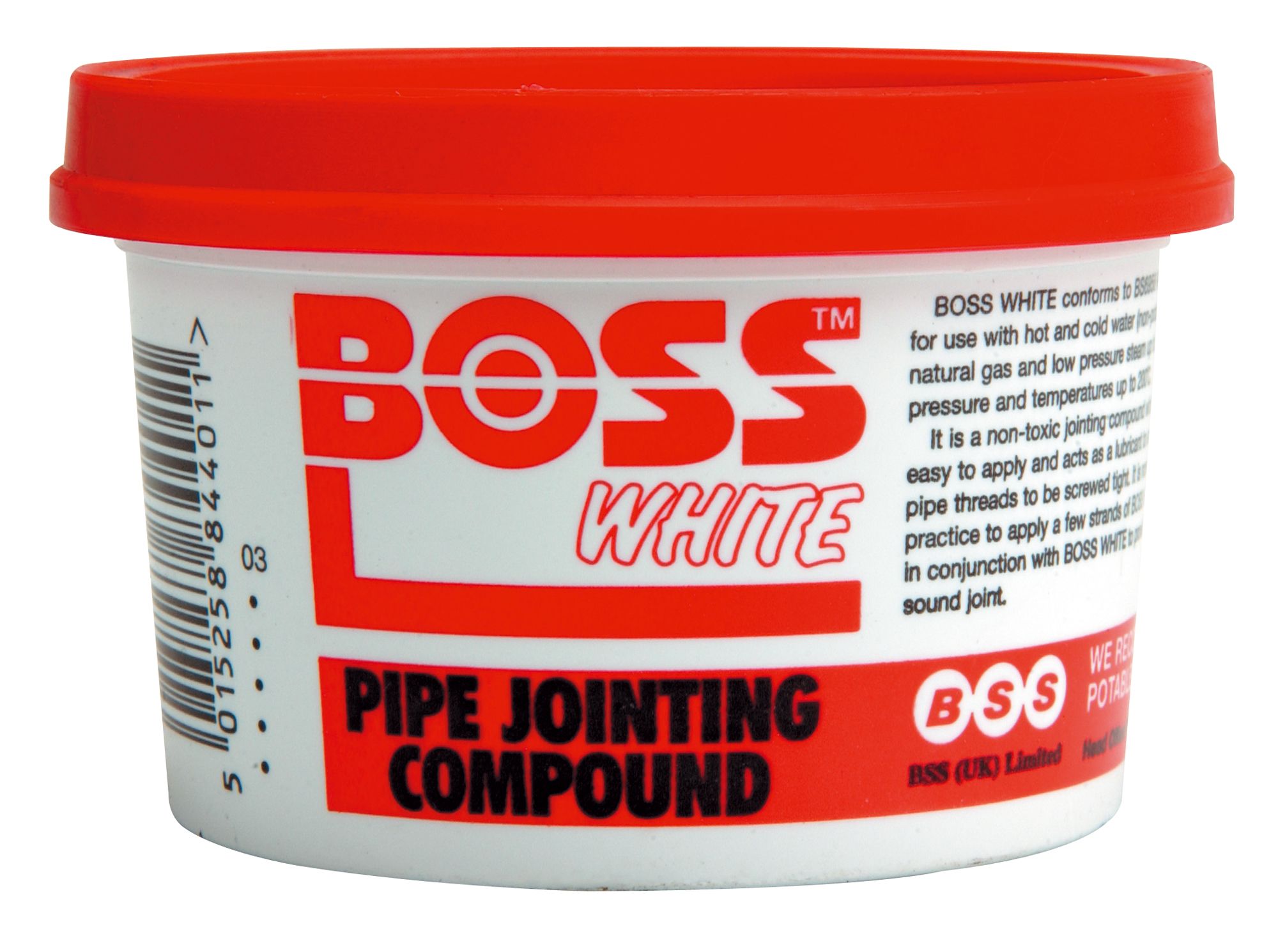

In the latest issue of Model Engineer, issue 4612, Martin Gearing is running a series concerning the ME vertical boiler ... he mentions the use of a thread sealant for use with propane gas ... please could Martin (or anyone else ) tell us the name of a suitable product ?? ... hopefully I can buy it at the local plumbers/builders merchants.

A big pot of Boss White from B&Q will set you back £4. Good enough for LBSC...
"This jointing compound from Boss is suitable for use with hot and cold water (non-potable duties) natural gas and low pressure steam up to 7 bar pressure and 200°c. "
www.diy.com/departments/boss-jointing-compound-400-g

To Neil please ... I will try to send another thank you for the information you sent ...my reply appeared on the screen as edit post ... it has now disappeared ... I was just checking to see if anyone else had answered ... I have just been to our local B and Q to buy some ... they do not list it any more ... thank you again for the information ... I will keep hunting.

Have you got a Toolstation near you or a traditional plumbers merchants, both should have it or another similar make like Fernox or Laco which your local Screwfix should have
