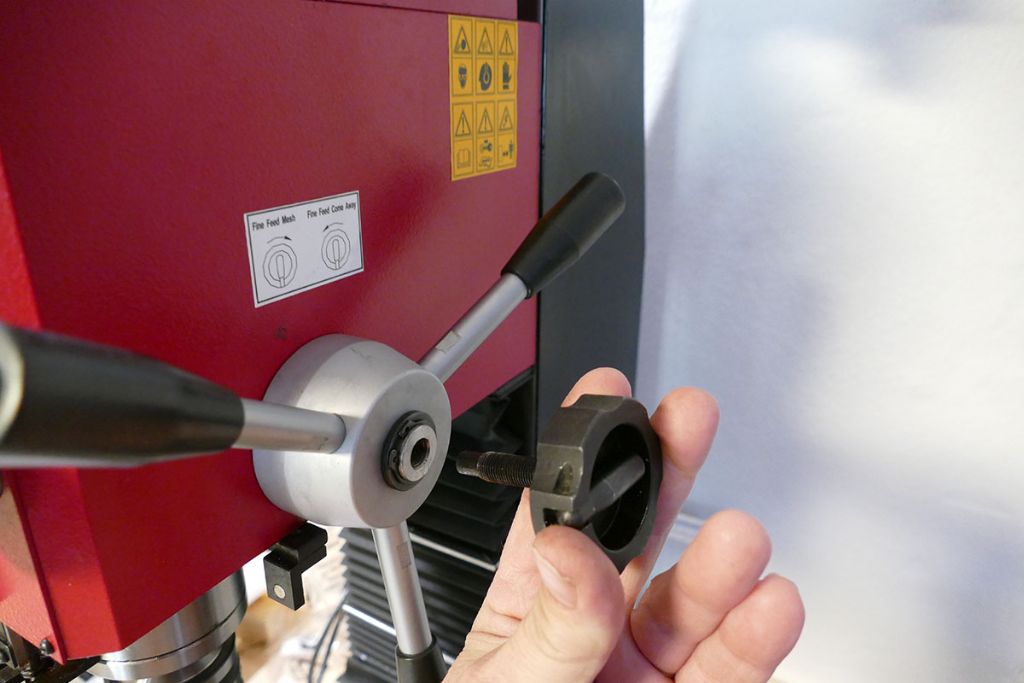

I got at brand new Sieg SX2.7L. The fine feed will not disengage, This gives a lot of resistance when trying to drill. Tried to remove the handle for engaging the fine feed, Any idea will be helpfull,

Have you swung the small handle out to give you suitable leverage to undo the fine feed knob, you may not be able to undo it just using the handwheel.
Also check that the quill lock on the left hand side of the head is not in the "locked" position.
One other thing that can make the quill sticky is the slide for the quill DRO where it attaches to the bracket on the quill, when the nuts are tightened they can throw it off line and it binds. A washer under each nut helps to solve this.

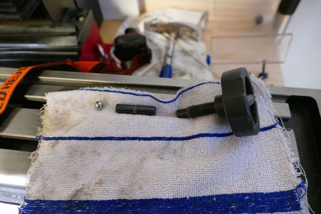

I can remowe the handle for locking and the fine feed is still locked together with the large handles
When i insert a magnetic screwdriver the pin and a 8 mm ball comes out.
If i insert all parts again and tightens both fine feed and large handles becomes very hard to move.

Just been talking to Arceurotrade. They have been very helpfull. I got instructions to remove the fine feed and lubricate it. The machine is OK but for anyone else having the same problems. The machine just need breaking in. I also got the SX2p from ARC - that machine is more loose from start.

If one sees this exploaded parts diagram, the issue was relating to 'the fit' of part 16 onto shaft 17 which is a little tight.
