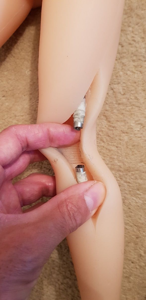

Hi All,
First of all, I'm a complete none metal working modeller. Metal work at school was never my strong point! So I'm not sure if I'm allowed to be here or ask advice, so I apologise in advance if I've broken any rules.
Anyway, I was wondering if anyone could help me with a problem I have fixing a Japanese 1/3 scale anime figure.
The doll is a high quality 66cm silicone model with a metal skeleton. It can be posed in any position, and in order to do this the skeleton has bendable joints at the correct locations with stiff stainless steel 'bones'.
The joints however are made of bendable metal which over time has become weak. One knee joint has broken and the other is close to doing so.
I don't want to replace these joints with the same bendable metal only to break again in a few months. For the same reasons, I'm not wanting to use plastic either. So, I was wondering if a ball and socket type joint is available that is tight enough for the figure to free stand, but be bendable enough to be able to pose the the doll?
I've looked around the web and found ball and socket joints, and universal joints, but they are too large for my requirements, and have too much range of movement. I need a joint that behaves just like a human knee joint with a 160 or so degree of bend, with no side to side movement.
The joint would also need to be 8mm or so in diameter so that it could sleeve into the existing metal chin and thigh bone. As far as I can tell, this type of joint simply does not exist to buy, and I hoped that someone here could point me in the right direction to someone who might be able to make these for me?
Any helps appreciated!

This looks a good place to start, Jim **LINK**
https://www.animationtoolkit.co.uk/6mm-double-pro-ball-joint/

I think Michaels idea would work, the only problem being that the thigh and chin "bones" are both solid metal, so the screw rod of that kit wouldn't be able to screw into them.
I think I would either have to cut further up/down the leg to see if I could see if it is hollow tube further in, or I'd have to find a hollow sleeve to go over both pieces? To be honest I'm not happy having to expose any more of the skeleton as the silicone will probably be a bugger to try and re-seam later on. :s

James Reid 114/03/2019 21:59:18
5 forum posts
1 photos
Hi Maurice,
I'll just smile blankly, nod and stare straight ahead looking like I know exactly what you're talkng about! Thank's for revisiting this post, I'm still considering contacting a company Michael suggested as up to now it seems the way to go. I'm back at work this week so I've got no chance to sort this out at the moment.
However, your idea sound's amazingly like a proper knee joint in theory...I think?!! But would it scale down to the tiny size needed, while still being strong enough to support around 4kgs in weight?
This is the space that it would have to go into! The two metal rods are 8mm in diameter and the space between them is about 35mm. I couldn't remove the old (bendable) wire as it's been crimped in I guess some way further up the leg and I don't want to cut any more silicone for fear of never getting it back to shape. So if the joint was to fit it would have to fit over the metal rods.
If you do experiment I'd be very interested in seeing the results..... even if I don't understand how you did it!!
Thanks again, Jim.
