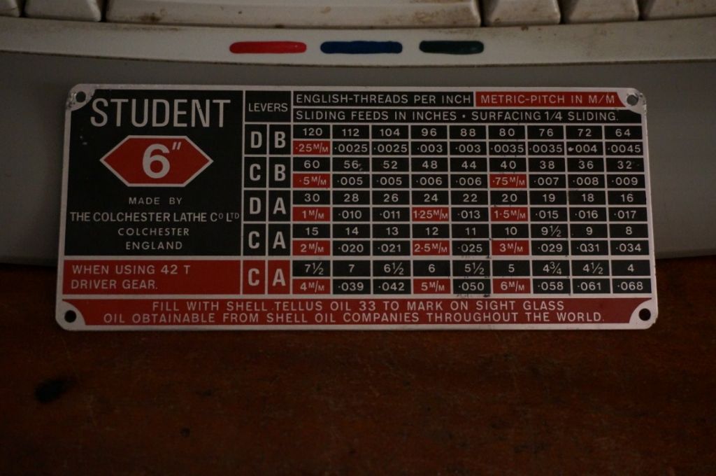

How do I cut a 1.75mm or 3.5mm thread on my imperial colchester student
The thread plate lists 1.25...1.5...2....2.5...3...4...5.....6..
So how do i calculate a different gear train.... Which i dont have any extra gears for yet
If for example i divide 25.4 (1 inch)by 7.5 (tpi) i get 3.3866 where the thread plate lists that setting as 4mm.
is that the metric/ imperial lever that adjusts that?

Right I'm still confused about what to do
whilst it has a imperial leadscrew theres a lever on the gearbox to switch between metraic and imperial threads
this is my gearbox table
As standard the gearbox is driven by a 21 tooth or a 42 tooth driving a 35 tooth on the gearbox input.
on my lathe i use timing belts so to keep the same ratio its a 24 or 48 driving a 40.
Can anyone with better maths brains tell me what gears i need or new pulleys to acheive a 1.75 and 3.5 pitch screw

You would need to change the 42T to a 49 and select the 1.5mm setting for 1.75pitch and the 3.0mm setting for 3.5 pitch
1.5 x 49/42 = 1.15
Edited By JasonB on 02/11/2018 13:04:52

30T on the gearbox driven by the 42T should do the same thing and may be easier to source
A 56T pulley driving your 40T pully will also work

your sum above should be presumably
1.5 x 49/42 = 1.75
not 1.15 ?
As its easier to source pulleys than gears what size should the driven one be as i cant fit anything larger than a 48 tooth as the mainshaft is close

yes should have read 1.75, Think my fingers were thinking about the 1.16666666 increase in gear box speed you needed.
Won't work keeping the 48T pully unless you can find a 34.286T pully to go with it. Other pully combinations are 42-30 same as the gear option or 49-35 if you can squeeze it in. You need any combination that gives 1.4

Another combination that gives you the multiplier of 1.4 that Jason speaks of is 35 driver--25 driven.

so basically I need to set the gearbox to say 1.5mm or 3mm and apply a 1.4 increase to the gear train or pulley ratios

When I do the calculations again, using a 42 driver and the gearbox settings you will be using, I find that you will need a 36 gear on the gearbox
The sum is 42/36 x 1.5 = 1.75 mm and likewise 42/36 x 3.0 = 3.5 mm

No you need a 1.16666666 increase to the existing which gives a ratio of 1.4, the old ratio from your belts or the gears was 1.2
